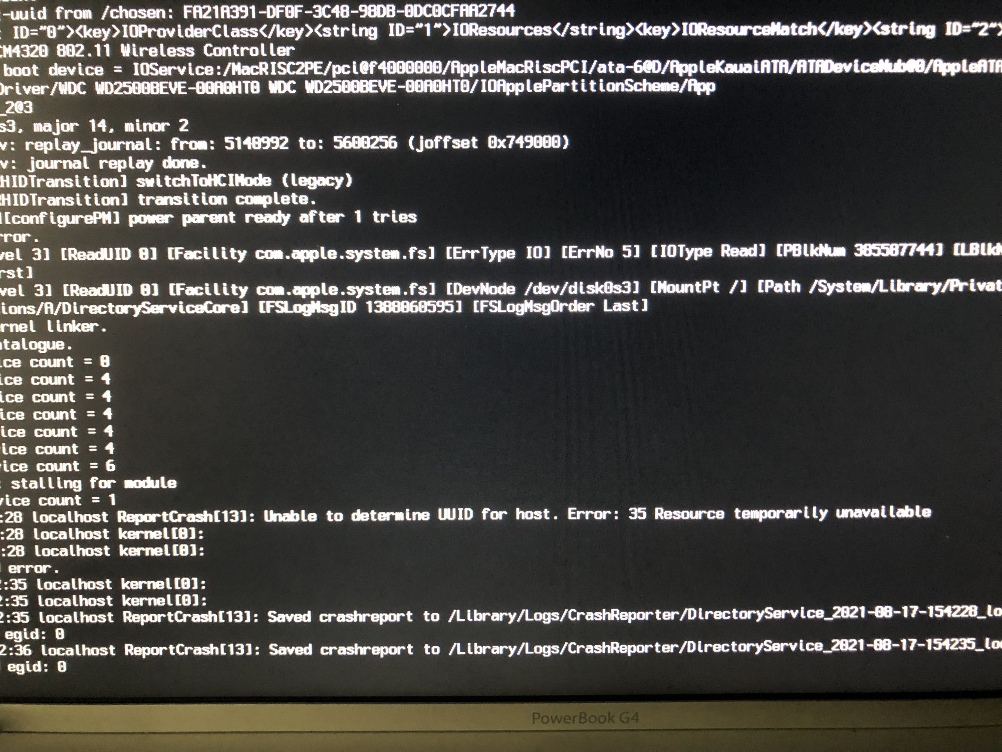

Hey I tried to do the repair of the disk utility but it failed. Then I startet my powerbook with the secure boot and I got these crash reports
Every other crash reports follow this report 35
Mostly its says Error 35 : Resource temporarily unavailable
help please
I see some IO errors on the picture than you posted. if disk utility is not able to repair the partition or the hard drive, you'll have to get a new drive and perform a clean install. because that hard drive has a lot of bad sectors and some critical files are not working anymore 🙁
