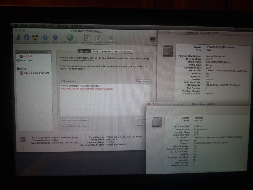

I do notice that disk utilty shows my disk, but the partition looks weird, and cant be repaired or verified due to Unrecognized file system. I'm attaching a picture.

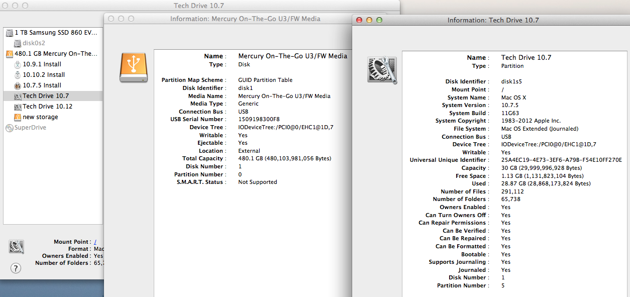

Interesting...
I see the partition map is MBR. That should not be bootable...surprised it works. The default/recommended for boot drives is GUID.
I booted up an old OS (10.7) on external to verify because—strangely—in later OSes Disk Utility does not specify partition map info. Yep, as I remembered, GUID and HFS+ (extended) Journaled:
If you can reformat the HD, that's where I would start. Or, if you have another drive to format and test with would be good too.
Replacing the SATA cable would not hurt as they are pretty cheap (at least here in the US).
