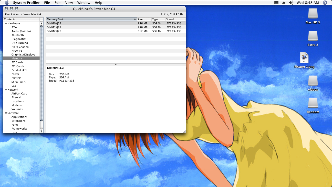

I have been using it for awhile now but now I noticed the center memory slot is empty but there is a stick in there. I thought it was working fine when I first got it out of storage. Would it be the board or the memory stick or even Tiger? I was thinking of reinstalling Tiger and make it seem fresh again on a new HD but now I want to sort the memory stick issue out.

so one 512mb works again but in the good slot. the other one gives a beep in the good slot. will use a can or something on the others.
so I used a can of air and I've tested one of the slots which is now working so now I have 768mb 😀.
but even if the other slot is working I can't figure out my last 512mb stick. I mean when I put in that one slot that I thought was the only one working it beeped and wouldn't boot. So does that mean the stick is bad? like this but PC1333
Well that is weird I got 1 GB now but the config is 512mbx2 not 256mbx2 like what shows here
