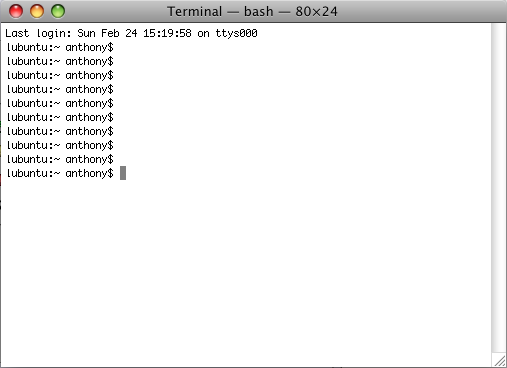

Today I did a fresh install of leopard onto my G4. Last night I put the Lubuntu live CD into my computer, booted, and then decided not to install it. Now after the fresh install, my terminal shows "lubuntu"
How do I get rid of this?

Mine turns into a BlackBerry when I connect it to the network at work. I'd imagine that just rebooting your router would fix it; I doubt that you need to mess with the firmware.
My router doesn't reset the DCHP table when rebooting. I just need to hit "restore defaults" in the firmware.
Thanks for the help!
