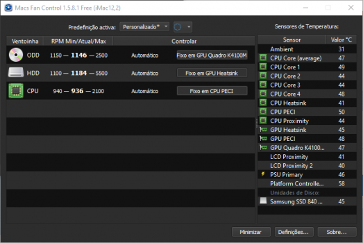

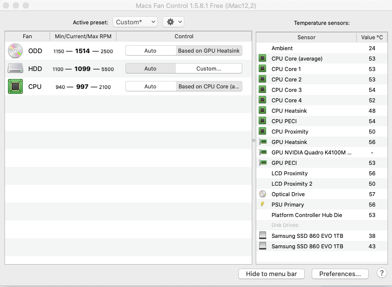

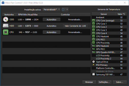

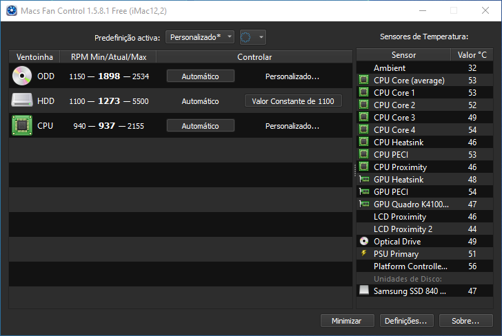

Hi all!

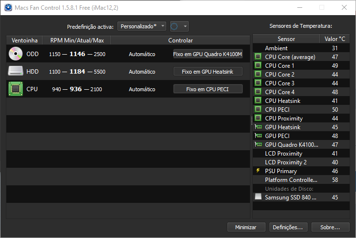

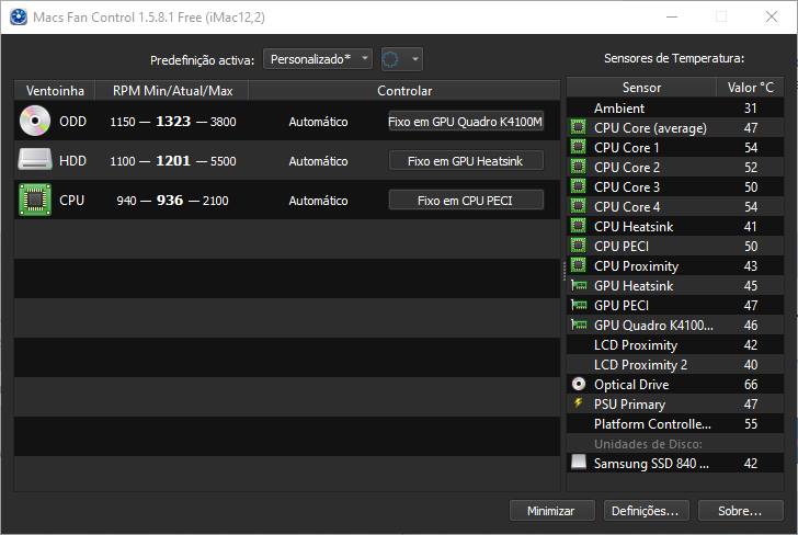

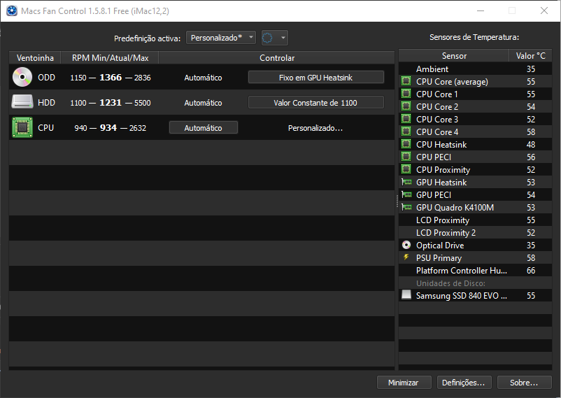

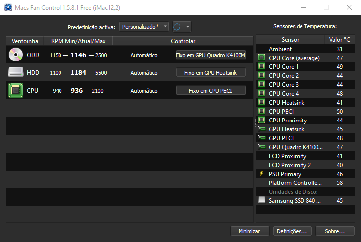

My signature setup (with K4100m) is acting weird about fan speeds.
Each time I turn on my system it shows different maximum rpm speeds for ODD and CPU fans.
With K4100m GPU I really need maximum rpm from ODD fan, but sometimes it shows 3800rpm (that is OK) but sometimes it shows only 2500 etc
I have tried "powermetrics" but it shows "unable to get smc values". Reseting SMC and NVRAM doesn't made any difference too.
I really don't know what to do, but my target is to maximize ODD fan speed to properly cool down my new GPU.
Other info: I use OpenCore without fakesmc (but there is no difference with it), hardware "swap" thermal sensors (odd and gpu heatsink).
Anybody is getting this same behaviour?

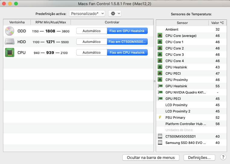

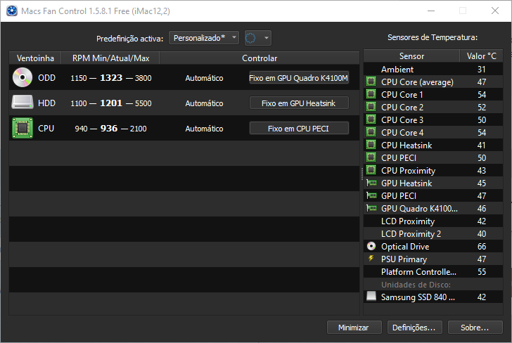

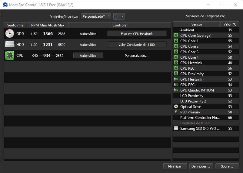

I have some news about this issue...
It's apparently related with "ODD" and "GPU Heatsink" sensors.
I guess that when iMac turns on, SMC reads all sensors and store a value for maximum RPM for each fan.
I'm using this solution: https://forums.macrumors.com/threads/2011-imac-graphics-card-upgrade.1596614/post-29251720
Yesterday I decided to disconnect ODD temp sensor (actually GPU heatsink sensor) and imediately iMac began to set maximum ODD fan speed to 3800rpm (Catalina and Win10). When I plug it back again, random values come back too.
I don't know how this is related with maximum rpm for CPU fan, but as soon I removed ODD sensor plug, CPU fan begins to show always maximum 2100rpm again.
I did several restarts and it's ok. ODD fan maximum possible speed is now 3800rpm and regulated by "GPU Heatsink" sensor with modifications above.

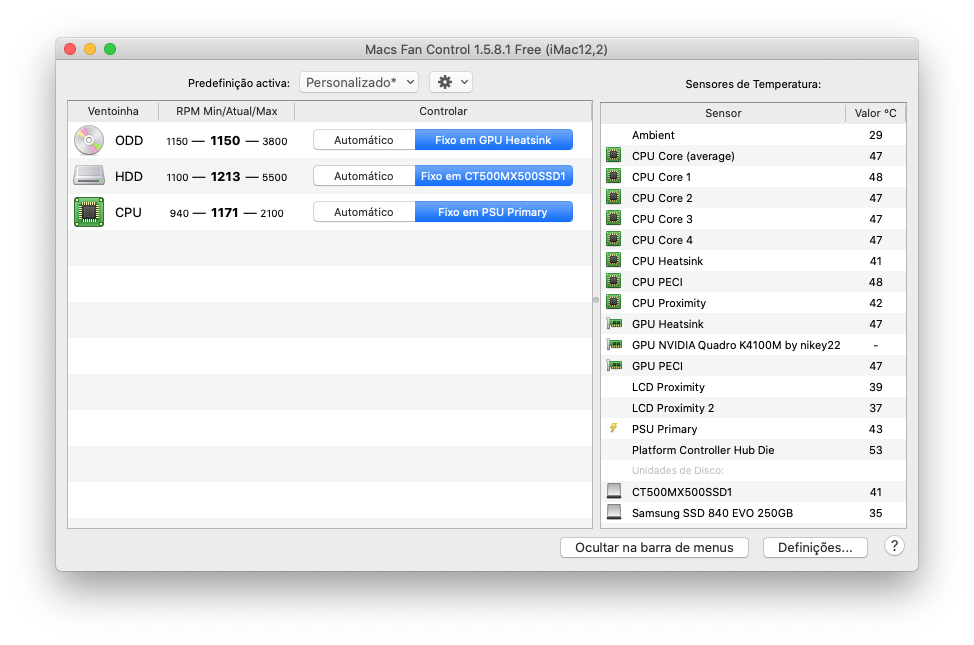

I've tested with and without OC and found the same behavior.
The only way I found to achieve 3800rpm was disconnecting ODD sensor plug from motherboard.
I think there is no difference if you use ODD sensor or heatsink sensor since it's working well.

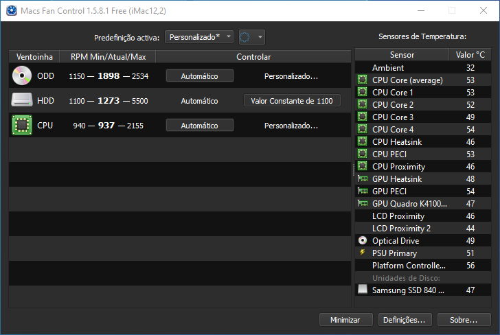

I'm using "PSU Primary sensor" to control CPU fan. Automatic uses very low speed and my PSU remains burning near 60 degrees. With this setup PSU is always between 40/45°C. I really don't recommend this settings if you use CPU intensive apps.
ODD Fan - GPU Heatsink (50°C/70°C)
HDD Fan - SSD sensor (55°C/75°C)
CPU Fan - Psu Primary (40°C/50°)
Screenshot of my system with only internet browsing.
