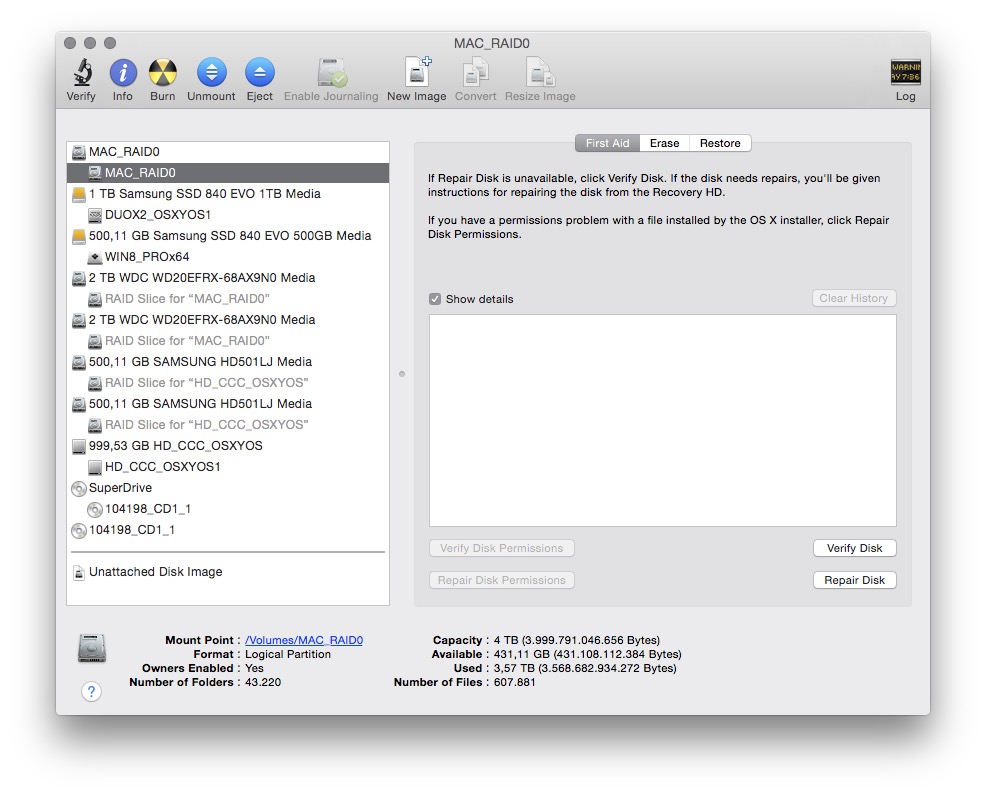

the OP is right (depends on the version of OS X used). AFAIR with Mountain Lion I never was able to run "Repair Disk Permissions" on my RAID-0 using Disk Utility. it worked if I did it using the terminal though... I don't remember the command exactly but it was something like diskutil repairPermissions.
Repair permissions on a data-only drive? really?
With my old Lion RAID0 of the system (2x SSD) Disk Utiity does not even work! 😡
My Apple Software RAID0 (2x2TB) can't be repaired too. But because it's a data-only-drive I don't have to. 😉
Perhaps someone CAN explain why a software RAID0 can't be repaired anyway...

The "Repair Permissions" function in Disk Utility only repairs permissions on OS X system files. "Repair Permissions" does not work on any disk that does not have OS X installed on it. This has nothing to do with whether or not the volume is a RAID 0.
Again, this is because OS X isn't installed on that array. I have a test system that boots to OS X on a RAID 0, and yes, repair permissions works perfectly fine on that volume.

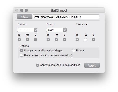

OP, if you have groups, owners and permissions issues you can use BatChmod to fix them.
THNX both for explaining and solution for repair permissions on a data-ony software RAID0 with BatChmod!

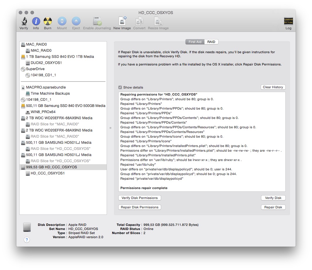

My other internal RAID0 array which is bootable (Carbon Copy Cloner) can use "repair permissions" on OSX 10.10.1.
So the fact it has OSX installed on it seems to be the factor.
