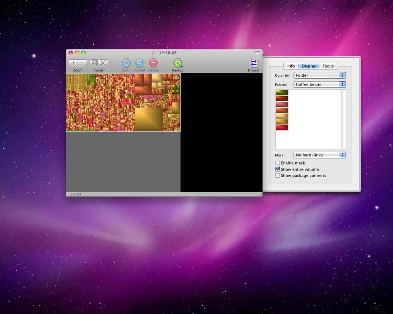

Just ran GrandPerspective and it shows that the size of scanned files is about 270gb and the size of "Miscellaneous used space" is also about 270gb.
What is this "Miscellaneous used space"?

In looking at the Grandperspective scan, I can see via the entire volume view the 1TB drive split into nearly three equal pieces -- the files I expect to be there, broken down into different colors, a large black square of free space, and a gray space of "miscellaneous used space." (I've attached a screenshot, I think).

Upon further digging, what I have appears to be exactly what is described in the article MacTech68 linked (thanks!) -- a hidden Volume that, if I understand it, was created on my 1tb drive when I did not properly eject/dismount an external backup.
I've tried to trash the volume in Omnidiskwweeper, but it somehow rebuilds itself. Working on getting this done now.
