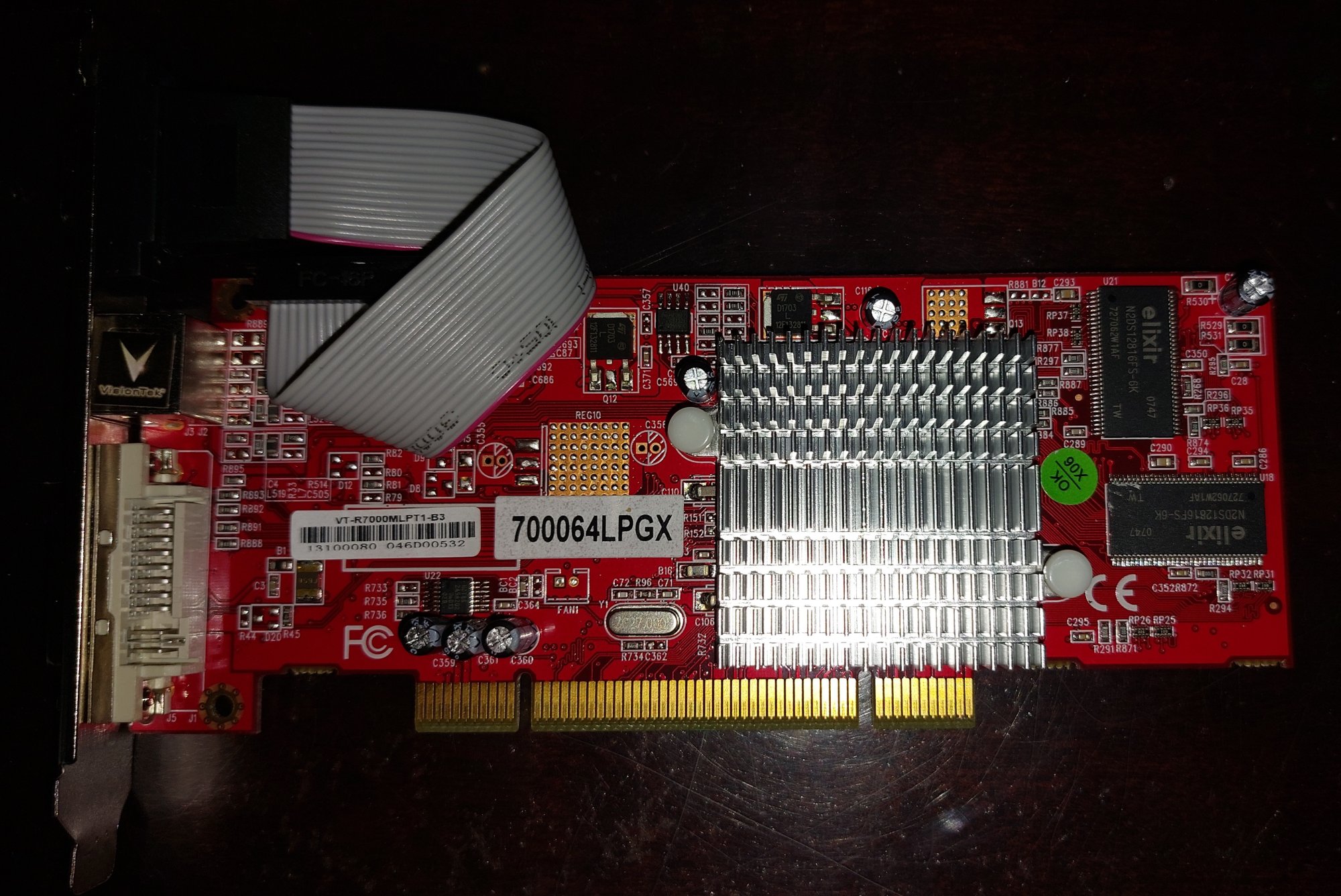

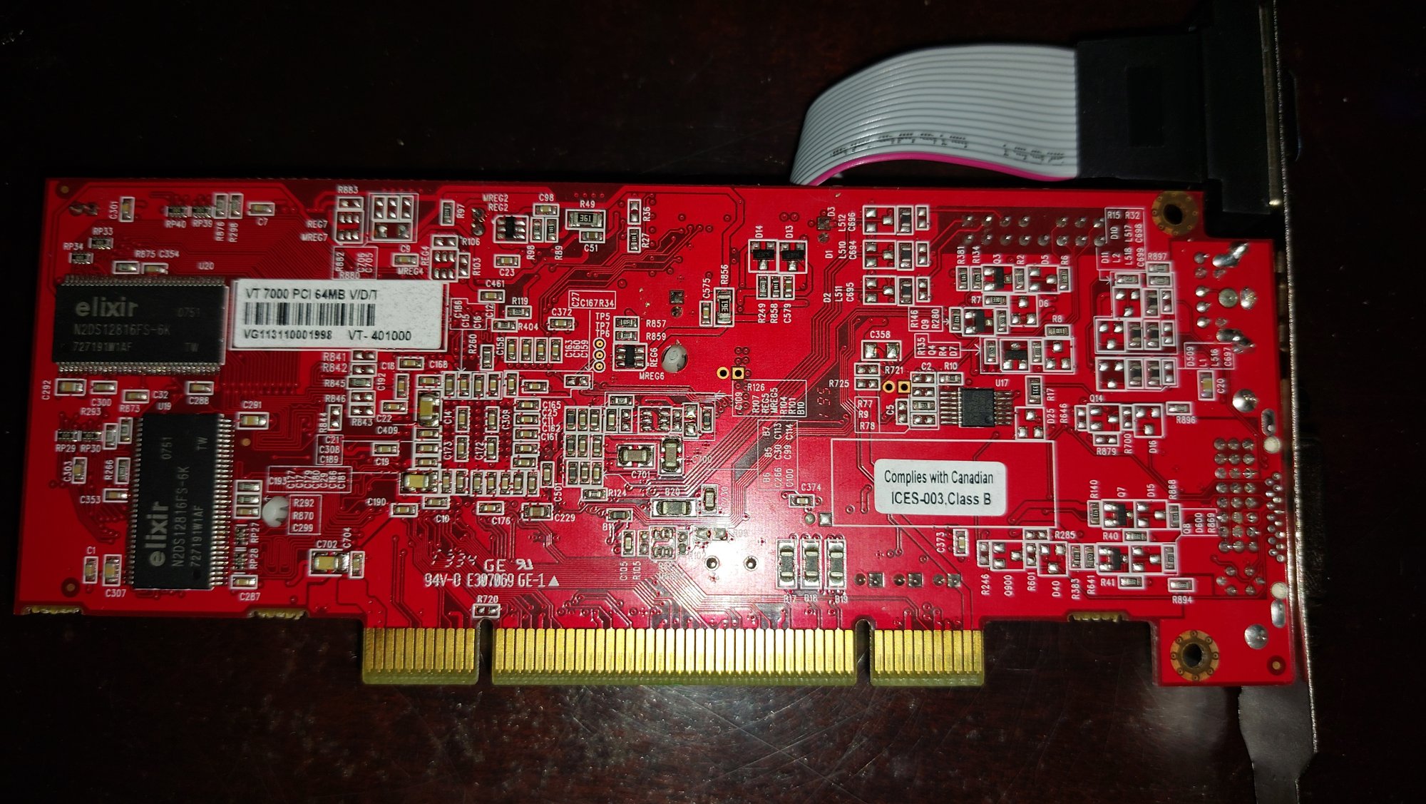

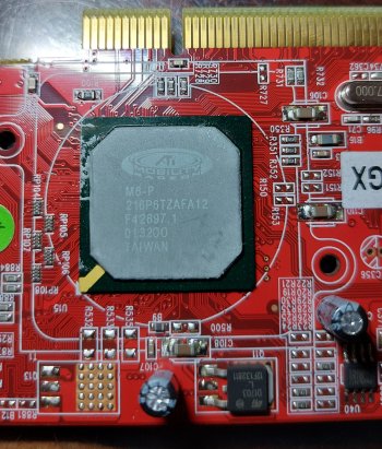

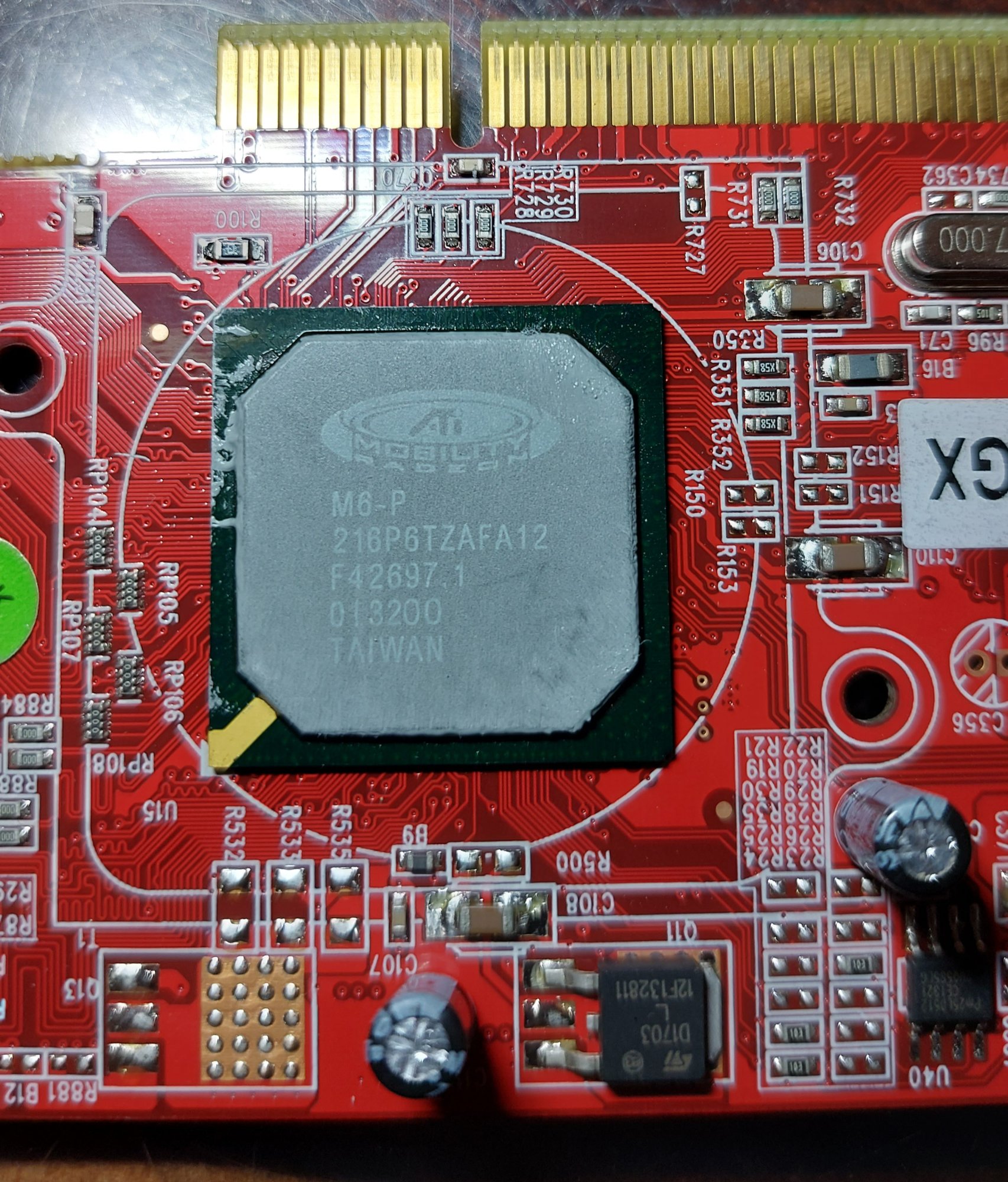

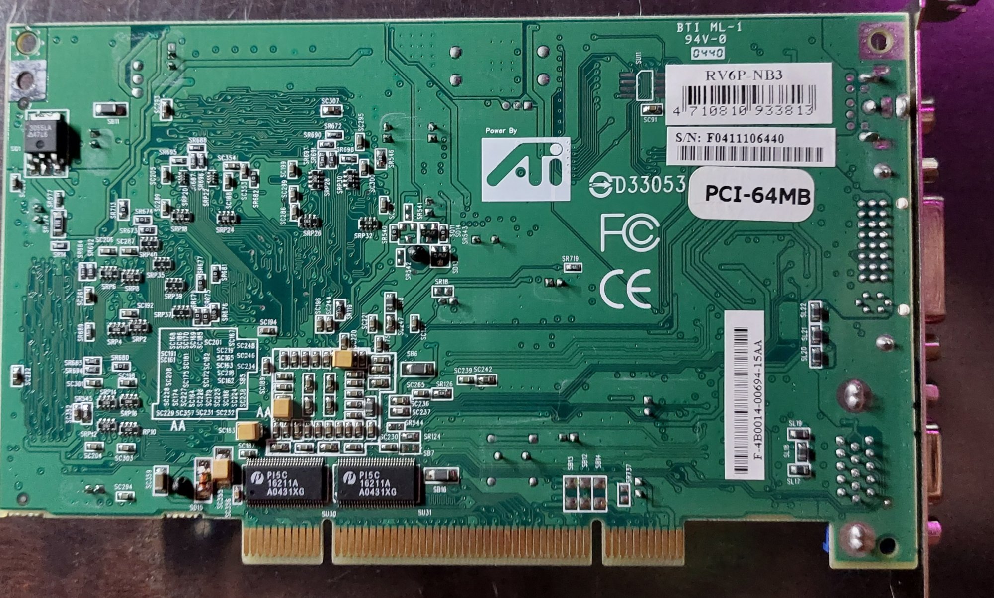

I ordered a 64mb pci Radeon 7000 to flash for my B&W G3. Unfortunately it doesn't work at all. I tested it in multiple PCs and never got any video and one PC wouldn't boot with it installed. While I was inspecting it to see if there was any visible damage I noticed the chipset is actually a mobility Radeon m6, the mobile version of the Radeon 7000. Assuming the seller sends me a replacement is it even possible to flash this with the Mac ROM or does the mobility Radeon require a different ROM.

Are there any model numbers on the card? Who made it? What outputs does it have?
Vampower made AGP and PCI cards using the Mobility Radeon (M6, VGA/DVI+LVDS) and Mobility Radeon 7500 (M7, DVI+LVDS). I actually have a 7500 version on the way. Vampower cards have a Molex power connector, presumably to power LCDs connected to the LVDS output.
As for the ROM, the Mobility may be clocked lower than the desktop variant (143 vs. 167 MHz) and/or have a different memory configuration (size, clock, type, bus width) as well as output layout. And it’s missing some features like T&L so I wouldn’t bet on a desktop ROM working “as-is.”
I suppose you’d have to put the card in a Windows system and query core and memory clocks, dump the BIOS etc., then see if you can find a ROM that matches or have a go at modifying an existing one to match.

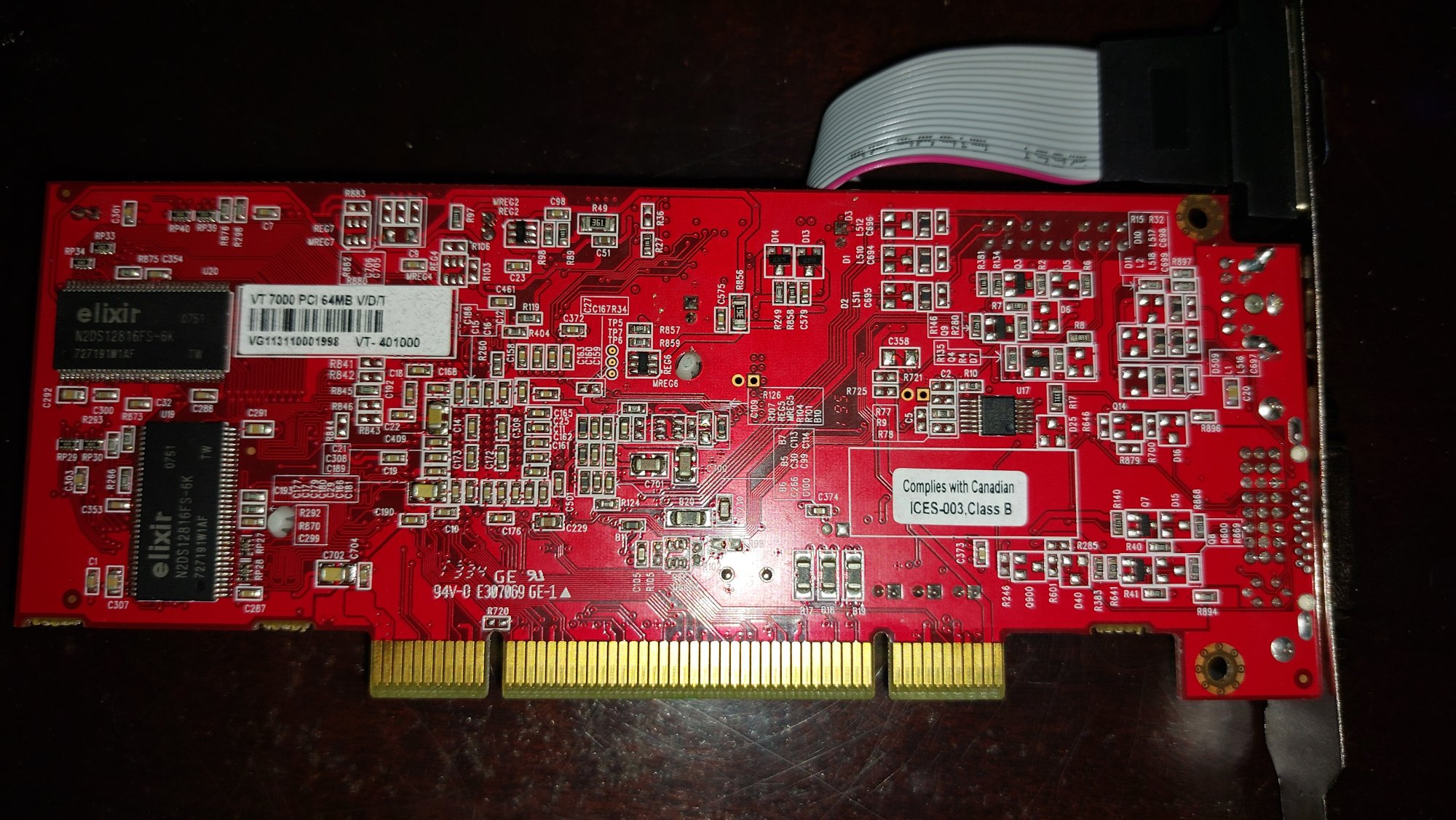

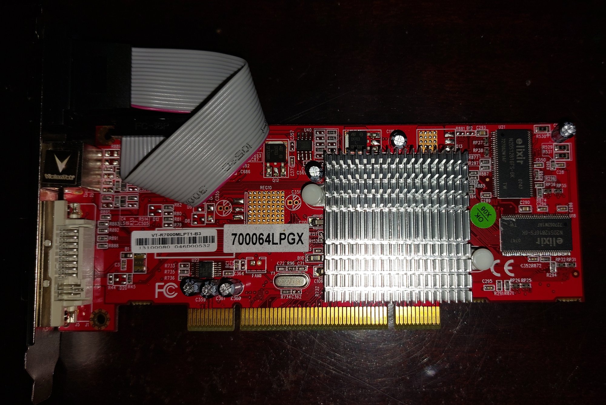

This is the card I got. I noticed visiontek called it a "rad7k", probably a really scammy way of indicating it's not actually a real Radeon 7000. I have not heard back from the seller yet. If they refund me and let me keep the card I might try replacing the 7 electrolytic capacitors. They're all capxon which I've heard are among the worst of the worst. if I can get it working it might be decent in a PC if it can't be flashed for Mac.

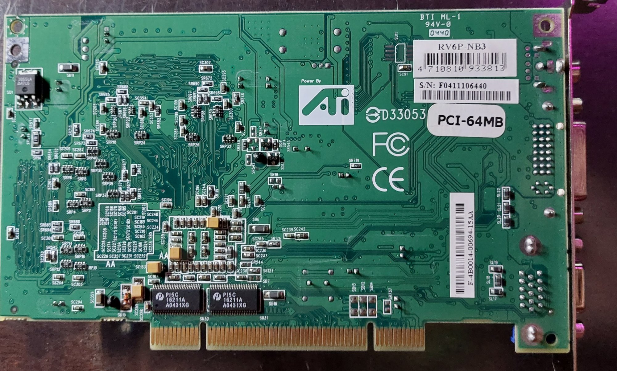

I ordered a different Radeon 7000 which is almost identical to the green pcb reference design with the flash chip isolated on its own area at the top of the board. The only difference is it has a composite out port in place of the normal s-video. I hope that one works with a standard ROM.

The seller refunded me on the card with the Radeon m6. I poked around with a multimeter and found one of those capxon caps was acting odd. I replaced it and the card now works. It has a clock speed and memory clock speed of 163 I think. I will have to order good caps to replace the rest of them.

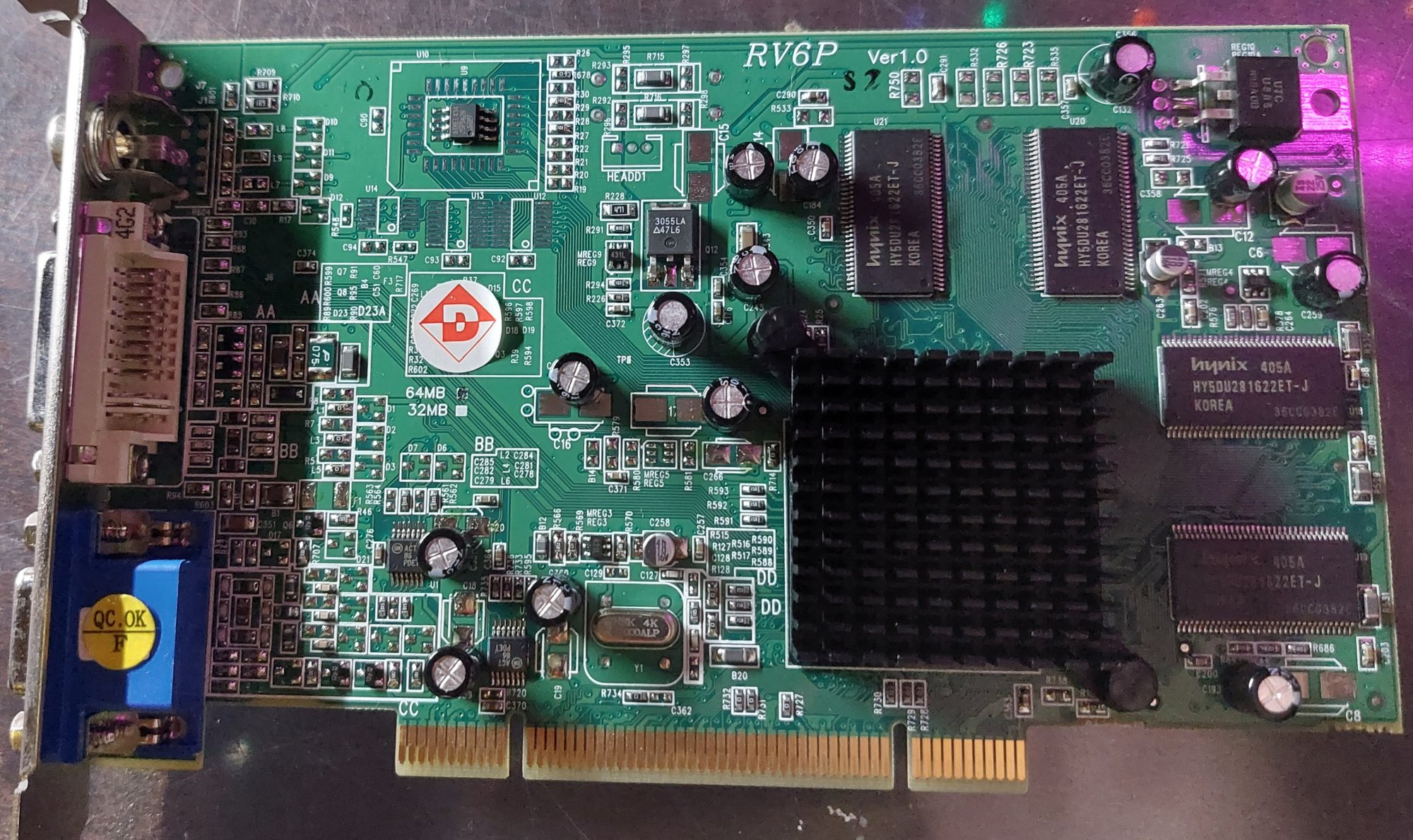

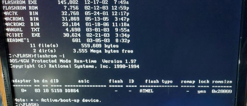

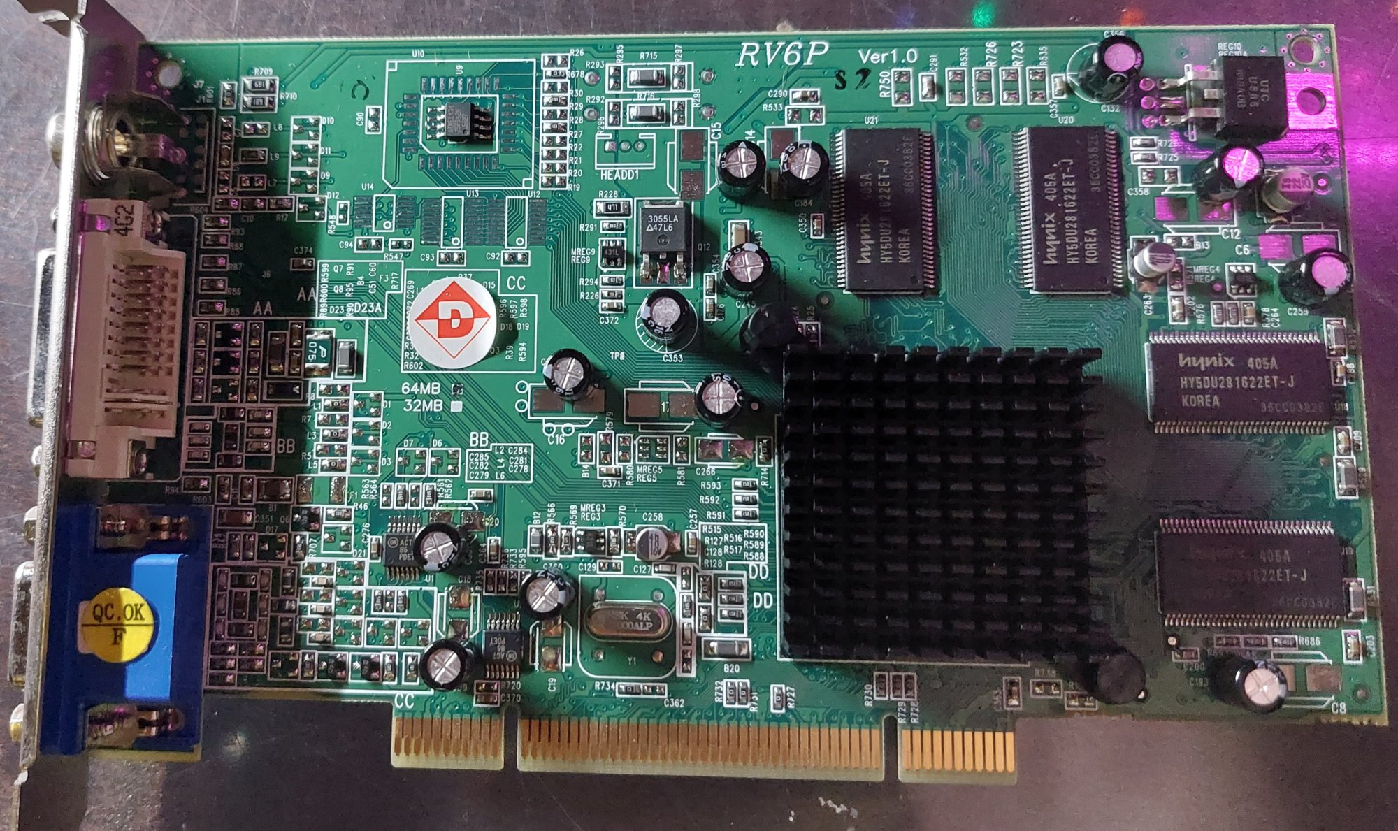

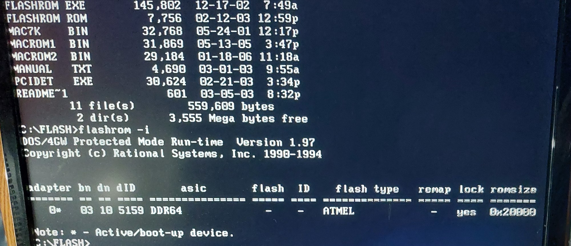

The other card I ordered came in. It's a diamond stealth s60 Radeon 7000. This one works and supposedly has a 150mhz CPU and memory clock speed but I can't get gpuz to read it properly. I tried to flash it with graphiccellerator on the G3 but that failed with a generic error. I put it back in the PC and ran a couple versions of atiflash. They report the ROM is locked.
The one with the Radeon m6 chip is faster in a quick benchmark I ran.
I'm kind of stuck here. I'd be willing to use either card but one card probably can't be used with the regular Mac Radeon 7000 firmware and the other has the ROM chip locked and both would probably need the clock speeds lowered from 183 to work. The flash chip on the locked diamond s60 is an atmel 25f512. I could probably order a larger flash chip and have digikey program it but I would still need to lower the clock speed on the ROM before I send the ROM in and I still have no idea how to do that or if the Mac firmware even works with this card.
The attached pictures are of the 2nd card, the diamond s60 with the locked ROM.

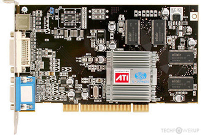

I can only suggest you wait for the venerable Sapphire Radeon 7000 to appear. That was to the go-to for flashing for Mac and they are hardly scarce. Most if, not all are 64MB cards. The other alternative is a Sun RV100. Those are actually the reference design for the Apple Radeon 7000 card flashed for Sun but most will probably have only 32MB of VRAM. The Sapphire will be cheaper to buy.
