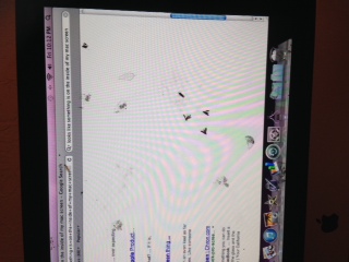

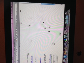

A friend just gifted me with an iMac that she could no longer use, and everything is working beautifully except that there is a display on the screen that looks like there are dead bugs on the screen. Can someone please, please tell me how to get rid of this?

Well, the picture is sideways, but you get the idea.
I'm getting desperate to figure out what this is and how to get rid of it. It looks like someone took off the screen and put it back with dirt and bugs squished onto it.

Looks like you have dead bugs on the screen (!)
There's air space between the glass (which is the outside surface of your screen) and the actual LCD screen - room enough for bugs to crawl in and die. There are various places where they could crawl in.
You can remove the front glass panel, and carefully clean the enclosed surfaces, which should get rid of those dead critters!
Some instructions here: http://www.ifixit.com/Guide/Installing+iMac+Intel+27-Inch+EMC+2309+and+2374+Glass+Panel/1631
I use isopropyl alcohol to clean the inside glass surface, and a glass cleaner, such as Windex (with vinegar - not Ammonia (check the label)) to clean the real surface of the LCD panel.
Check carefully for any smears/streaks before you place the outside glass back into place. I always caution folks who do this display glass to _not_ move around too much, so that dust does not stir onto the inside surfaces.
And (as WilliamG already said) you should be bug-free!
BTW - the suction cups don't have to be a lot of money, just something that will hang on to clean glass so you can lift the glass up and out. You can often find something that works at a kitchen accessory shop. I found suction cups that are sold to hold towels or pot holders that work for your purpose just fine.
One final point - when the glass is removed, you'll see that it's very thin, and untempered, which makes it quite fragile - so handle carefully - don't get in a hurry when removing or replacing the glass. good luck!
Let us know if that fixes it for you…
And, one more - don't cover any holes to prevent future "entrance" as you could block needed cooling for your iMac!

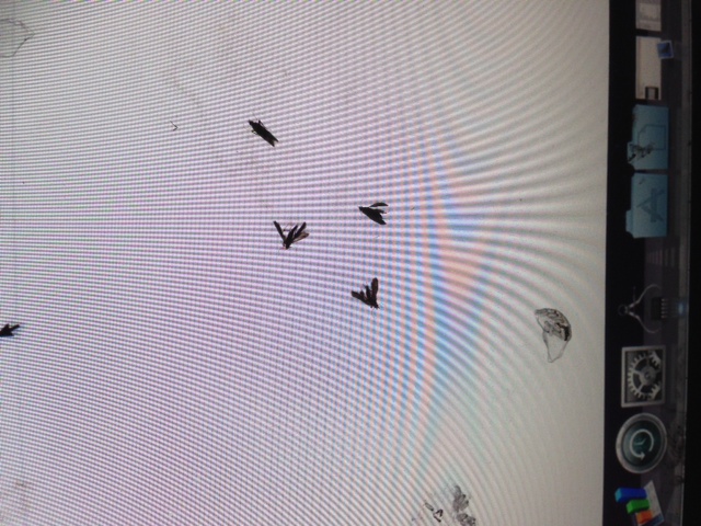

My son came to visit and we took the outer screen off my imac. The underside and the outer side of the LCD display were pristine. My son took out some screws and looked under the LCD and it was clean also. We turned it on and sure enough, it still looks like bugs, but *only* inside the LCD display. How is that possible? There were no dead bug bodies anywhere and he gently shook the computer and nothing came out-it was clean. How could bugs get into the apparently sealed LCD and nowhere else? Are you sure this isn't some kind of malware?
Do these bugs appear from the moment you power on the machine? Are they visible on the grey screen with the Apple logo?
Are there any marks on the LCD panel itself? With the glass panel removed and the power off if you look at the surface of the panel do you see any physical marks? You could also try pointing a flashlight at the affected area.
Are the marks in exactly the same pattern and location every time?
Something is sketchy here.
I could maybe understand small bugs (fruit flys, etc), but those are some very large bugs to be crawling into a display.
Something tells me this is some software running, overlaying the bug image. You even say in your title it is a "display overlay", why did you say it that way?

If there's bugs sandwiched between the layers of the actual LCD display itself, then your best bet is to source a new/used replacement LCD display off eBay.
Dismantling the layers of the LCD in the iMac is possible, but they're very, very delicate. I've done it once on a 2010 model to remove debris the size of a pixel. Not sure about bugs and bug guts...
They can get in. The screen may be sealed, but it's not air tight. They'll find a way in. It's uncommon but it happens. If the machine is out of warranty, maybe you can find someone who can replace the screen on the cheap. But either way, you'll need a new display. The bugs are physically between the LCD panel and the backlight.

I don't think it's some software displaying the bugs, if they were images then they would also have pixels on their bodies and the rainbow rays would be on them too through the camera however they're there are no pixels or rainbow lines on them.

Yes, they show up during the boot up. I'm puzzled since everything else inside the computer was absolutely clean.

The bugs got into the actual LCD between the crystal and the back light. I just had the exact same problem only my issues was not bugs but dirt. You have to take the display apart. Its not easy. You have to cut the metal tape and remove the frame and the crystal comes right up, then you clean it, lay it back down and done, new screen. These things are supposed to be sealed but they really aren't around the corners and such. Good luck. Another solution is to just buy a new screen, ebay $200.
