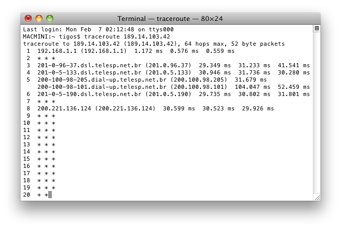

Look, i play minecraft in my macmini. So, sometimes i cant reach the server.
I run traceroute in terminal and they fail at some hop.

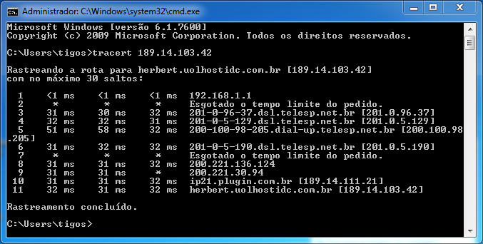

But, when i try traceroute in Win7 (dual boot) they reaches the server!

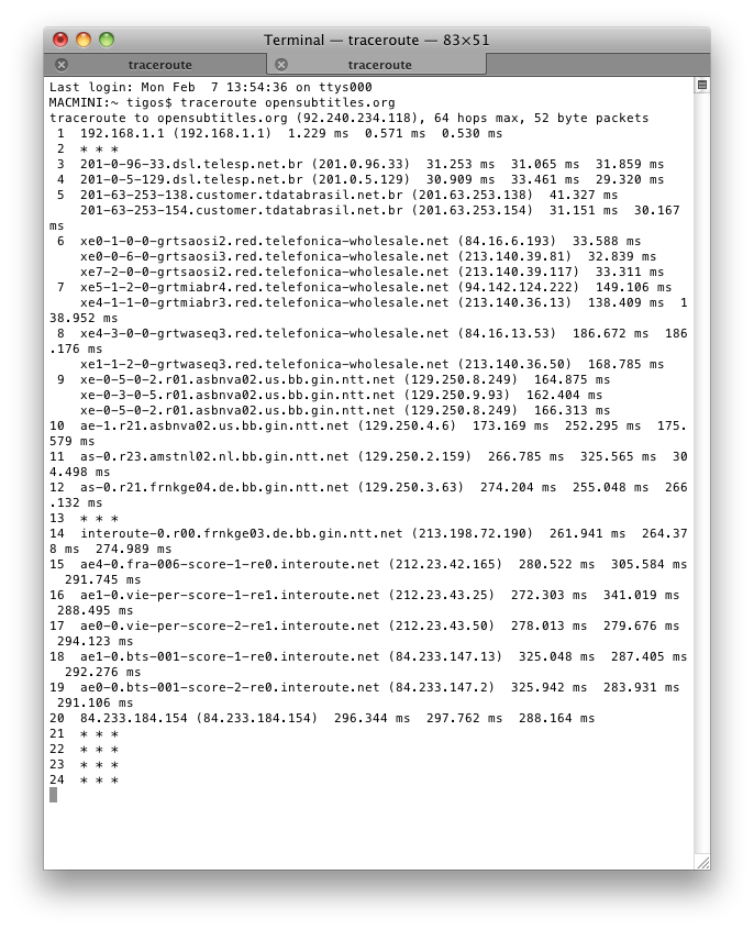

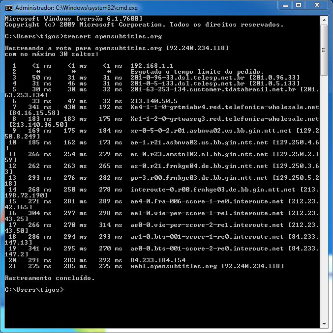

Same happen to www.opensubtitiles.org too.
I already tested with my two macs and (both clean install and updated) and they show same results: in osx my routes fail, but in windows they works.
Anyone know something about it? it's a kind of bug? (new bug perhaps?)
(This mincraft server are brazilian)

Windows tracert uses ICMP (ping). Unix traceroute uses UDP. If something is filtering UDP packets, the Window tracert will work when a Unix traceroute will not.

I did not mean to imply that the possible filter was under your control. The eighth host in your traceroute might be the culprit.
In any case, try:
traceroute -P icmp address-of-your-server
A.
Yeah... i try traceroute -I IP and works... but how make OSX use ICMP instead UDP?!
These programs like aren't using ICMP for connectivity, except for a ping to determine latency. All connections will be either TCP (likely) or UDP.
Therefore, testing a traceroute is not really valid. You want to test the TCP connectivity to the host in question.
