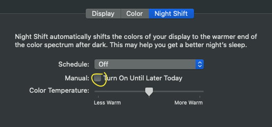

Update: nevermind, it's due to night shift (weirdly enough I don't think I turned it own). It turns out "Manual:" needs to be unchecked. This solves my issue. (I now use f.lux for night color)

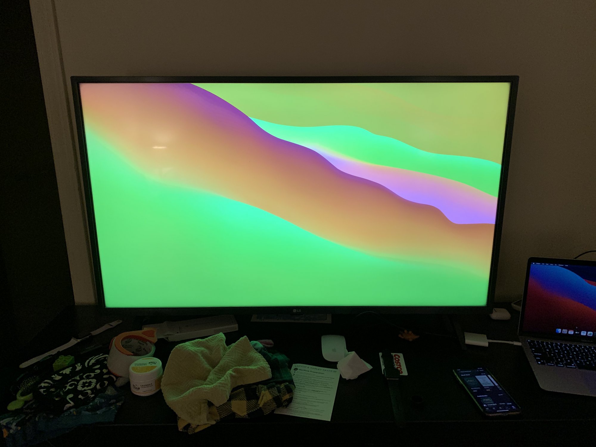

I have an issue with an M1 Air where I leave HDMI cable plugged into the official Apple adapter. At some point after not using it for awhile, I come back and now my external monitor is heavily tinted yellow. Unplugged the HDMI cable and reconnecting will fix it but is there a fix to this?
Your comment pissed me off lol. You jinxed me. I replaced my i5 with an m1 and then tonight this happened.
