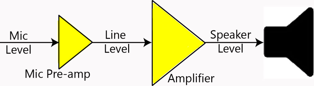

simply:
the headphone out is to high because of an additional amp
edit: add a backgroundlayer in the picture

I need to come by here more often. Indio, that makes perfect sense for the front jack (dark theme is ruining your kickass graphic) but that would mean that the jack in the back would not whistle ever and a different, subtler, whistling is there too. The only thing I have found that either makes it disappear or moves the sound to a frequency I cannot hear is to charge the speaker from either the laptop or the wall rather than the first open USB I find. Cheap headphones don't whistle but expensive ones, not powered but noise cancelling, do. Neither one of those things makes any sense. I get what you are saying (the graphic really helped, thanks) I just can't connect that to USB charging.
