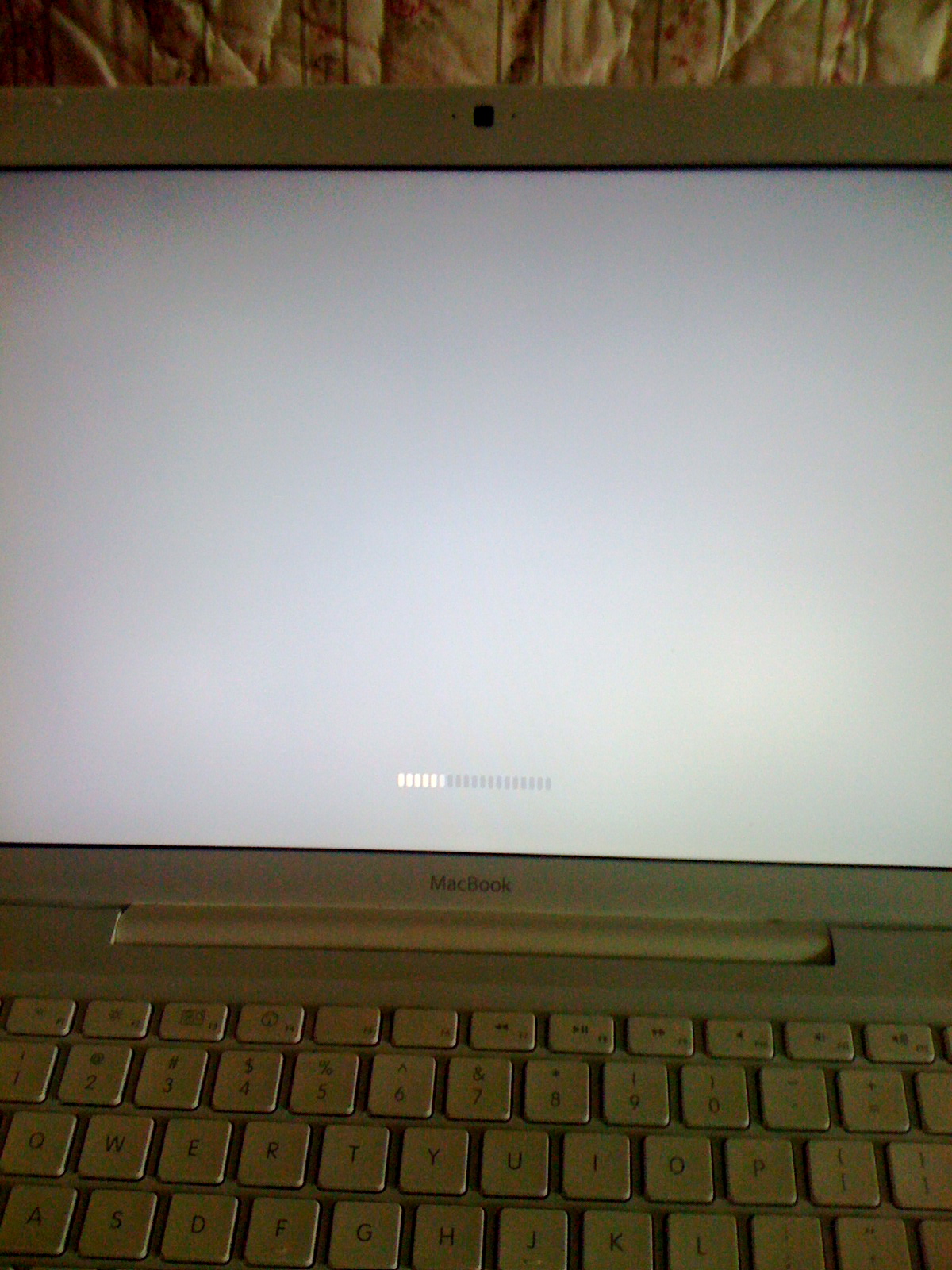

Hey guys, my white late-2007 MacBook recently had its logic board repaired, and ever since then, some weird things have been happening with it. The first and most annoying thing is that connecting my external display (HP w2338h) to use my MacBook in desktop mode simply does not work like it did before. I'll connect the display, make sure mirroring is turned on, shut the lid of my MacBook, but instead of going to sleep, my MacBook will just shut off. I'll disconnect the display and open the lid to turn it back on, and it then proceeds to show me the regular Apple boot screen...but with a status bar beneath it that I've never seen before. I've attached a picture of this.
All I really want to do is to use my MacBook normally with the external display...any ideas?? 😕 🙁

As for that bar, IIRC, that's the computer restoring from Hibernate mode. You'll get that when you calibrate the battery, and fully drain it beyond the point where the computer self-sleeps. Hibernate is where the MacBook stores your data to the HDD instead of keeping it in RAM, so it takes longer to restore your desktop and where you left off, hence the progress bar.
That isn't the "Safe Sleep" bar.
That shows a greyed-out image of your Mac OS X session before the power was lost.
I'm not sure what the bar that the OP is getting is though

You'd get that type of progress bar when you closed the lid on the older Macbooks/Pros, removed the battery, and replaced it.
