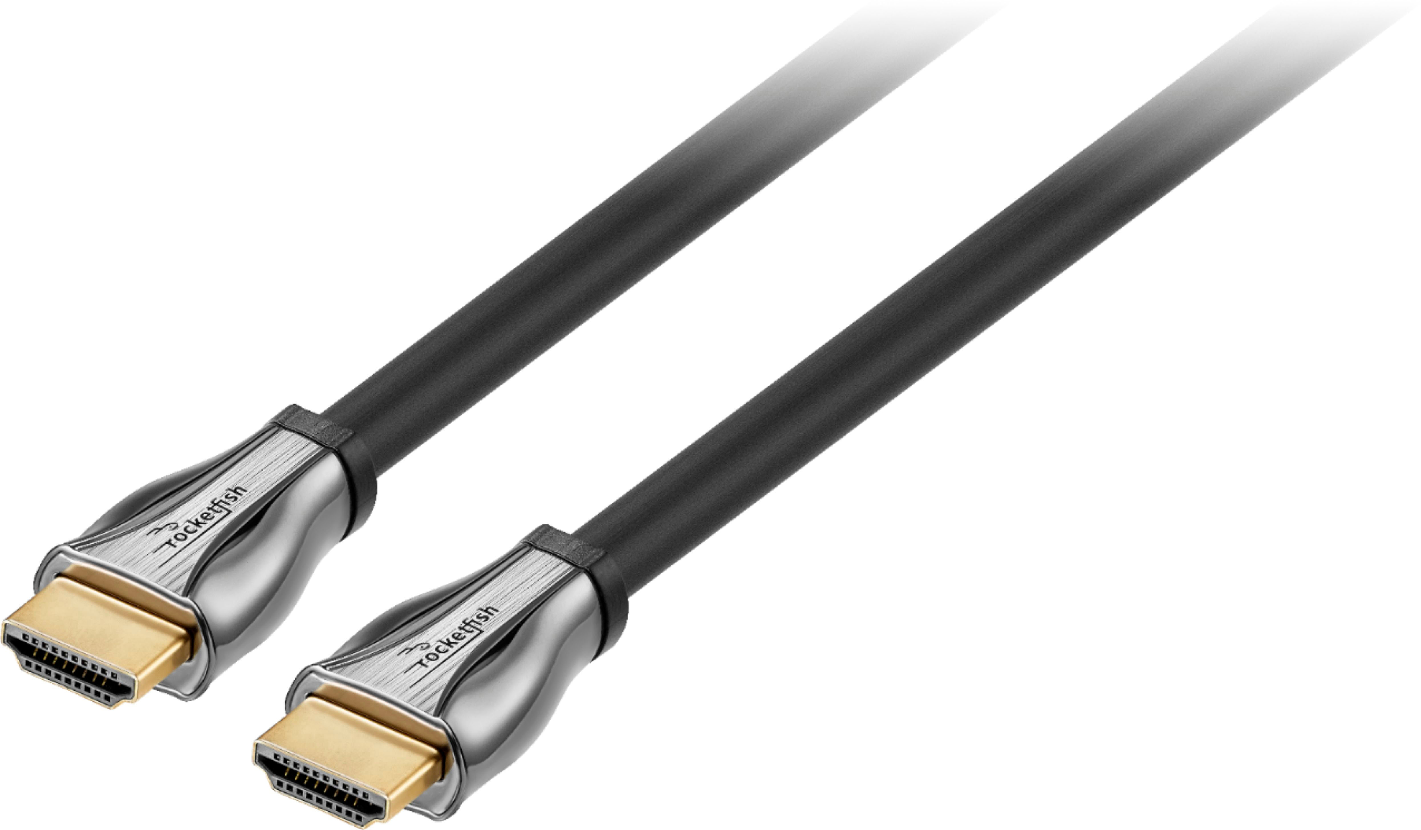

It’s not dire but definitely annoying. Coincidentally, I recently decided to order a more “premium” cable:
The cable is scheduled to arrive later today.

I don’t want to speak too soon, the problem is sporadic after all, or give a false solution. However, since swapping to the Rocketfish HDMI cable, I haven’t seen the display drop out.

I finally fixed it by switching to an old cheaply made HDMI cable, so the problem does seems to be cable dependent, but the fix not necessarily a new high quality cable.
