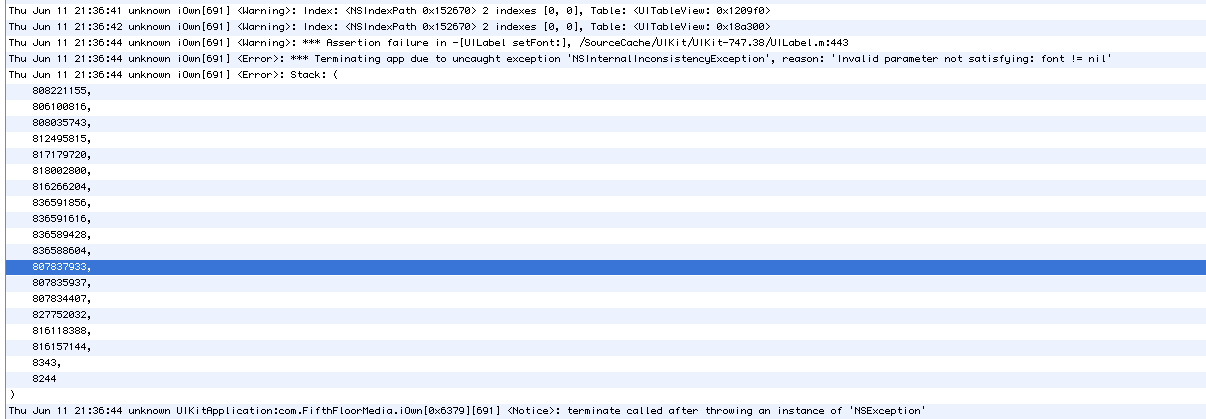

Here is what is says, it appears it's crashing from within one of Apple's libraries?
Thu Jun 11 21:36:44 unknown iOwn[691] <Warning>: *** Assertion failure in -[UILabel setFont:], /SourceCache/UIKit/UIKit-747.38/UILabel.m:443
Thu Jun 11 21:36:44 unknown iOwn[691] <Error>: *** Terminating app due to uncaught exception 'NSInternalInconsistencyException', reason: 'Invalid parameter not satisfying: font != nil'
Thu Jun 11 21:36:44 unknown iOwn[691] <Error>: Stack: (

Thu Jun 11 21:36:44 unknown UIKitApplication:com.FifthFloorMedia.iOwn[0x6379][691] <Notice>: terminate called after throwing an instance of 'NSException'

Well, it says that the font that's being set is nil. That causes the assertion failure and the app then get's killed.
Are those two lines about the NSIndexPath from NSLogs in your code?
This will not be easy to debug since you can't make it crash in the debugger.
Overall here's what I think is happening based on the crash log and these console messages. I assume this is at app startup. Your first screen is being loaded. Does anything appear and then it crashes or is it while your Default.png is still visible? A font is set for a button in your code. At a shortly later time the view hierarchy is being set up or adjusted, you can see [UIButton layoutSubviews] in the stack trace. For some reason the font doesn't exist and fontWithName has returned nil. If you have hard-coded the names of any fonts they might not exist. If you are using nibs check the fonts that you're using for buttons in the nibs.
The exact process of how the UIKit classes set themselves up obviously isn't documented so we can only make guesses based on the stack trace but it seems like something like this has happened. This is why it's failing in the Apple UIKit library. But most likely it's caused by something that your code or nib has done earlier.

Well, it doesn't crash on open. I can use the app up until the same point, if I try to move from one screen to the next it crashes. At least this part is consistent. I've grep'ed my source files and the fonts I'm setting are
Helvetica-Bold
Helvetica-Italics
Helvetica
italicSystemFontOfSize
So I'm guessing it's not that. Also, it's odd because these didn't change, if anything I would expect it to crash 3.0 because something was removed but not the other way around.
I found one font that has been removed in 3.0 that was there in 2.x but that shouldn't matter(yet). What sucks is it doesn't crash for me so I have no way of testing. My guess is it's using the libraries I currently have installed(3.0) but when it goes on an actual phone through the store it doesn't have those since they are on the phone. Something that is being used with I compile doesn't exist on the current version.
Given that this failure happens when a particular screen is being shown I'd look over the code that builds buttons and sets fonts for that screen very carefully. I would step through that code and inspect all the fonts closely. Maybe you get a nil font but the runtime exception isn't thrown in one case but is in another.
