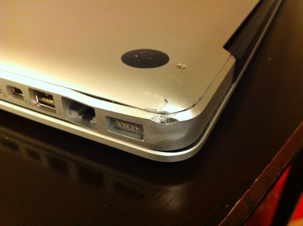

There is physical damage to the body of the computer, right on the corner where all the ports are (power, ethernet, usb, etc). The computer works perfectly as far as I can tell, but the damage prevents an ethernet cable from being used, and the lid, when closed, is misaligned.
I took it to the Genius Bar today to see what Apple can do, and was told that the only option is to ship it out for repair at the cost of $1,200. I truly believe all that the computer needs is the case - all electronics appear to be functioning perfectly.
Is it possible to get a new case for the computer? Does anyone have any other ideas? I'm heartbroken over this and the computer is NOT very old (1yr) so this is really disappointing.
Is spending $1,200 really my only option here??

For those who wanted photos, here are a few I snapped just now:
Ouch from the top/side:
Misaligned lid/display:
Ouch from the underside:

A Gerber should fix that ethernet port. otherwise, buy a new one vs. spending that much to "repair" it. seriously if apple said it would cost that much id take it apart myself and realign the screen (its obviously the metal pivots are bent) and for the ethernet id just try to straighten it enough for it to work. It will still charge right? I know I know doing this will void warranties and all that crap but seriously, $1200.... yea right. exact reason why i didnt spend money for extra apple protection, because im not worried about that stuff... im worried about damage like this. hope you get it figured out and if you do decide to shell out enough for a new mb, good luck with that one too.
From the looks of the port side the hinge is damaged, maybe that's why they are giving you you the 1,200 figure since they want to replace your LCD display too. Open your mbp and check that hinge because from my experience as an AASP tech, even if you change the case the mbp won't close as it did before the drop
If it were me, I'd attempt to align the case by the ethernet port and throw a protective case on it. If everything is working fine and the problem is pure cosmetic..why toss money in it? You're better off selling it on craigslist as a damaged but working machine and buying a new one if it bothers you that much.
why would they replace the entire lcd because of a hinge? last laptop i took apart the screen came out and the hinge was still in the laptop. they want $1200 for an estimate, and to basically rebuild the computer. pointless if everything still works. so yea, bend the hinge and the aluminum around the ports with a tool and as long as everything works, drive on. its a battle scar.
Although online you can buy the parts separately, in apple's service channels the hinges come attached to the displays assembly which apple sells at $900~ premium plus they quoted him the upper case so there's your $1,200.
OP open the mbp before replacing parts and make sure The hinge is ok if not the work you will do will be half done since the display will never close like its supposed too.
Ouch. I was going to say that you should live with it until I saw the pictures. The misaligned screen must be driving you nuts, at least I know it would drive me nuts.
