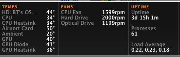

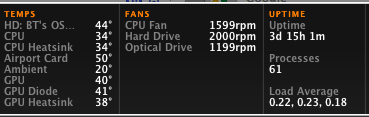

no problems here at all.. i've been using it for over 2 months now.. read/writing speeds are waaay better...
It does run about 5 degrees hotter but i bumped my fans to 2,000 rpms with SMCFancontrol and it runs at 44 Celsius which is cooler than the previous hdd..
I love it.. pretty quite and super fast.. not THAT hot.. perfect imo..

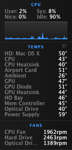

I'm using smcfancontrol too.
check out my fan speeds and temps.
Running HD Fan at 2400 rpm just to keep it at 50 deg C
Also have an 8 inch fan blowing at the back of my machine. Been on for 4 hrs just basic web surfing.
I do agree that the machine is much snappier.

hey imac.. i know you were talking about this earlier.. seriously man.. i would get a replacement on that hdd.. it's going to brake very soon.. it produces way too much heat.. there's something definitely wrong with it..
At 2,400 rpm that thing should be on the low 40's maybe even high 30's.. i hope you're backing up your files.. cause it's gonna go bad soon

Thanks for the advice BlueToothTony. This drive is in fact new. The first day it rocked to 139deg F. I'ts only been used for about 2 weeks. And for about 2-3 hrs a day. Think I should ask for a replacement?
Do take into account that my Ambient and room temp is about 6deg Celcius higher. That could contribute to it can't it? If this drive dies on me, I'm getting rid of this junk. 2 Drives...that's enough.
