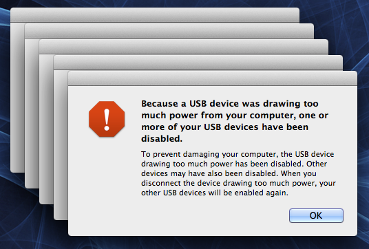

Any single device can meet requirements. Try adding several and see what happens. Don't assume a typical user is going to know what the power limits are and even if they do, if you have no AC power option, you'll be limited on how many you can connect at once if your drives have no AC option. In other words, you're not convincing me that he's all wrong in his preferences.
Oh we're talking about those kinds of typical users? Well then I take everything back! I mean who knows what chaos could ensue if they plug in too many devices without enough power?
And if they are wise enough to be using AC-powered USB devices (whew!), we can only hope that a typical user also knows that they can't plug in more than 127 devices of those into a single controller! ;)
I honestly don't know WTF you're trying to get at. The original poster says he'd prefer model with an external power supply since putting a significant additional load on a power supply will wear it out sooner than not doing so. While power supplies aren't exactly the same as a bearing being loaded down with more weight, they do wear faster with heavier loads even if "in spec". A spec is just a reasonable estimate made based on predicted loads. That doesn't mean there isn't more wear at the higher end of that spec. Frankly, I've not seen you or anyone else post a SINGLE thing that disproves what he said either. You're just wasting my time with these posts with redundant information and a snarky pointless attitude when what you say is just plain misleading and frankly wrong in context of the original post. Yes, heavier loads DO wear parts faster. Whether that's significant enough for someone to avoid them is another matter, but it doesn't invite the kind of immature displays I've seen in this thread which says more about society than anything else, I'm afraid.
