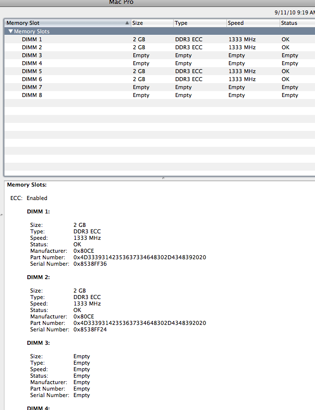

I am trying to figure out how to upgrade the memory on my 12 core 2.66 Macpro. The system was configured with 8 GB of RAM, 4 x 2 GB. I want to go to at least 24 GB, but can't figure out whether to go with 4 x 4 GB or 2 x 8 GB, or something else. Issues:
1. Various threads mention that memory should be added 3 DIMMs at a time for optimal (but possibly not real world) performance. Since I have 4 DIMMs now, I'm not sure if this means I'm already taking the minor performance hit so this is not an issue?
2. Since 8 GB DIMMS are available, I was comparing Crucial and macramdirect. I'm more interested in support, guaranteed compatibility and a lifetime warranty rather than a lower price. Crucials 8 GB DIMMs are registered, so they say that you have to remove any non-registered memory. I'm assuming the apple provided memory is non-registered and therefore would have to be removed. Since I have a support contract I will be keeping the original memory so that seems to eliminate the crucial 8 GB DIMMS? When other vendors offer the 8 GBs, will they all be registered?
macramdirect which offers only up to 4 GB DIMMS for now says "MacPro firmware prefers not mixing 4 GB with other modules". Their price for Apple Factory original 2 x 4 GB is $400, or $800 for 16 GB. I'm leaning in this direction since my configuration that way would be 100% apple.
Any advice would be appreciated.

Crucial representative was not as helpful as macramdirect. Neither was able to tell me absolutely if my current DIMMs are registered, but we are assuming that they are not. Crucial says the only way to tell (since the google search they did with my profile information was unsuccessful) would be to call Apple.
