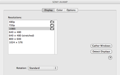

VGA connections are limited to a specific set of resolutions that often don't play nicely with widescreen televisions (unless you can verify it supports some of those resolutions over VGA), whereas I think DVI/HDMI are far less restricted in this regard. You might have to play with overscan settings a little bit, but it should work just fine. I often have used my MacBook Pro with a DVI->HDMI cable as a HTPC with Plex. Try to stick with one of the "TV" resolutions (see below), and you'll be set!
