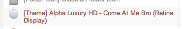

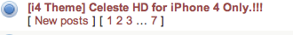

No no they're not SbSetting themes, they're springboard themes that are Retina display compatible AKA HD.
