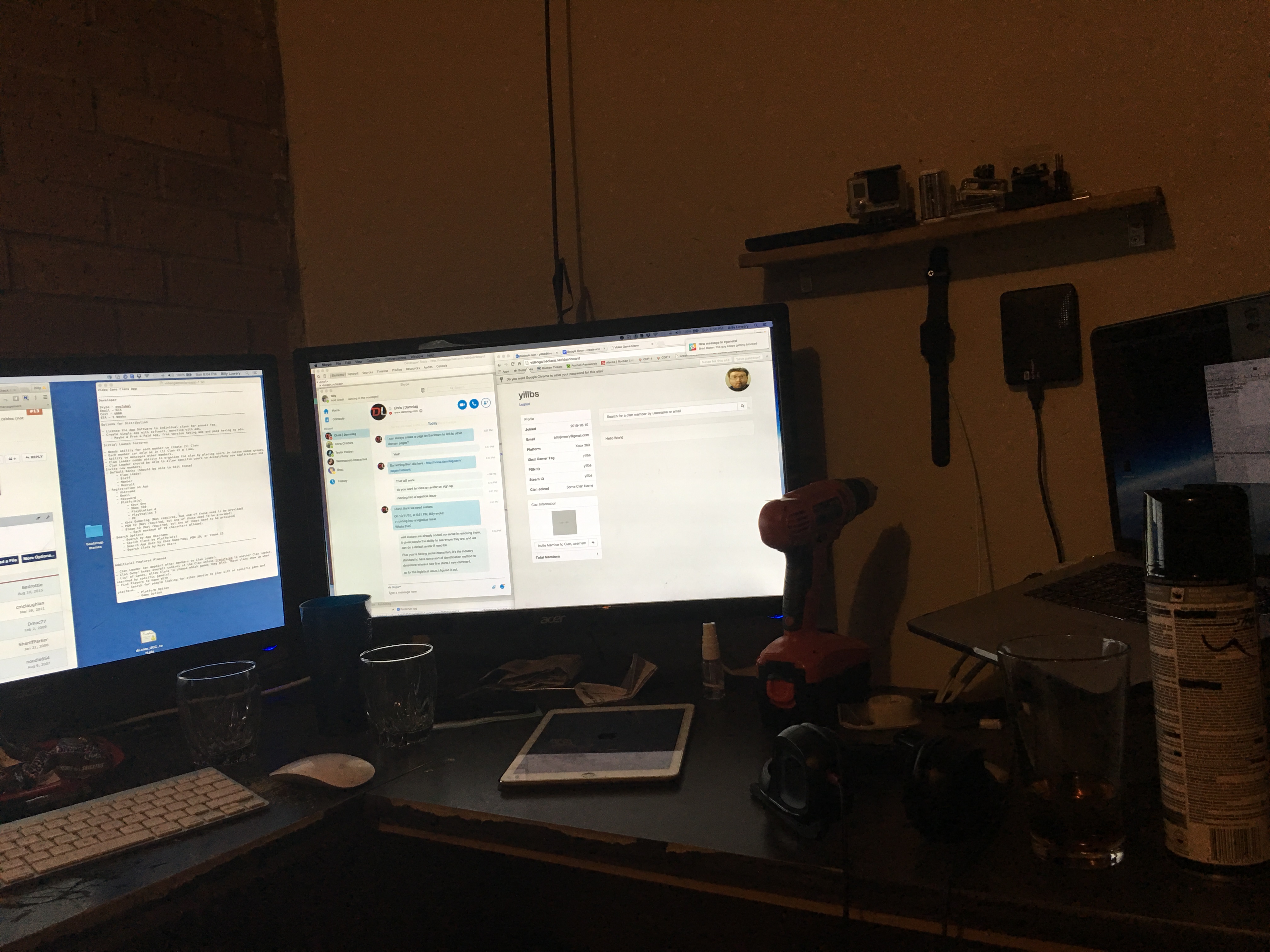

I'm using 2 27 inch monitors on my retina macbook pro. They are Acers, and they are -amazing- I've never really liked larger monitors due to the screens always being so dim, but i've had exceptional quality thus far with my acers! ignore the messy desk!!!!!!!
