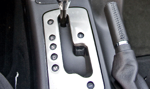

So I'm turning 16 in a few months and my parents are willing to buy me a car (yeah!). I wanted to get a manual, but my dad and his crazy reasons says I can't get one. He said I that could get a car with one of those semi-automatic transmissions that you can use (the ones where you just hit up (+) or down (-) to shift). So my question is: what are some cars to look in to that have this? We're mainly looking at mid-sized cars that are a few years old. And not some high end model. I found the Mitsubishi Galant has this feature on some of the years (i think starting in 07). Any other cars you know of? Thanks!
I know but I'm talking about the ones like in this picture:
6a00d83451b3c669e2011278fca38f28a4-800wi
Where you can set it do Driver and just go like normal automatic, or it's made so you can easily shift gears like in a manual

Yes, most modern automatic transmissions are like that. The few times I have driven automatics like that I have always found it a very poor substitute for driving a manual.
There are really two versions of this. As others have said, many automatics offer an option for this, either through the console, or shifter paddles on the steering wheel/column. The effectiveness of these vary widely. Some autos will still shift on their own, regardless of driver input, while others will hold their gears. These are all still true automatics, however, with torque converters and no clutch.
The other option is clutchless manual, or semi-automatic transmissions. These are manuals, with no torque converter. In modern designs, the car's computer controls shifts instead of the driver with the clutch and shifter. While they may seem like automatics, they aren't. It's just that the computer is doing the shifting. F1 and Indy cars used this setup for years before the systems filtered down to street cars. They are mostly used by higher-end brands, such as Porsche, Audi, Ferrari, etc. VW does offer a version called DSG (Direct Shift Gearbox) on most of their models. I think Mitsubishi offers it as well. It seems like more manufacturers are starting to offer this technology.

oh those wanna be manuals.....
Sorry but they are no where close to the real thing. The shifting is still just as sloppy as with an auto and still has the lag issues. I drive a manual as my daily driver and I have driven those Autos that and a ability to choose your gear.
Those "Semi-Manuals" are crap and you will find yourself never using it.

Would this (what i'm talking about) be the first one of those or the second? I assume the first. If so, doesn't it shift the same way a full auto does, just that it does it when the driver tells it to (for the most part)?

Most likely, it would be a so-called "manumatic", which is the first type (An automatic with options to shift manually). I wouldn't expect the manumatic in a Camry, for example, to be as manual-like as the one in a sports car. Like I said, the true clutchless manual is still fairly rare outside the high-end models. Of the models that use this method, VW is reported to have a very good version. I think Mitsu offers such an option on the Evo and a couple of other models.
I am a bit biased toward manuals, but I wouldn't mind trying out one of the clutchless manuals. My old body hurts when I have to shift a lot now. :)
Edit: Here's a couple of links to help explain things, along with a list of names for the system by manufacturer.
Manumatic: http://en.wikipedia.org/wiki/Manumatic
Semi-Auto: http://en.wikipedia.org/wiki/Clutchless
