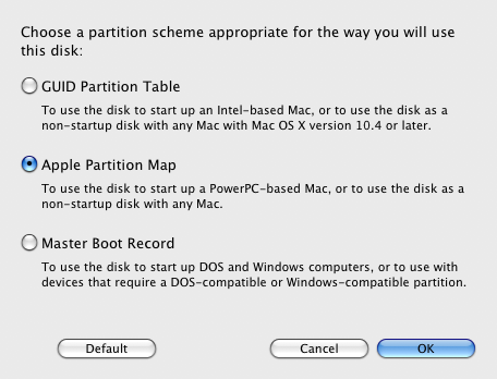

This should explain more. It'll only work on Intel Macs if you're using GPT. It's in Disk Utility under Partition when you have the volume selected.
