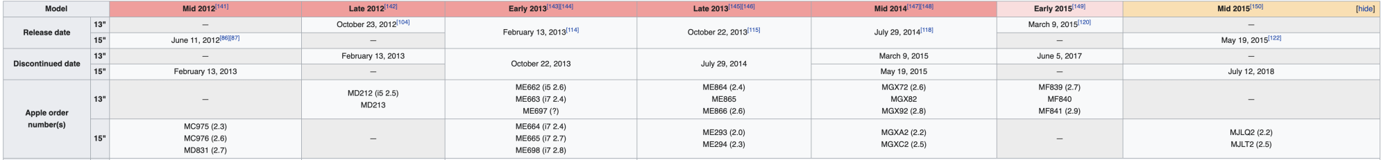

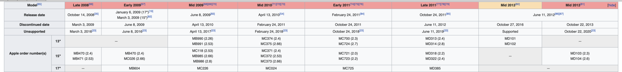

Here's a very nice table from Wikipedia showing the (on average) semiannual updates we used to get.

However, I changed my mind because a poster replying to me pointed out that Apple indeed used to do much more frequent updates (twice yearly, in fact) of the MBP's, and people liked that the MBP was was being continually updated by keeping up with technology. I think what people don't like is not knowing. If Apple returned to a more frequent update cycle of the Mac, and people expected that, it would be a plus, not a minus. That way no one gets caught by surprise when Apple updates the computer you just bought six months later.
That is very true, however, these semi-annual updates were just a minor spec bumps using the same technology platform. You'd maybe get a 100-200mh CPU bumps, that resulted in maybe 3-5% performance improvement (if at all), mostly an encouragement to customers who are on the fence of buying a Mac mid upgrade cycle.
None of these spec bumps cost anything to Apple, they just got the new party of chips from Intel and put them into the logic board. I kind of doubt that it even costed anything to Intel, since these were most likely the same chips just configured with slightly higher frequency. Chip manufacturing getting more cost effective/mature over time probably also paid a role.
But the context we are discussing here is very different. We are talking about a major upgrade and an entirely new chip production line. It's a major investment for Apple to roll out a new family, and producing it for just a couple of month is likely not financially viable. I would also expect a major performance difference between a 5nm and a 3nm chip. IMO, ff Apple even goes back to the semi-annual updates (which is honestly doubt as that was a side-effect from Intel's release schedule), these will be just minor clock boosts again with no real changes in manufacturing process.

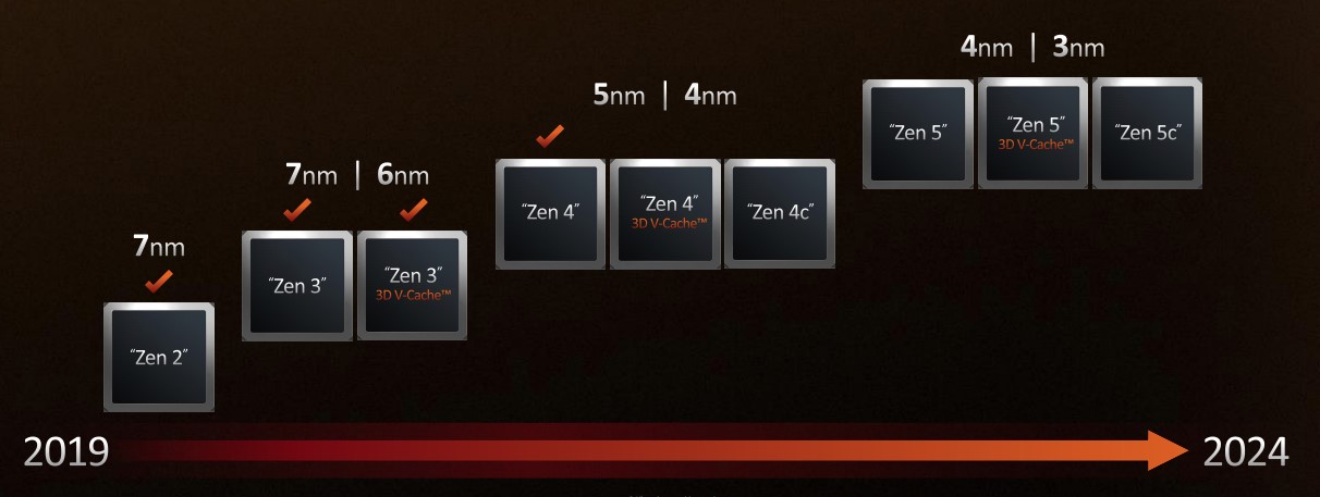

Funny how Zen4 can span N5 and N4 while Apple can't possibly do M2 on any other node than N5P. Or that Zen5 can span N4 and N3 while Apple "has to be stuck" on N5P for the rest of the M2 line up because ... can't be done.
Or that the A10 was 16nm and the A10X was 10nm because Apple can't split an implementation over multiple fab processes.
If Apple (or AMD or Intel) plans out at the start 3-4 years in advance to put a architecture on two different fab nodes it is entirely possible. Folks have done it. The old , highly successful Intel 'tick / tock ' strategy was largely built on that premise.
Doing it ad hoc , 'on the fly' is costly and unproductive. Doing it as part of a long term plan can work quite well.
Because Apple doesn't do the kind of volumes AMD does for its regular (chiplet) cores. Not to mention AMD can mix & match their chiplets in almost any combination now, the image you're seeing is for zen4, zen4c & zen4 (x3d) cores. It doesn't say which cores will be made where, besides 4nm is just an optical shrink like they did with 14-12nm. So no Apple will not be making (monolithic)chips on two separate nodes, in fact no one does this except AMD & even they'll do it very rarely like zen3 based 6xxx mobile chips.
