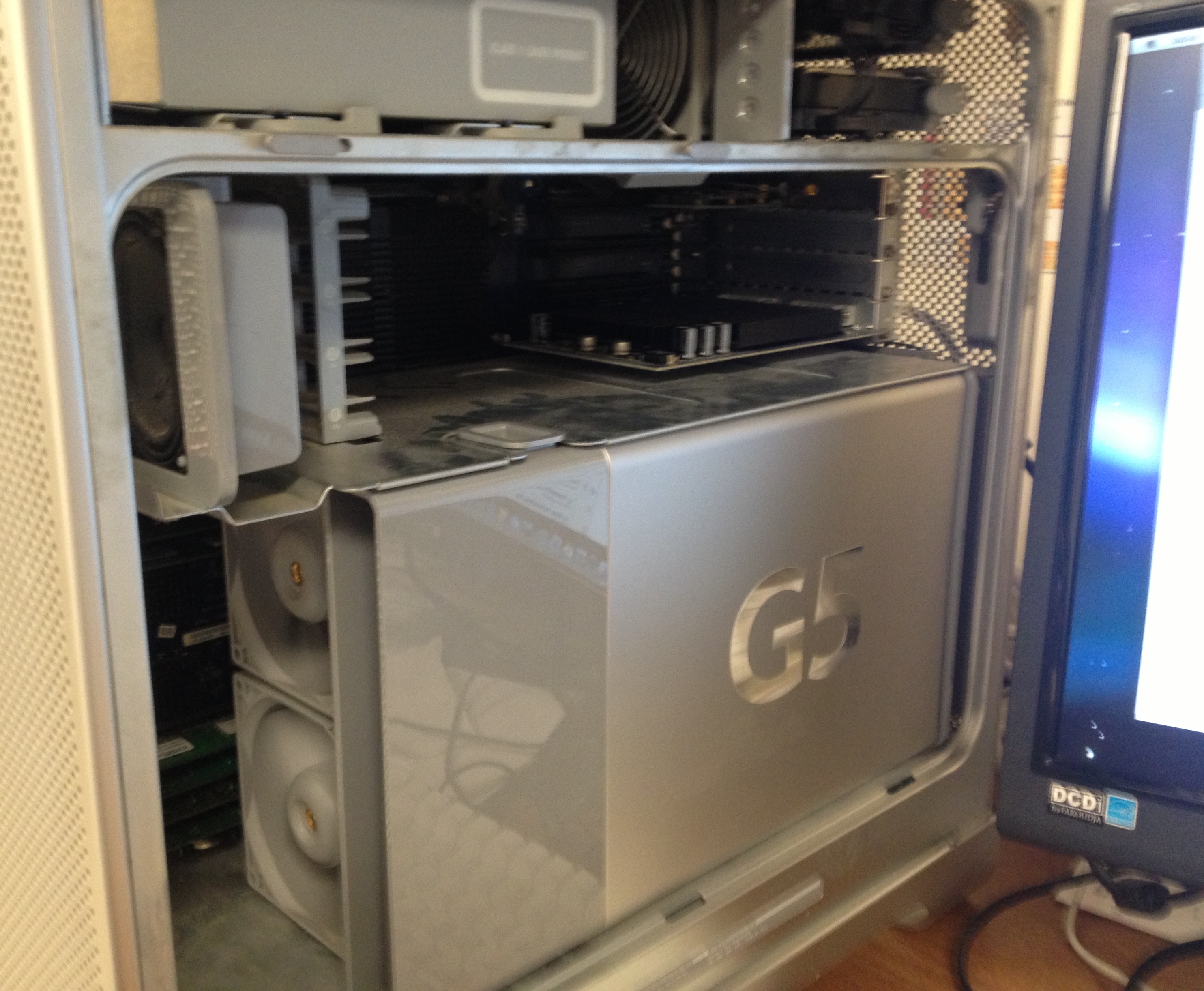

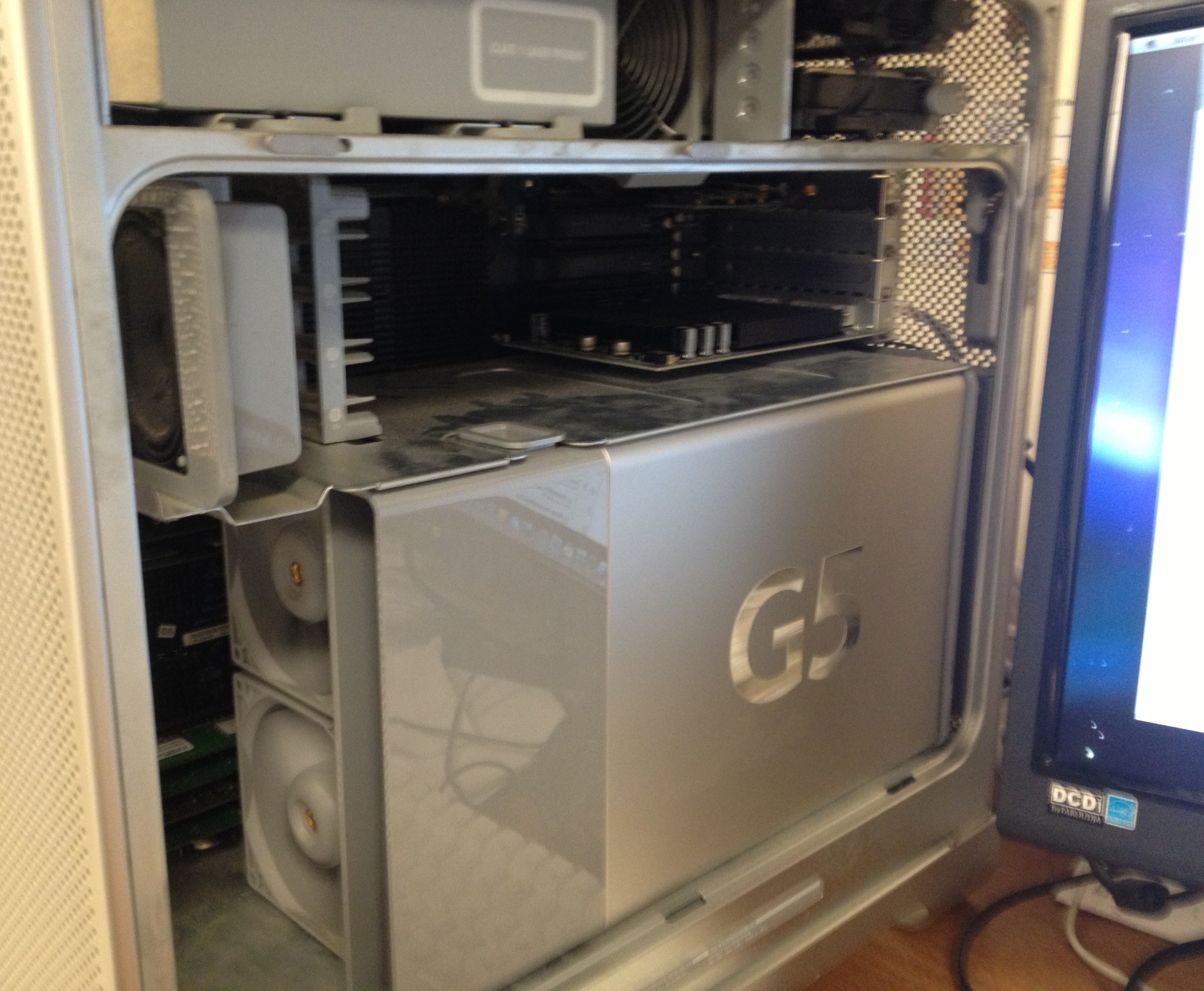

By the way, just to show the cosmetic similarities, here's what the inside of my Dual Core G5 looks like-notice that it does indeed have the same large plate covering the processor as the quads have. If I were to remove the front fans(which I didn't do, as it was on at the time) you would see that it was air cooled, but that's the most noticeable difference.
Ah yes, I see. I looked it up after posting this and realized it. However, the seller did notify me that it's a Quad G5, and I picked it up today! $60, and it came with a small Dell Ultrasharp monitor and Apple keyboard.
