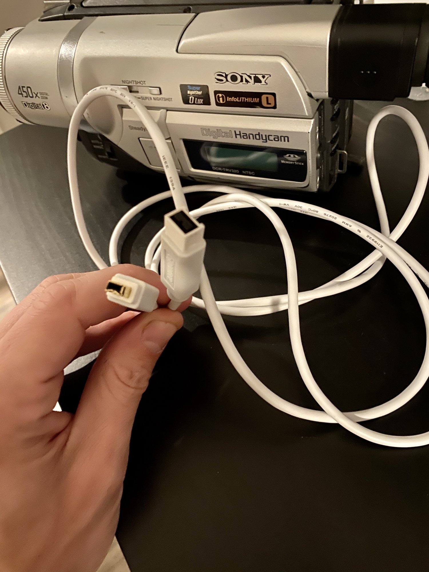

I’m trying get some clips off of old hi8 tapes. This is the camcorder and only cable I have. What cable/adapter combo will I need to transfer these videos to iMovie?

You will need 2 adapters chained together (but no additional cords): Apple’s Thunderbolt 3-to-Thunderbolt 2 adapter, and then a Thunderbolt-to-FireWire 800 adapter (which Apple also makes). Plug those 2 into your MBP16, then the cord you show from the 2nd adapter into camera.
