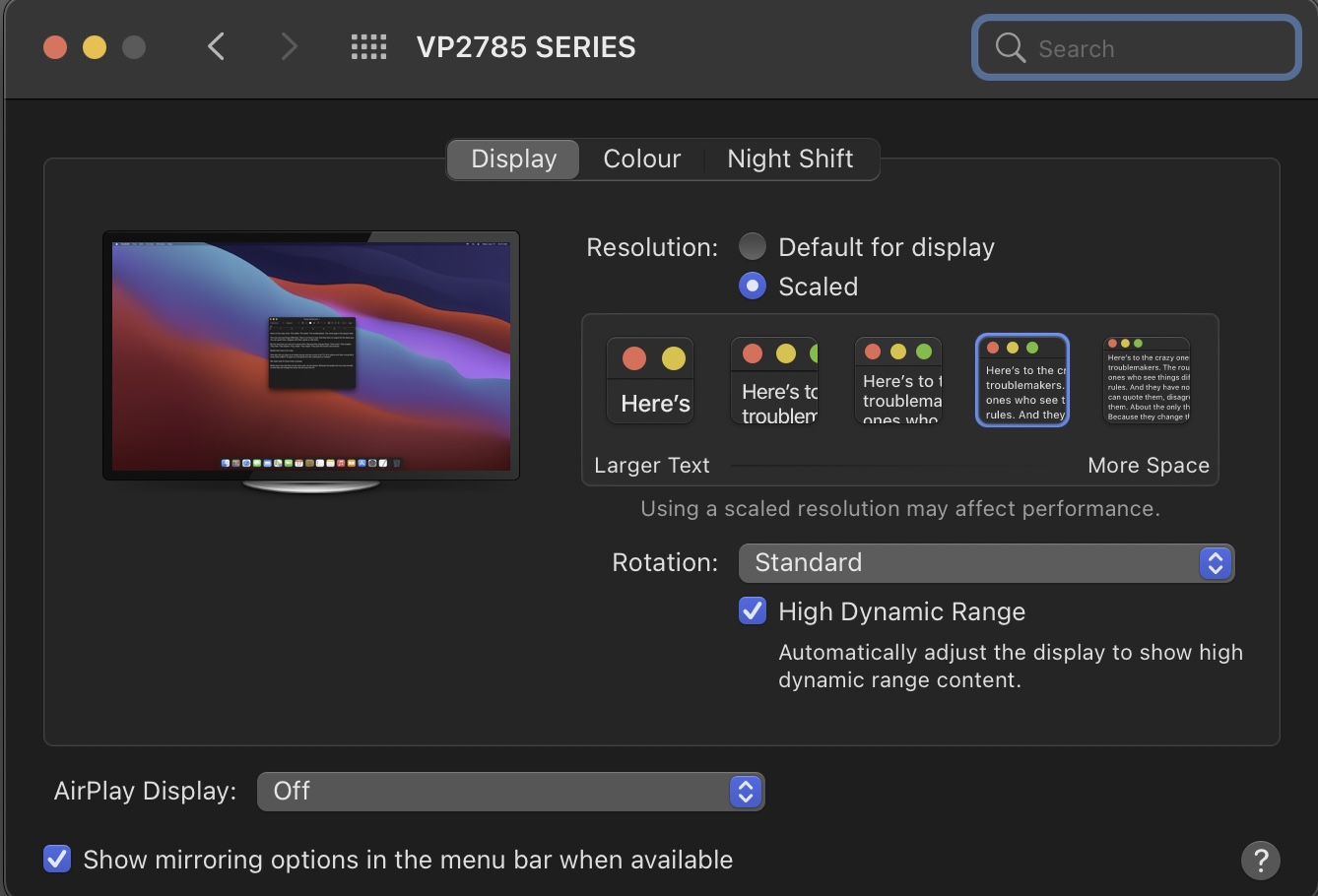

I just got the new HDMI 2.0 to HDMI cable & it has now enabled HDR in the control panel display settings.
My next question is does the HDR function works while we are using image & video editing programs like Photoshop, CaptureOne Pro & Davinci Resolve or is it only for TV streaming & youtube content?
MY youtube watching surely has changed my viewing experience even though this monitor is HDR 10 @350nits brightness.
