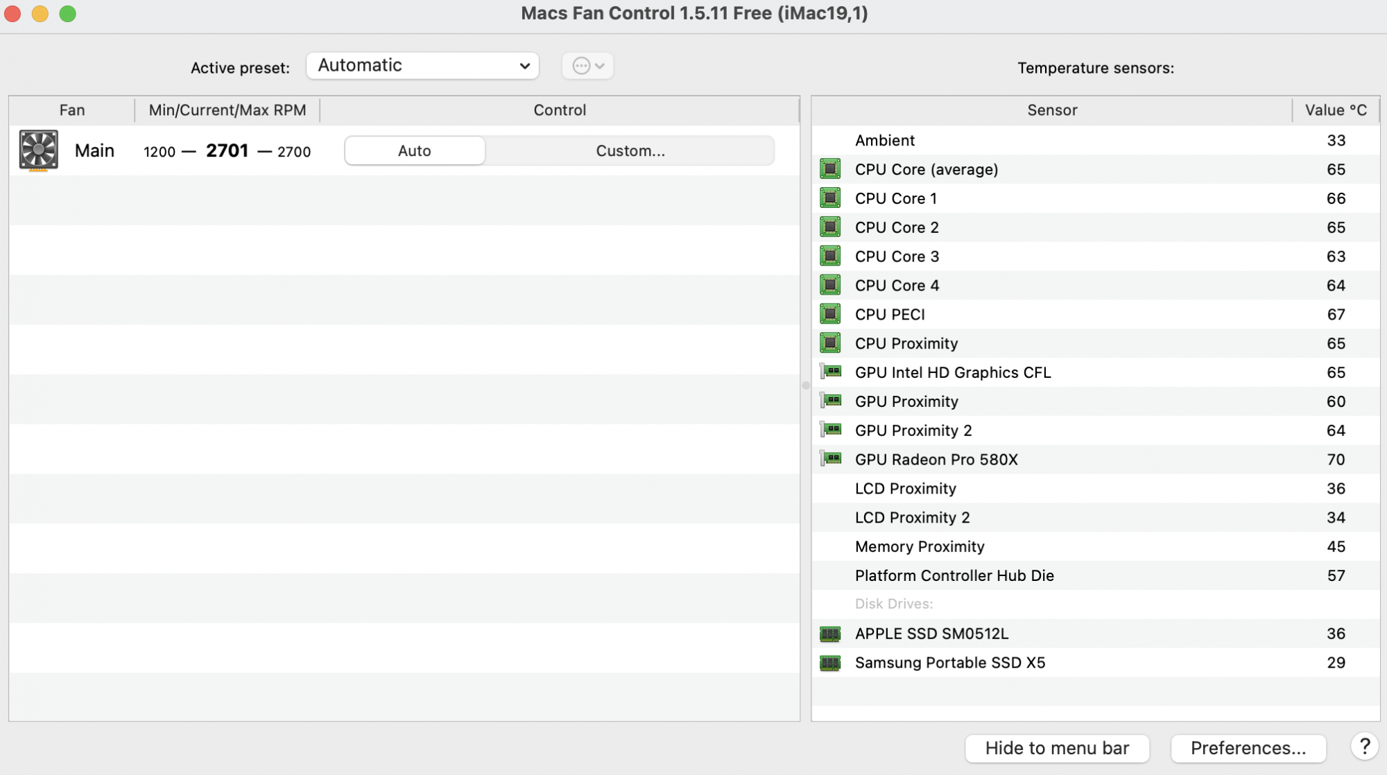

One thing you can do is install Macs Fan Control so you can see all the temp sensor levels, and then make changes to their thermal curves. At least you can see exactly what is happening with temps and then decide if you want to risk higher temps to slow fans a bit and reduce noise.

Fire up Macs Fan control in the default setup (no changes) and just watch the temps for every sensor (don't forget to set it to launch automatically in login). You will see Apple's default settings are actually a bit too conservative (for my tastes); the fans ramp up late...which makes the machine quiet most of the time for most users. All bets are off for heavy loads (I forgot to include stuff like video editing). Ramping to medium speed sooner may help stay out of max fan mode longer.
A long session of anything will ultimately lead to needing to push a lot of heat out (max fans) to not risk sustained high temps known to limit the life of electronics.
Still...once you see the temps, you can start to tinker with fan speeds and see if you can find a setting that is a bit of a compromise between noise and temps.
This is how fans are in full wow blazing loud fans.

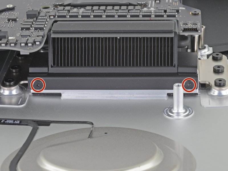

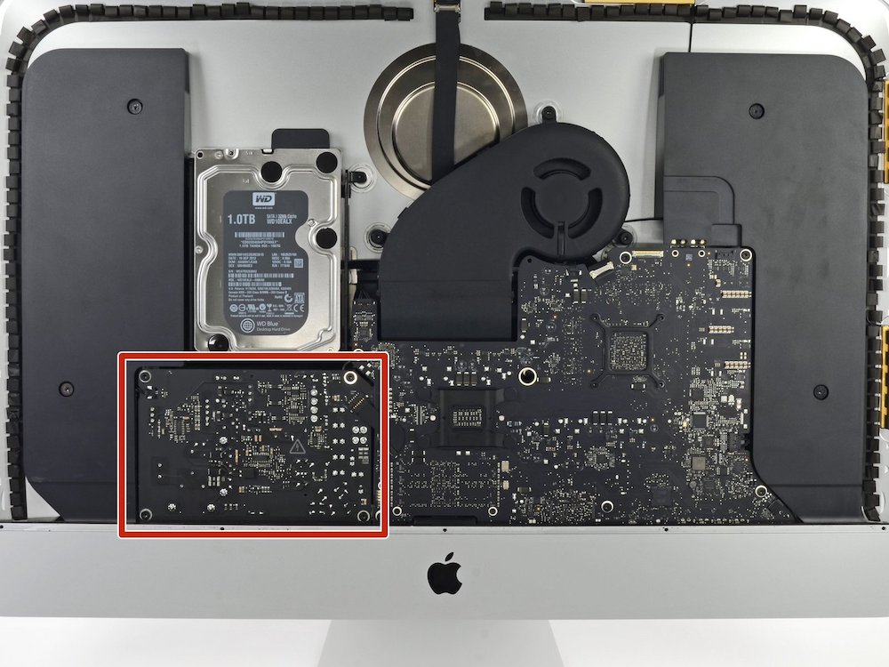

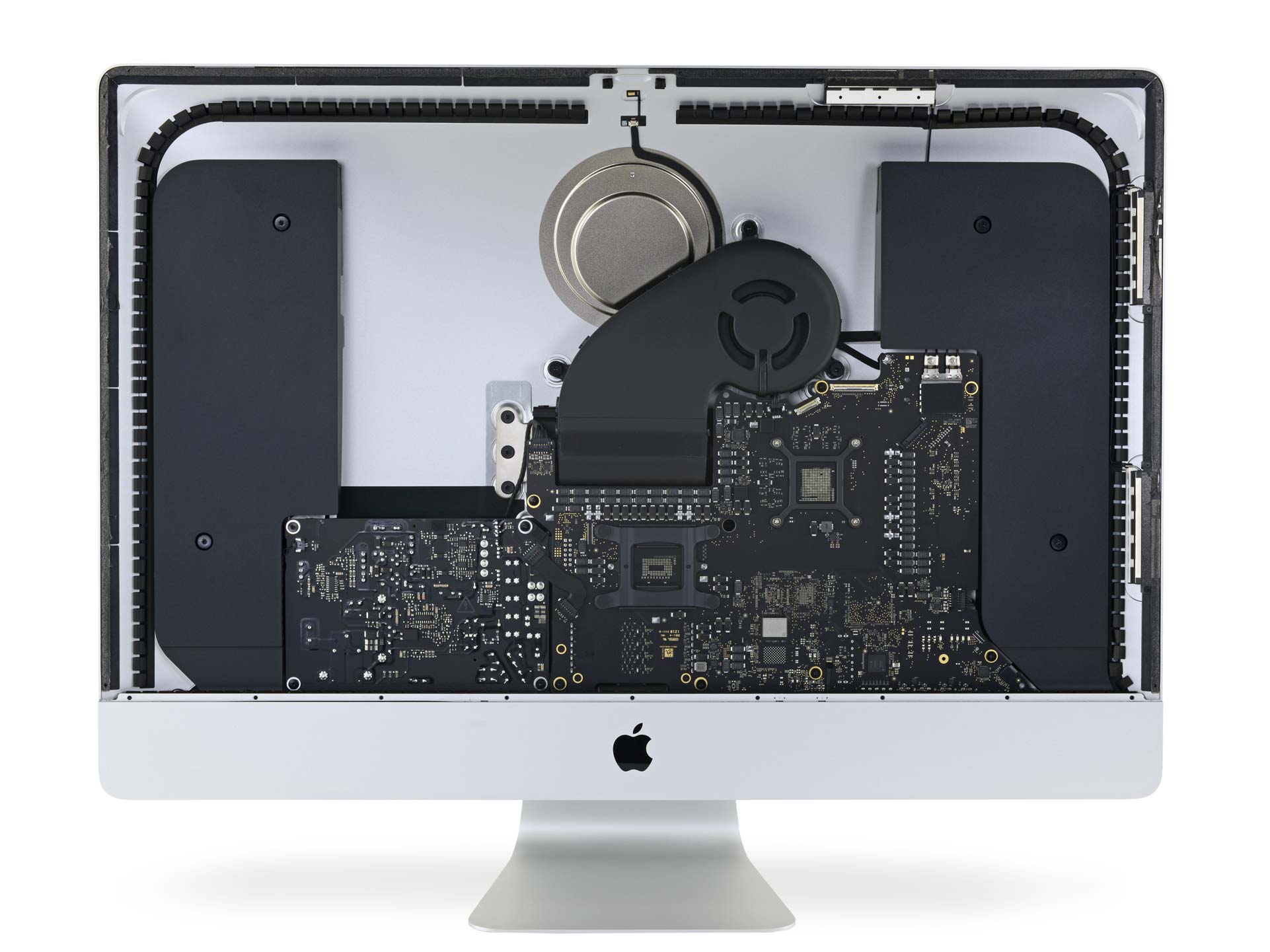

Based on the iFixit repair guide for the 2020 5K 27"...only one fan. So not much to be done:
Older imacs had 2 fans, and I feel like way back they had 3. So some tweaks could be made to limit noise without crazy temps.
Underneath the duct at the top of the logicboard there appears to one heatsink, which I assume is performing double duty for CPU and GPU via heat pipes. By any stretch, it seems like too little surface area for sustained load, compared to the heatsink fan combo on any middle-of-the-road GPU:

That is not a 2020. 2020 iMacs had all solid-state storage.
Perhaps, but the pics are from the guide entitled:
iMac Intel 27" Retina 5K Display 2020 Logic Board Replacement
I suppose the 2019 or earlier may be the same regarding repair process/steps and somebody recycled pics? Or...maybe it is simply is wrong.
Either way, the point likely stands: single fan, smallish heat sink, nothing really to be done to improve cooling on the hardware side.
