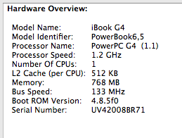

I simply can't afford a new Macbook and my old iBook G4 is getting very sluggish. I've cleared off a load of files onto an external drive but is there anything else I can do?
I'm currently running OS 10.5 and was wondering if I can put more than 768MB RAM in it. My friend has an old, broken PowerBook G4 with 2GB - can I use that RAM?
Any help, ideas or suggestions appreciated.
Also, why is the Model Identifier "PowerBook6,5" when I have an iBook??
The model identifiers for all machines from that era were PowerBookX,Y (for laptops; both the PowerBooks and the iBooks) or PowerMacX,Y (for desktops; the iMacs, the Cube, even the PPC Mac mini.)
It wasn't until everything went Intel that we saw more 'descriptive' prefixes (MacBook, MacBookPro, Macmini, MacBookAir, iMac).
