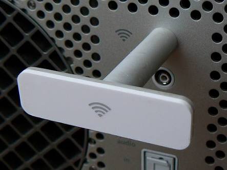

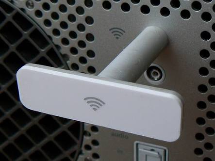

I could be wrong but all of the dual 1.8 G5s I’ve seen take a standard AirPort Extreme Card and won’t need a runway card or adapter. You will however want to get hold of the little antenna which connects at the rear of the tower.
I wouldn't know. My only real experience with G5's has been a base model single processor 1.8Ghz late 2004 Mac. And then the high end Quad. My only other G5s are a 2.3 DC and a DP 2.7.
The last I have not messed with much so there is a gap of models I don't have any experience with.
As far as that T connector…I have one. Damn things are expensive so even though the 1.8Ghz SP never came with an Airport Extreme card I've kept the T connector. Still wrapped in it's plastic. 😀

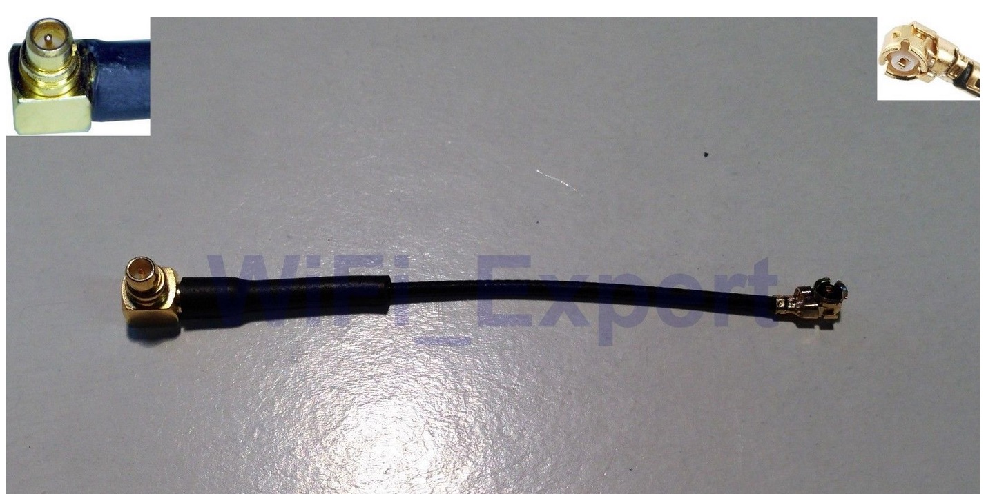

If you wanted to use the built-in antenna (the long gray strip on the back of the Late '05 G5 tower), you could probably adapt the female MMCX (right-angle) antenna jack on the Airport Extreme card to the U.FL IPX female connection of the internal antenna.
This is a picture of a Male MMCX Right-angle to Female UF.L IPX adapter, but you'd either need a gender converting UF.L IPX lead (male-male) or chop and splice two male-female pigtail leads together with a little touch of solder and tape it up.
I can't seem to find any gender switching cables, but I imagine they probably exist.
