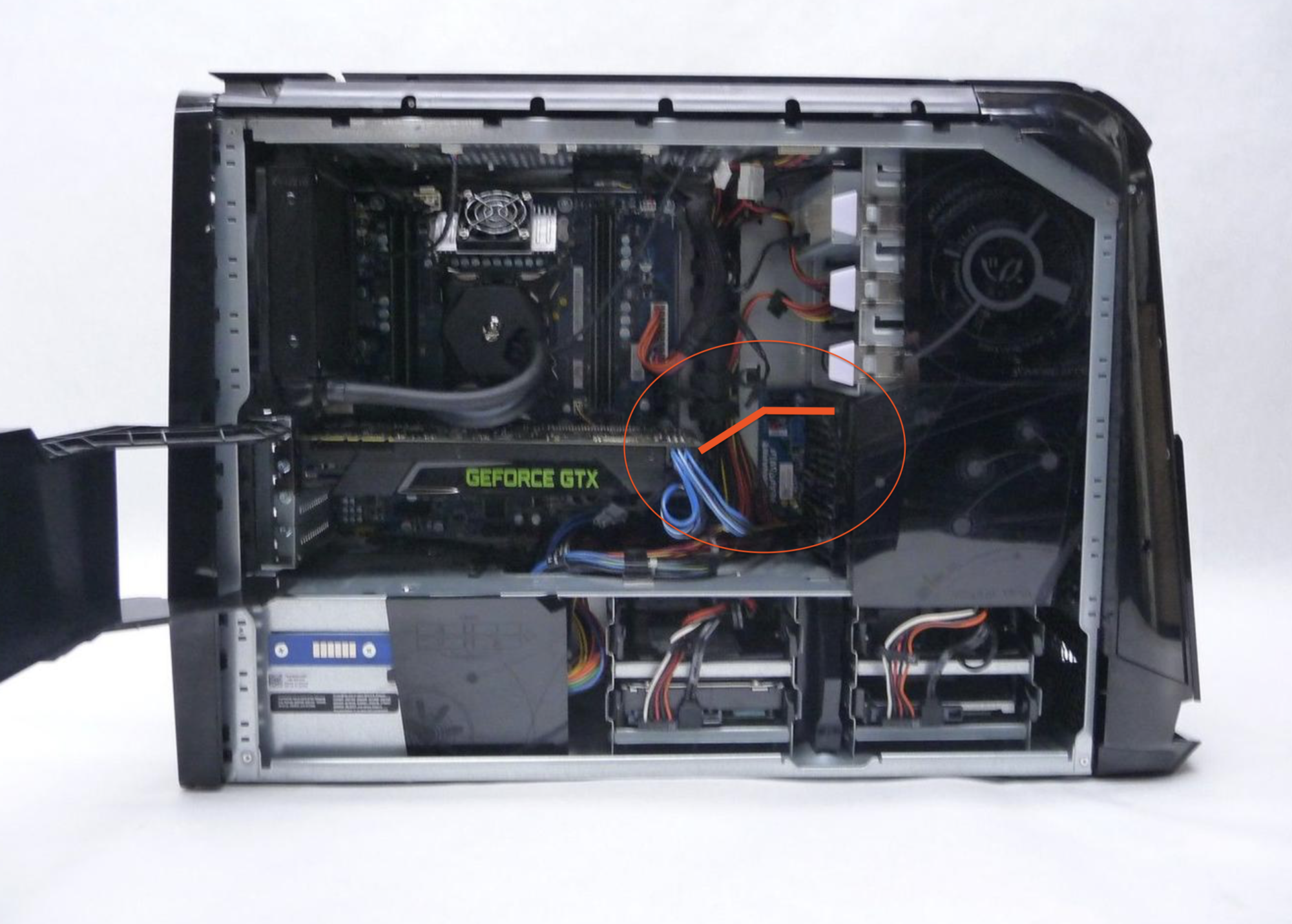

I can post a picture when I get back into the computer. There are some brackets that are screwed into the back of the GPU that face the front of the computer where the DVD drive is. Never seen this before either, have to remove these before I can remove the GPU's.
picture is not of the machine I am working on, but insides are identical save for it only have 1 GPU and no brackets supporting the dual GPU's.

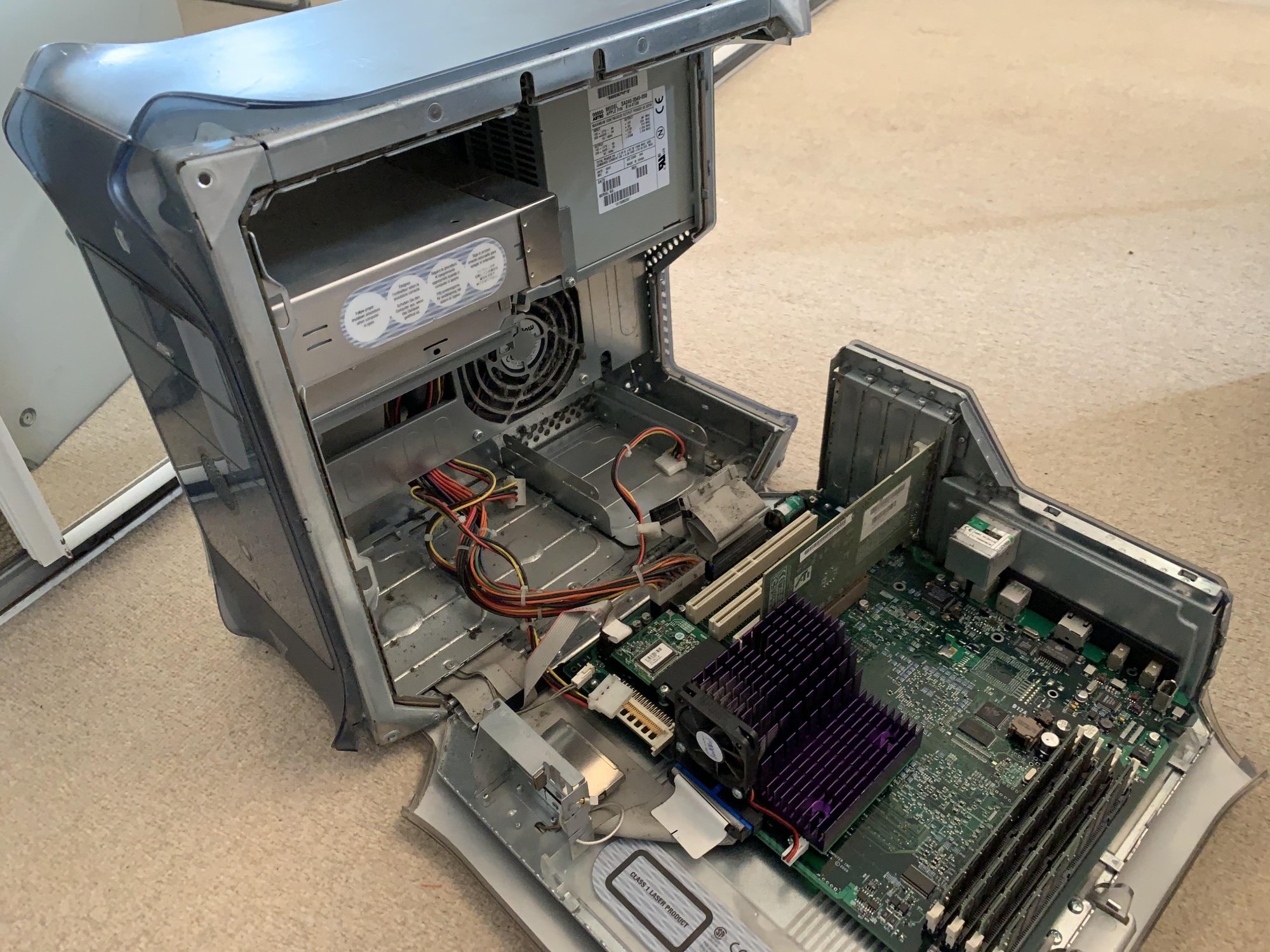

I really miss the amazing and ahead of their time designs of the PowerMac G4 towers! So much easier to get at everything.

The bracket you are describing is probably for compensating for the weight of both cards, or for making sure there's room between them to breathe. Either way, the coin cell is most likely behind the card.

oh I know it, I have done a few partial builds and my current computer I built from scratch. Much cleaner inside, though still nothing like the PowerMac G4's, wish someone would just flat out copy that design internally. Outside is dated, inside is majestic and so functional!
