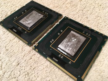

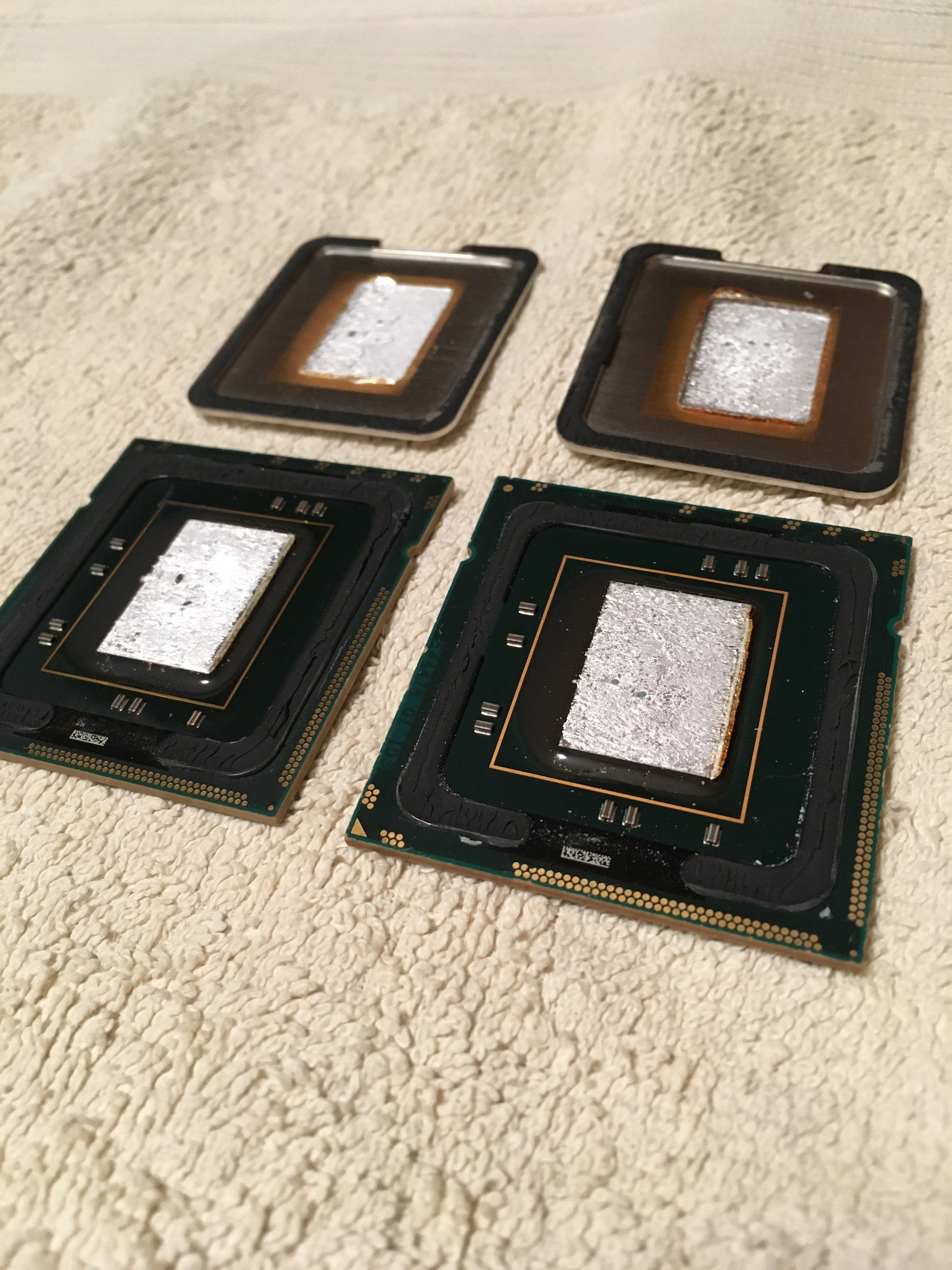

Job done. 🙂

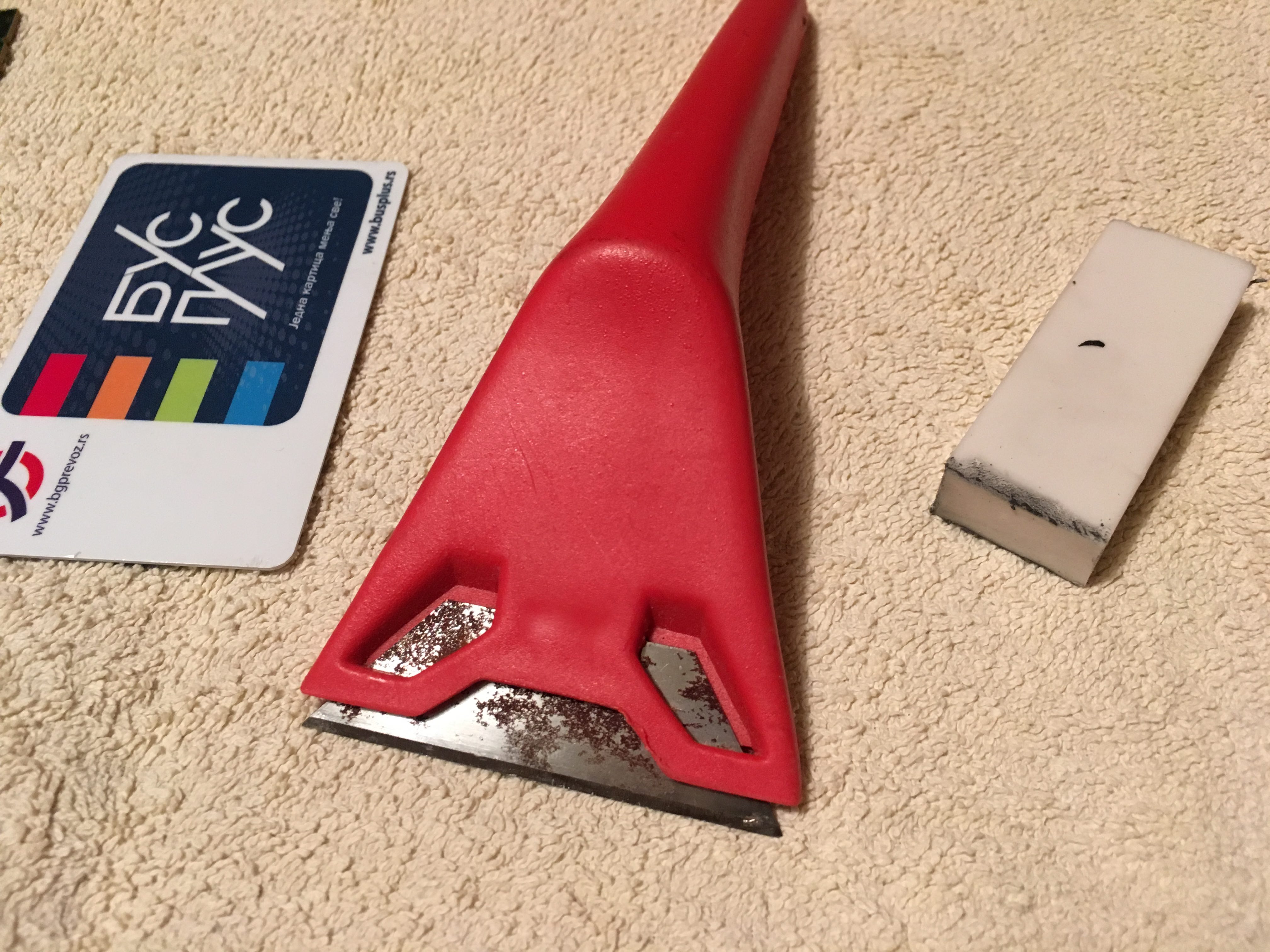

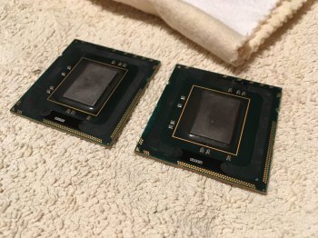

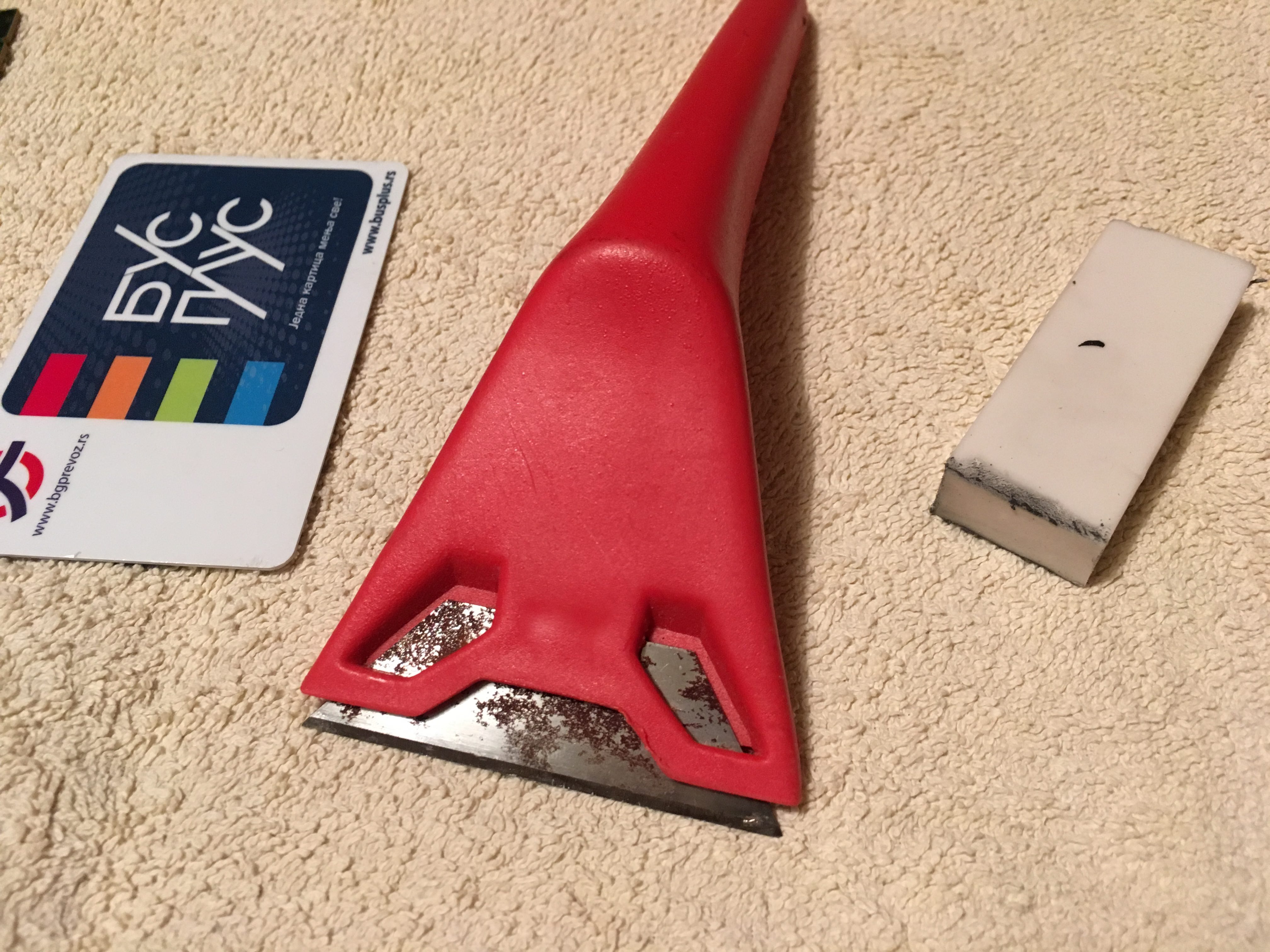

I've used credit card for the first pass, then some kind of scraping knife (razor was too flexible so i skipped it), first pass when polishing was done with eraser (regular, for graphite pencils) and last one was done with cloth for silver cleaning.
I'm not completely satisfied with the results, but considering the tools i had, it's quite ok.

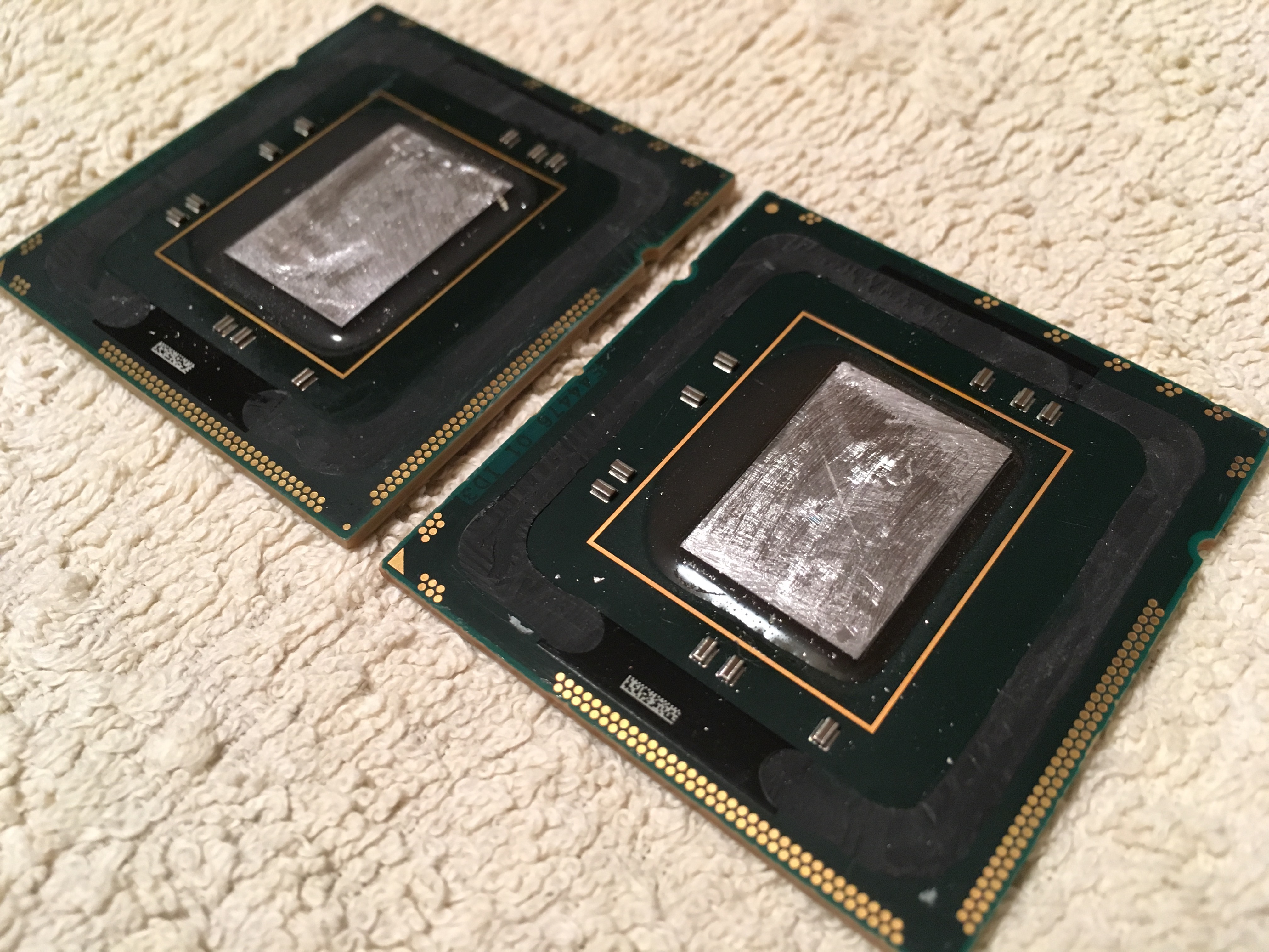

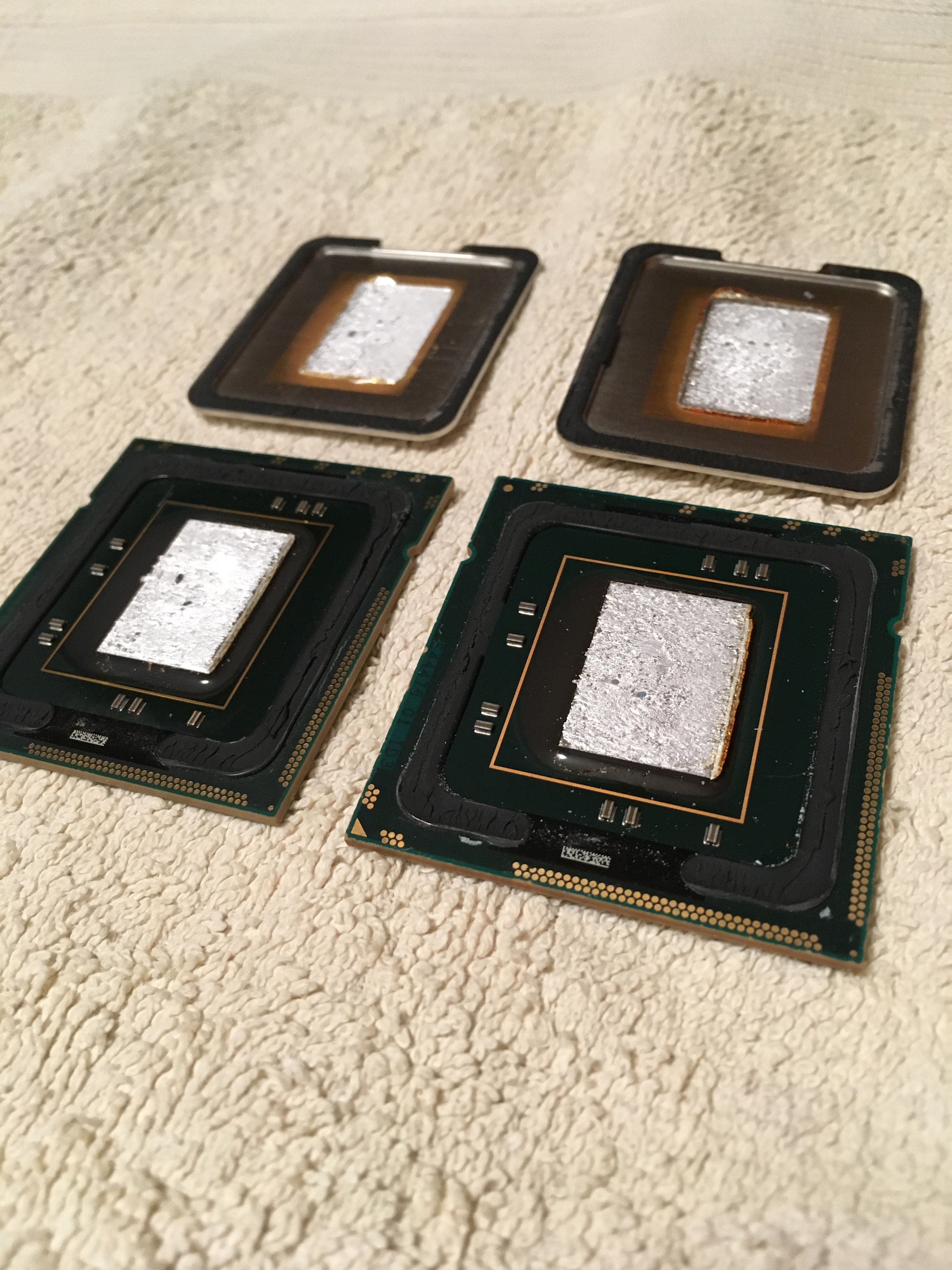

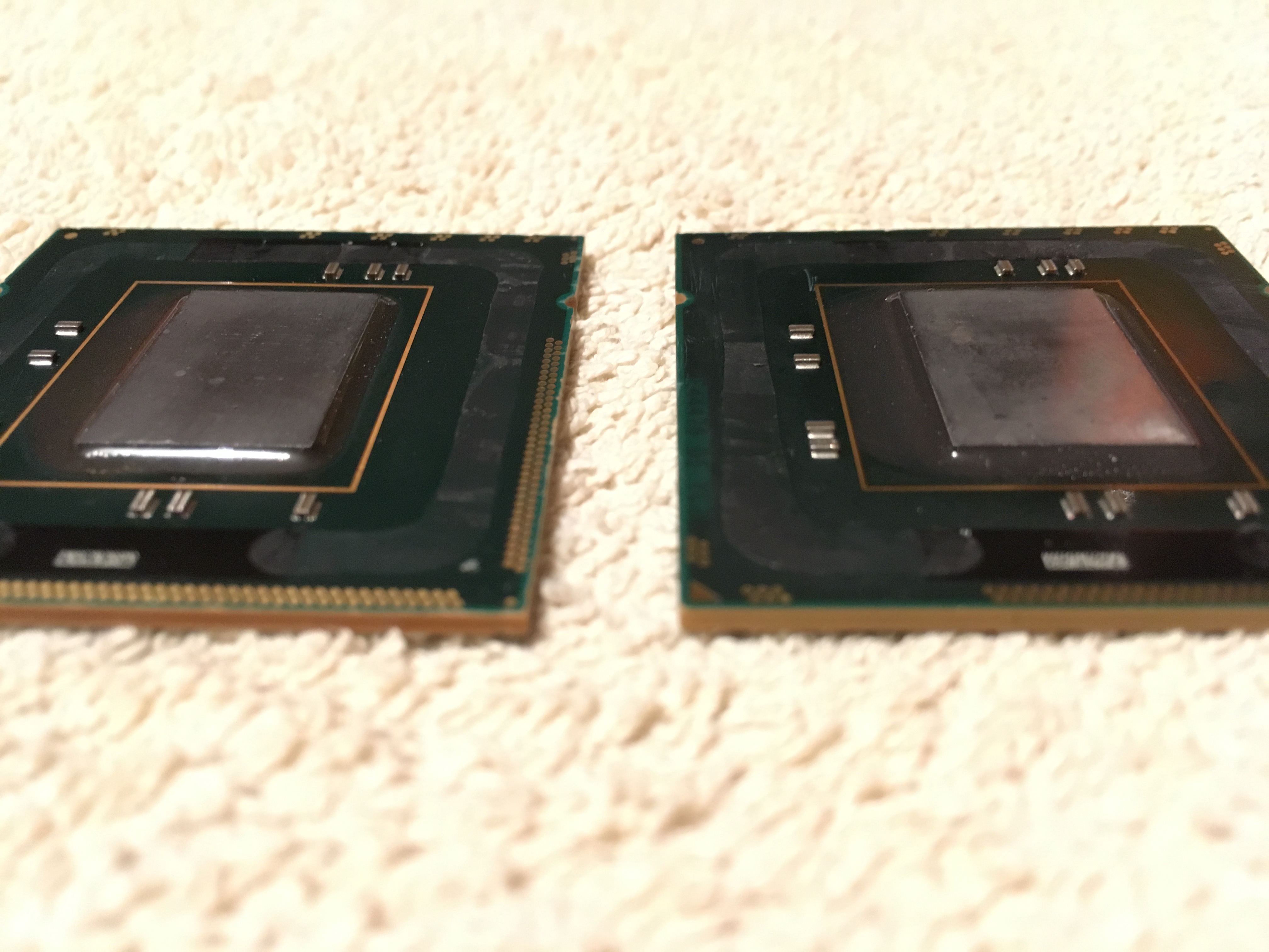

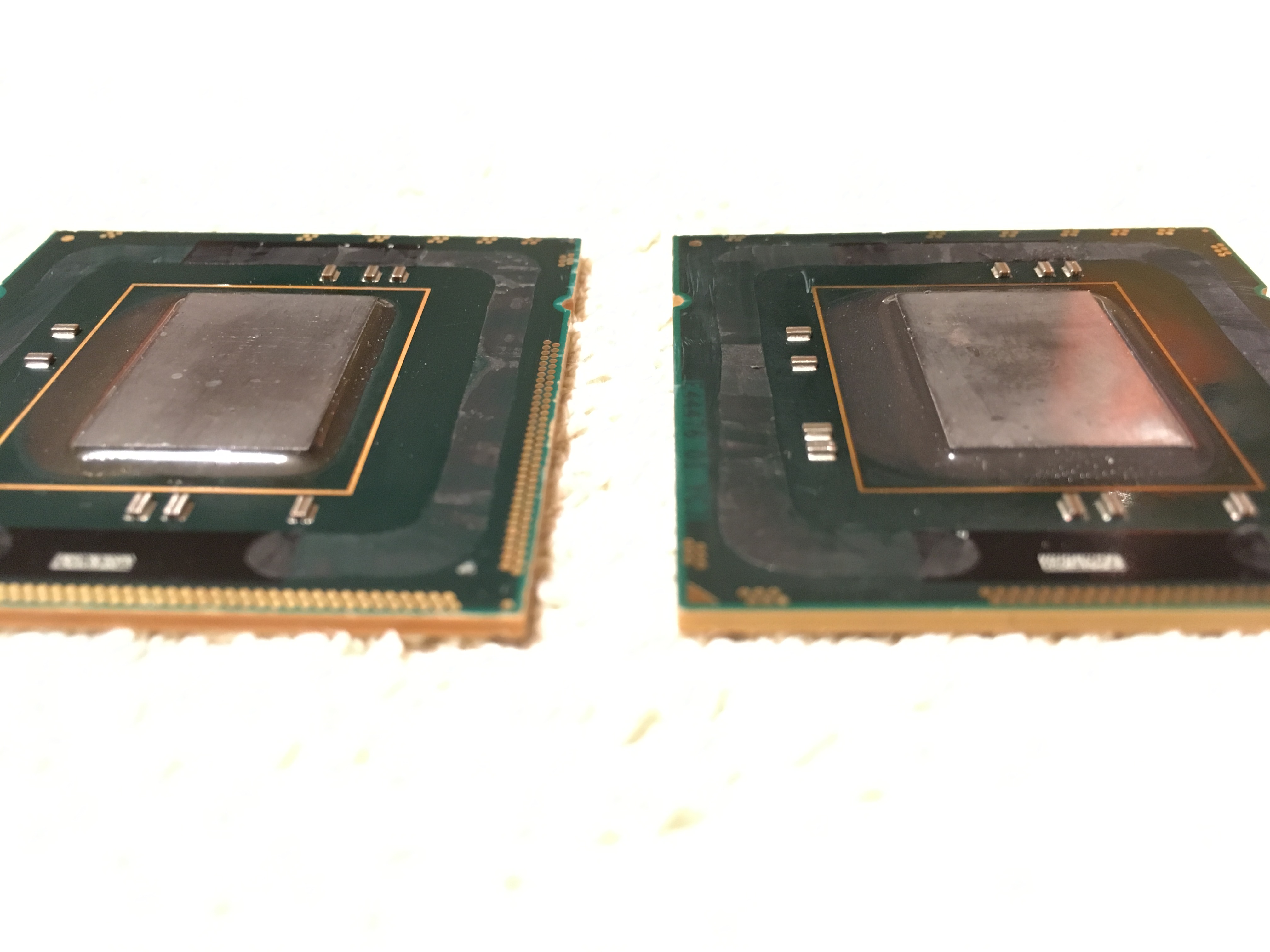

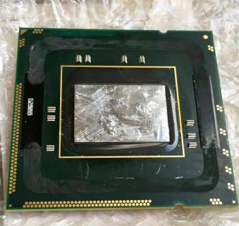

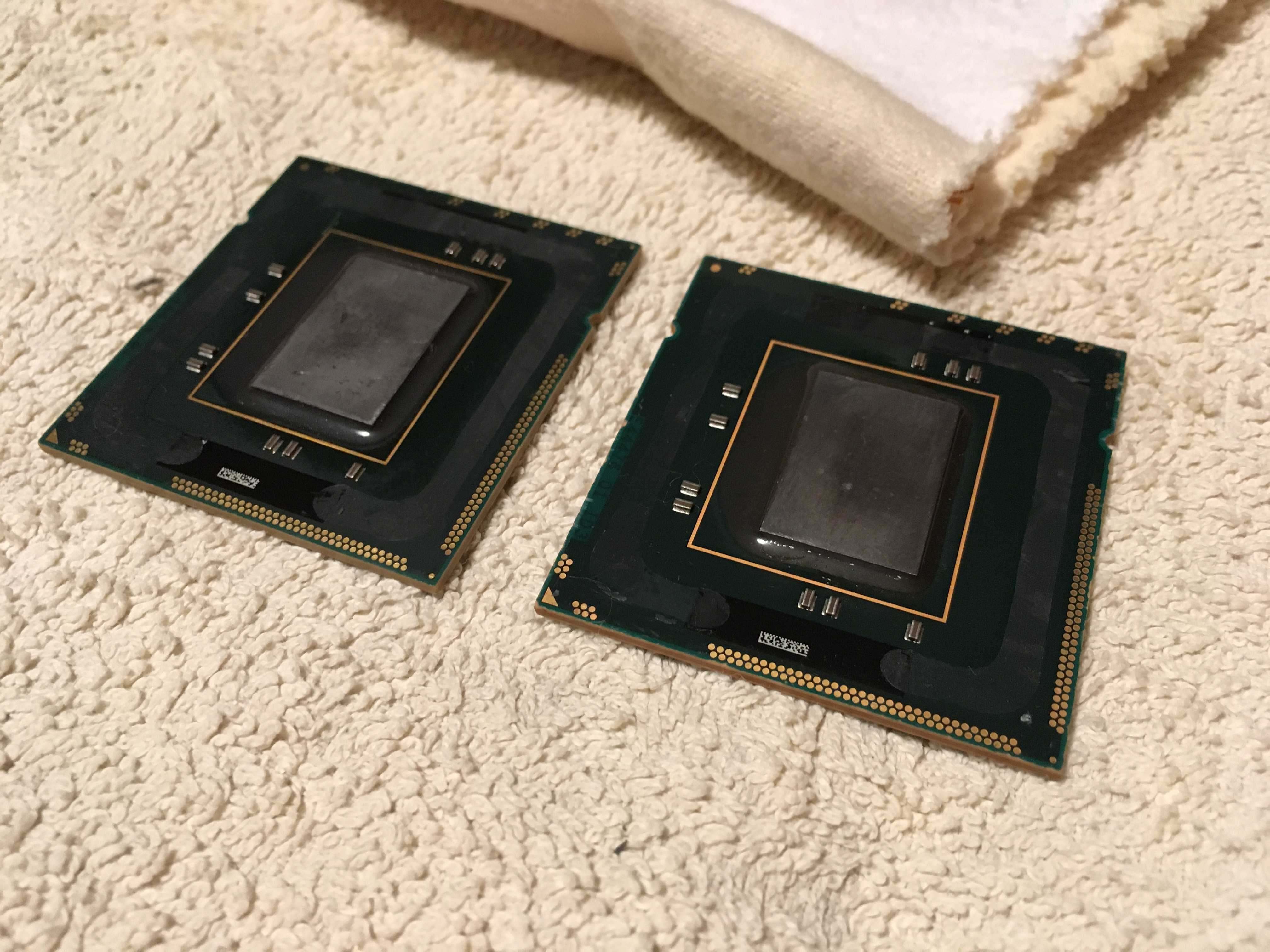

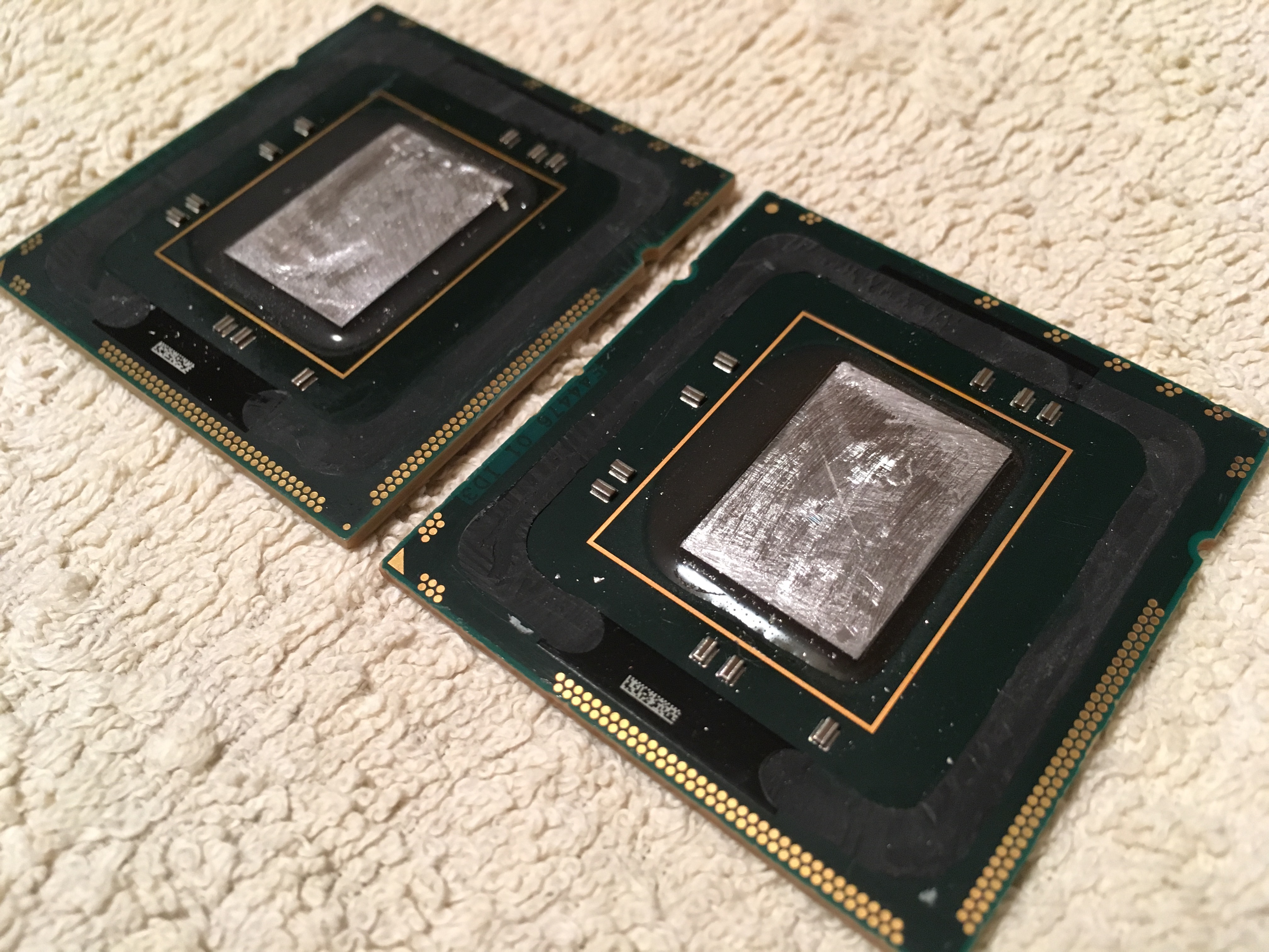

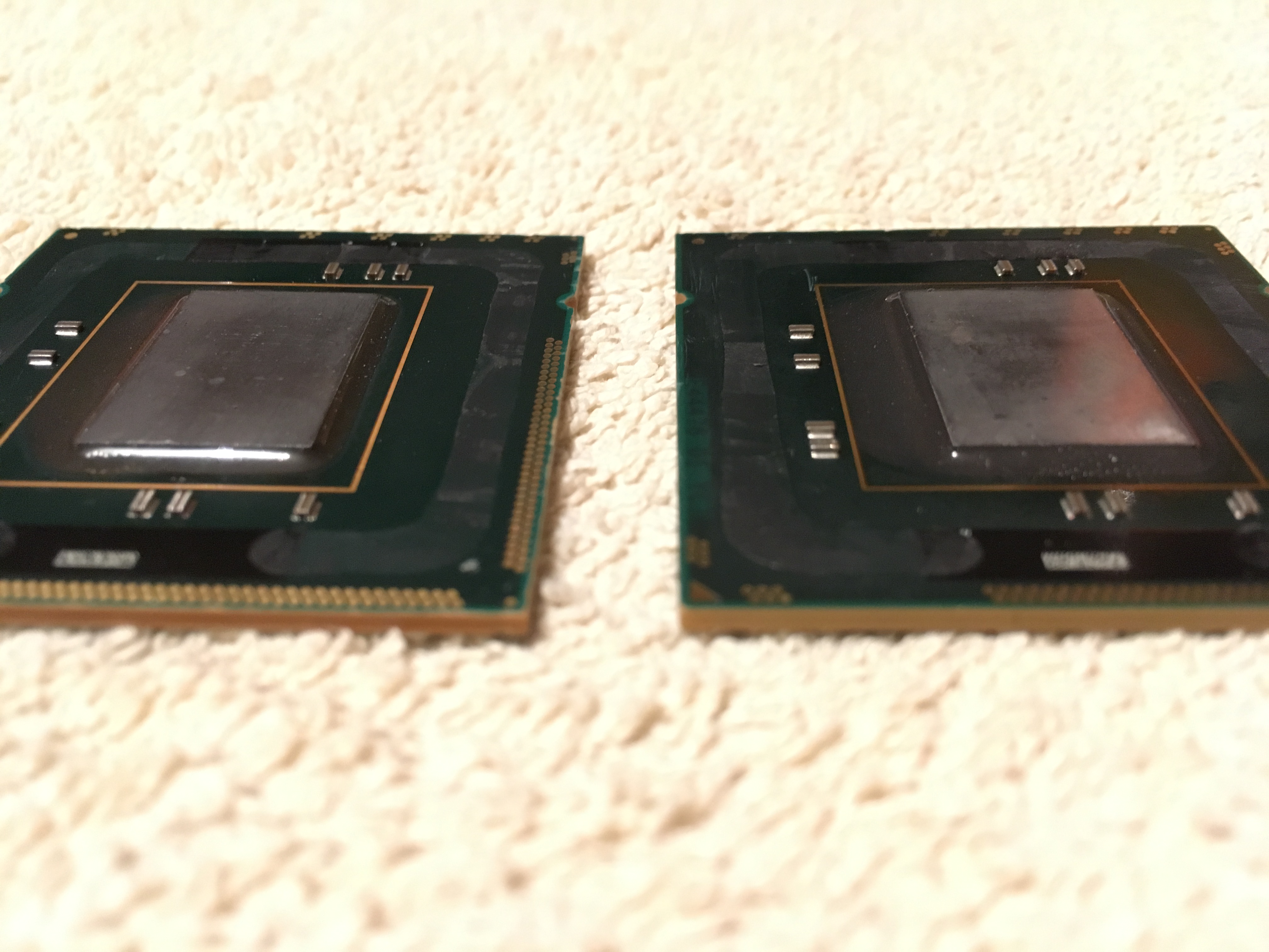

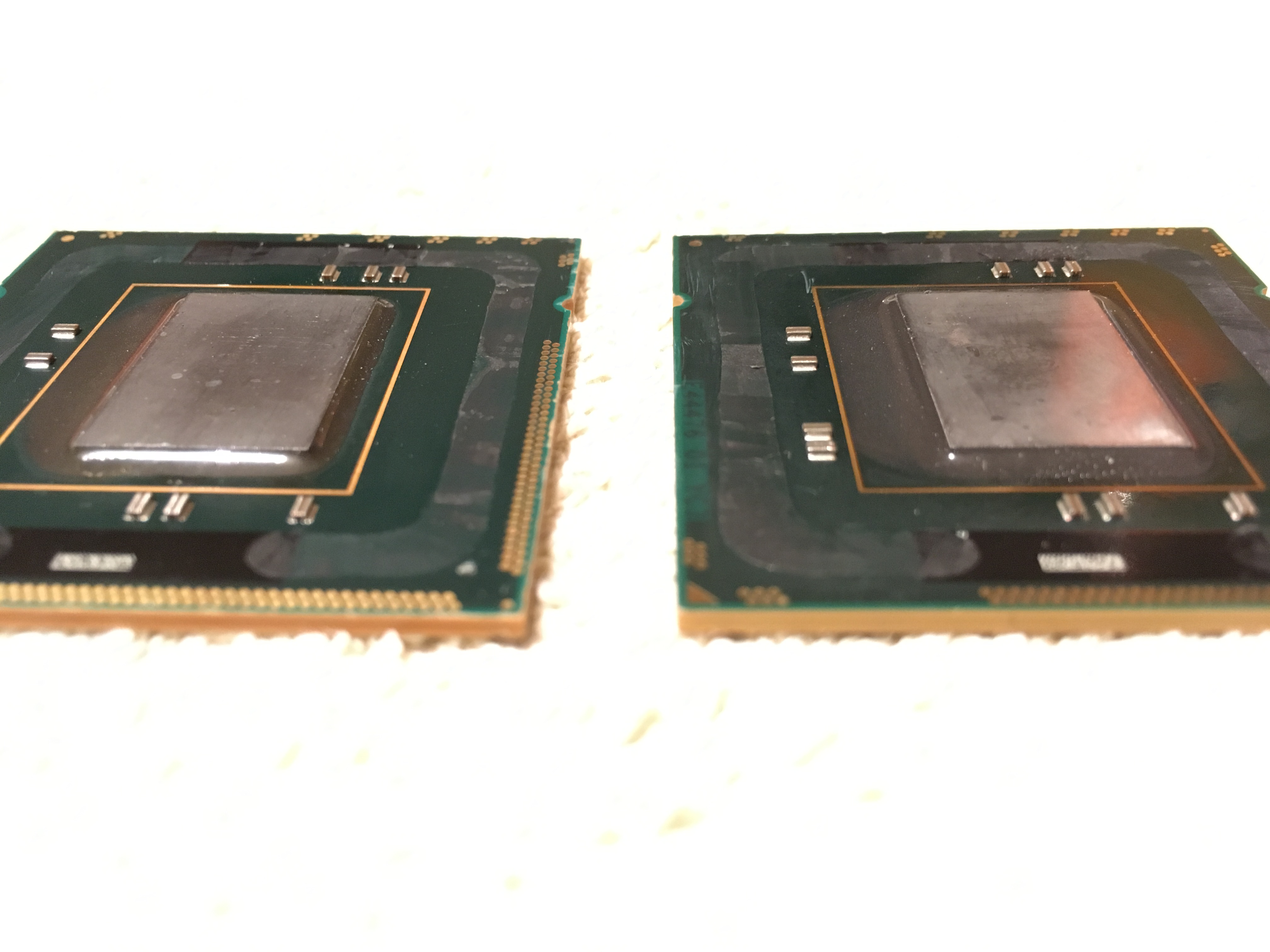

Here are some pictures:

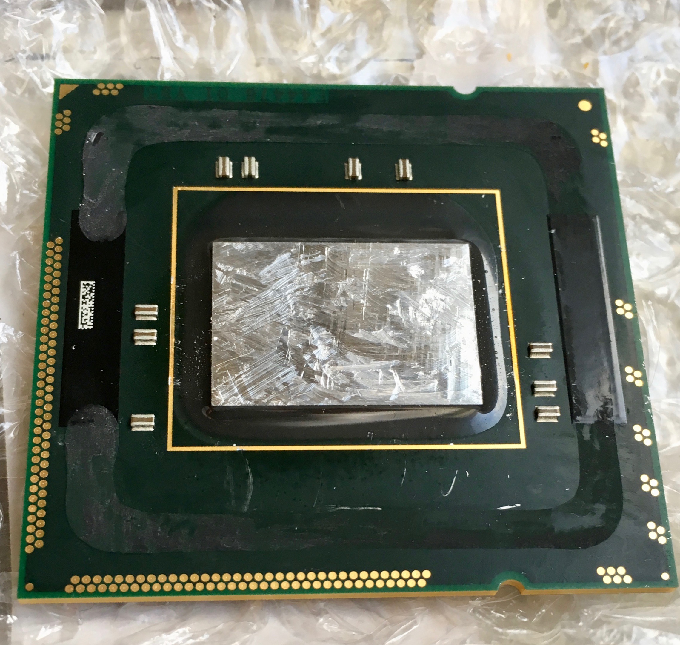

- seconds after delid with vice
-best credit card shine i could get

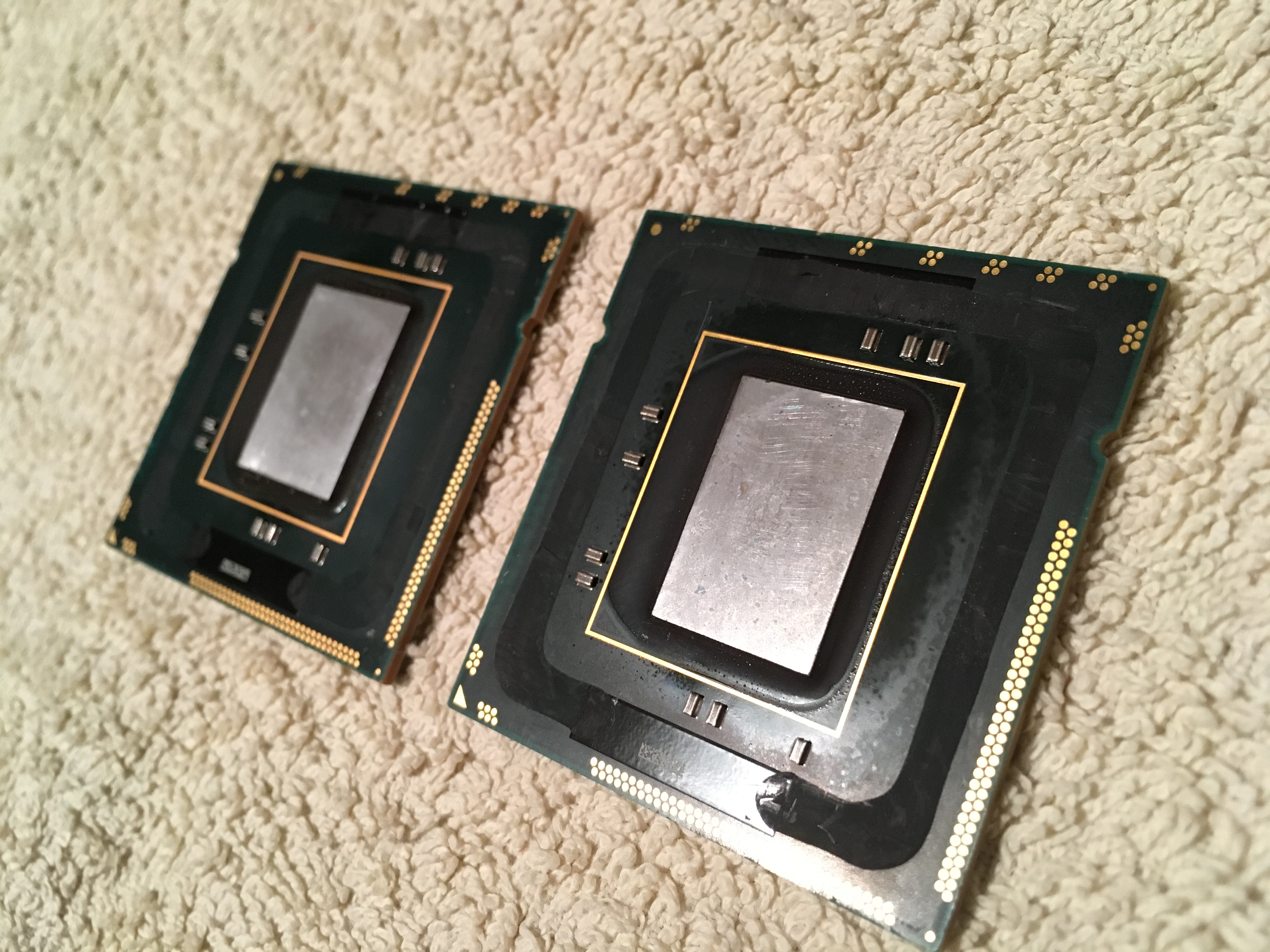

- eraser polish™
-Tools used

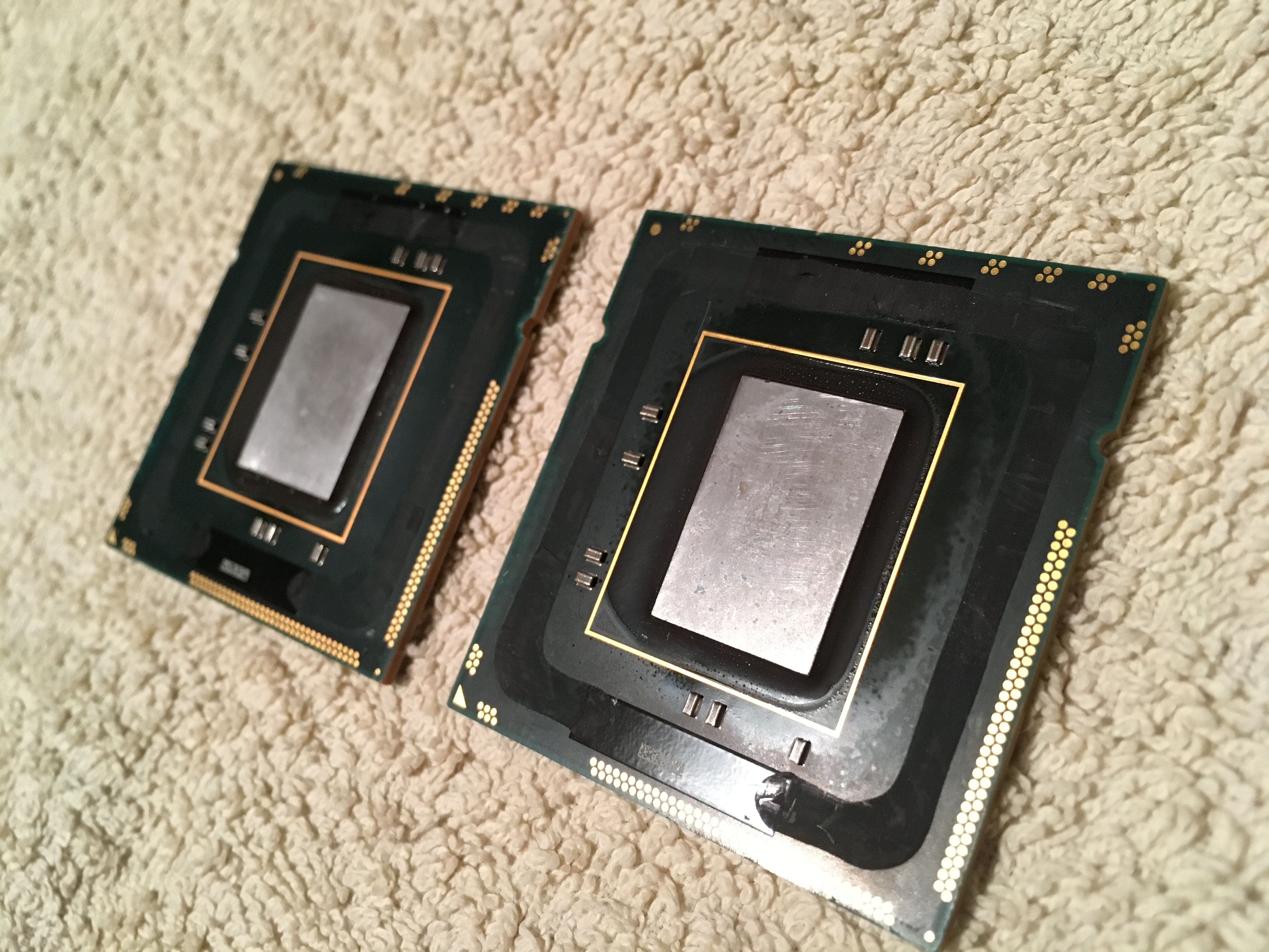

-Final pass with cloth for cleaning silver
Yeah that looks good owbp. I used a credit card and a spludger to remove the excess solder, and then used very fine 600+ sandpaper to remove the remaining solder **very carefully**.
If using sandpaper:
• Wrap/tape/secure the sandpaper to a solid block so that the sandpaper doesn't move.
• Only move the sandpaper one way across the CPU surface – don't rock backwards and forwards as this could result in an uneven surface.
