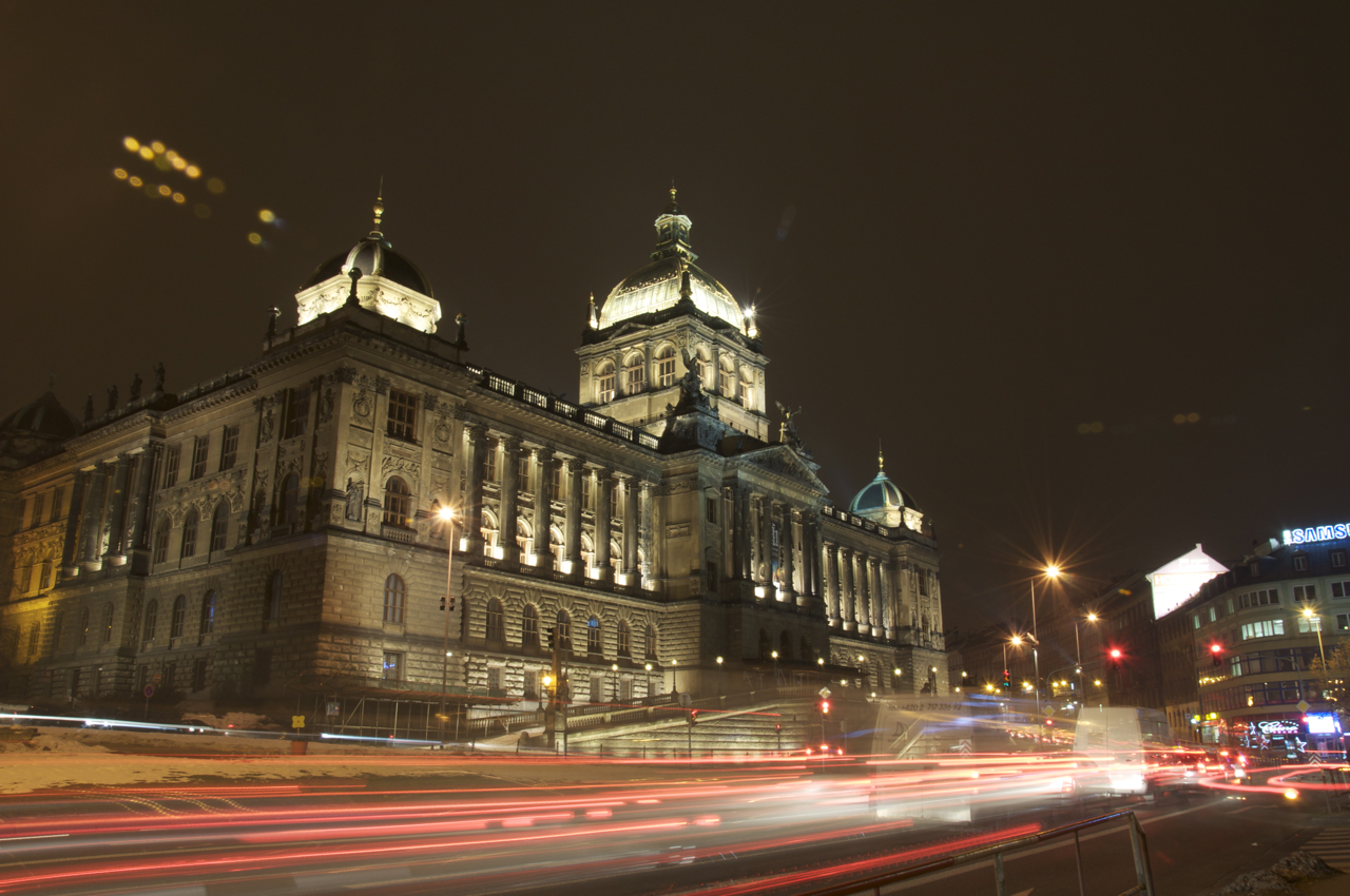

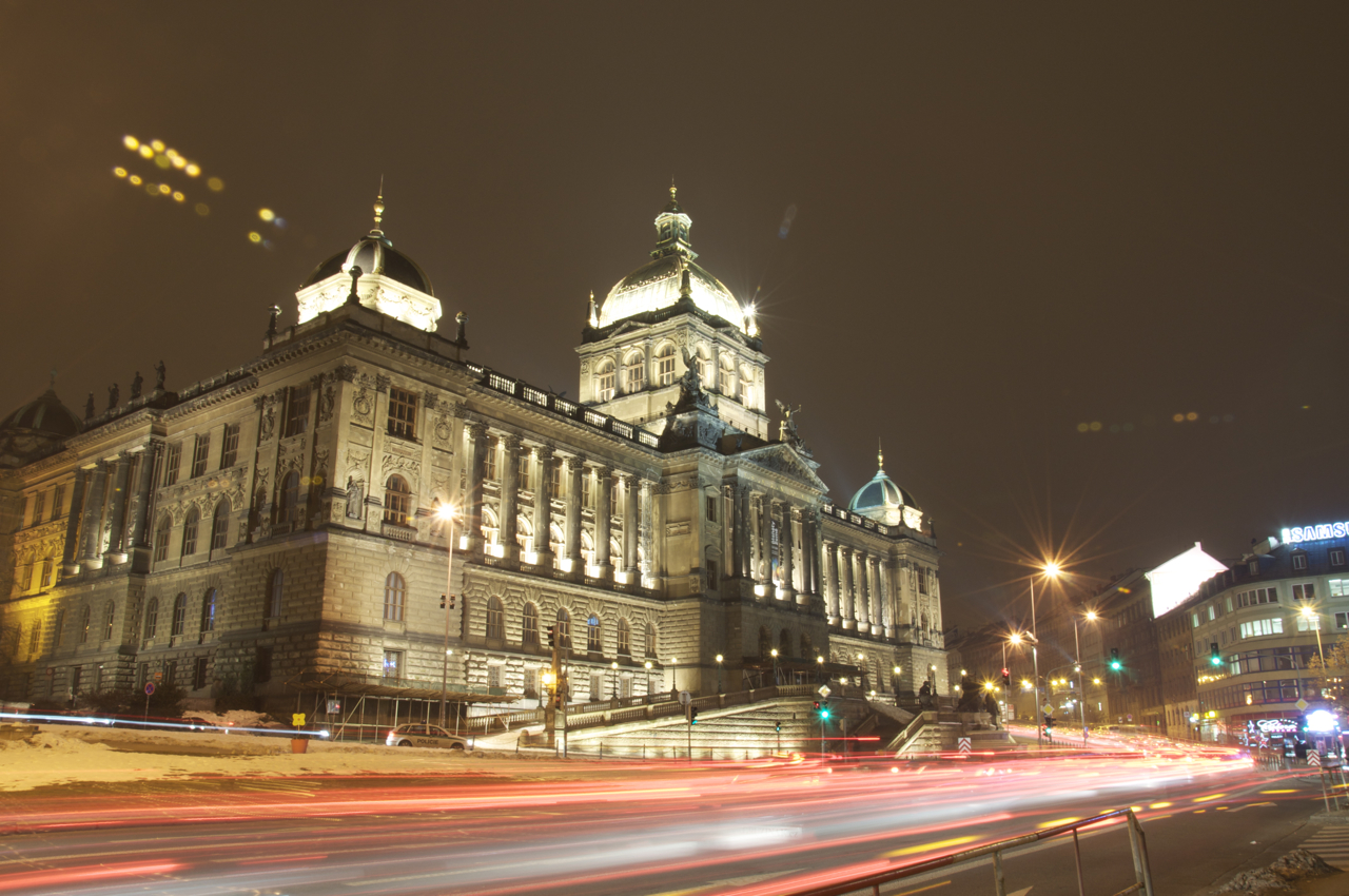

I went out for my first ever night shooting with my friends tripod and the results are not so good. I tried to do both - aperture preference and set it really high (22 i believe) or shutter preference and i set the time between 30secs to 20 or so.
This is probably my best shot but it still doesn't look so sharp and nice. What did I probably mess up or what do you think I overlooked?

Can you convert those to jpegs and repost? I don't really want to download and fiddle with the raw files.
Without having seen them, you probably don't want to be shooting at f22. F8 should give you all the depth of field you need while still getting the camera light.
If they aren't sharp, you're most likely getting camera shake during the long exposures
I can view them in OS X preview but they won't open in PS CS4. What camera did you shoot with?
In the preview it looks like they're a bit unsharp to me. This could be due to the lens or the camera. It is not completely lacking sharpness.
I haven't looked at the photos, but what kind of tripod was it and how did you release the shutter? On an inexpensive tripod, the camera can move a bit, especially if there is a breeze. This matters on long exposures. Similarly, manually pressing the shutter release button can shake the camera enough at the start of a long exposure to cause some fuzziness.

I set the camera to delayed shutter so I pressed the button and moved away so the camera doesn't get any shake from me pressing it. After 30secs ( I think) the shutter opened and then closed accordingly to chosen speed.
As I don't have remote release I thought this would be the best approach to minimise the shake 🙂
Its not that unsharp, how ever I would perhaps looking at manual focusing when doing this. Are you using a cheap UV filter as well? As it looks to have created some nice ghosting on your images?

You bought a DSLR (presumably) so you could take better pictures. Take the cheap filter off and save it for days when you are in blowing sand.
How often does stuff touch the front of your lens? If you really must have something, a hood offers protection and can help reduce flare, put your money there.
If you want a polarized filter for a specific reason get one, but it is not a great filter to leave on your lens (and again, cheap=crappy images). Unfortunately good filters will cost about what your kit lens is worth, I would avoid filters for a while.

Don't throw it away, but take it off for a while and use a lens hood. If your wondering what those stray bits of light in the top left hand corner is, its your UV filter causing it. If you want to use one, get a more expensive multi coated one.
As for a polarising filter, have some research into what it does and how or why or when to use one. Nothing wrong with being cautious, but the hood will give you great protection.
EDIT: Forgot to say, manual focusing is easy when using a tripod or a still moving object. Just switch the switch on the side of lens from AF to MF and have a play!

Also did you have VR or IS on? If you did turn it off. It will try to correct something that is not there, camera shake, since you are using a tripod. It is also very possible headlights from oncoming traffic interfered with your focusing. If available, go back, and try manual focus, no VR or IS, UV filter off. Experiment, I take tons of photos, and remember to use the on camera zoom to inspect your photos for focus, sharpness, glare, ghosting. I'm not a pro, but it sounds like your problems are very simple to fix.

I was going to blame traffic vibration. A good tripod helps, VR won't help. But I suppose it depends on the local traffic at the time. I remember Prague being like a race-track during the day, but at night it was only the taxis that were setting land speed records.

It may look less than sharp as well because the camera does not apply sharpening to the file. You have to do that in your post processing yourself. The camera does it automatically for jpegs.

This is a little better. And I cropped it, the blown out side of a building was very distracting. I'm at work but I think I can remove the flare or whatever that is at home with better software. I only have ViewNX at work.

Nobody has mentioned what is most likely the real cause of the problem.
The OP stopped down his lens too far. As you stop down more and more, diffraction effects will cause the image to lose sharpness. This is not a gear problem, it is caused by fundamental optical physics. If you do a google search for the subject you will find explanations better than I can summarize here. As a general rule in my experience you'll start to notice loss of sharpness in your image if you are stopping down past around f/16 on a DX body. Things like this are a good reason to become familiar with depth of field calculations and hyperfocal shooting, in order to prevent excessive stopping down when not necessary. Sometimes you can't help it but sometimes you can, and I think this was one of those times when you could have.
Anyways, beyond what softening there is from diffraction, the following may have contributed to the soft looking RAW:
-Focus. Make sure you're selecting the right part of the image to focus on, such that you are not wasing your depth of field, and that it is correctly and accurately set.
-Lack of post processing. Looking at the NEF there will be no sharpening applied. I'm sure once you post process these shots and apply some sharpening, you will be much more impressed by the result.
Because you were wondering, here's a good checklist for tripod usage:
1) turn IS/VR off (unless your lens has a VR mode specifically for tripods, as some do)
2) do not extend center column unless necessary
3) extension on 2, do not extend legs beyond what is necessary (#2 and #3 are especially important for cheap tripods whose stability is not the greatest)
4) Use mirror lock up (or exposure delay mode as it should be called on the D90)
5) use delay self-timer if you do not have a remote release. I use 2 seconds which is plenty if your camera is properly stabilized and you use a gentle touch on the shutter button.
6) if there is going to be wind or environmental vibrations that might affect image sharpness, try leaning on your tripod a little to put some weight on it and help keep it stable. Or if available, hang a bag with some rocks or sand from the tripod to increase its weight. This will help keep a tripod steady in a windy shoot so long as your tripod is stable and of good quality.
Regarding the lens flare. The UV filter definitely was not helping here! If your lens came with a detachable hood, that will probably protect your lens against damage better than the filter can. If you will be too bothered by shooting without the filter then leave it on but be cognizant of situations (like this) when it will cause flare, and remove it for those shots.
