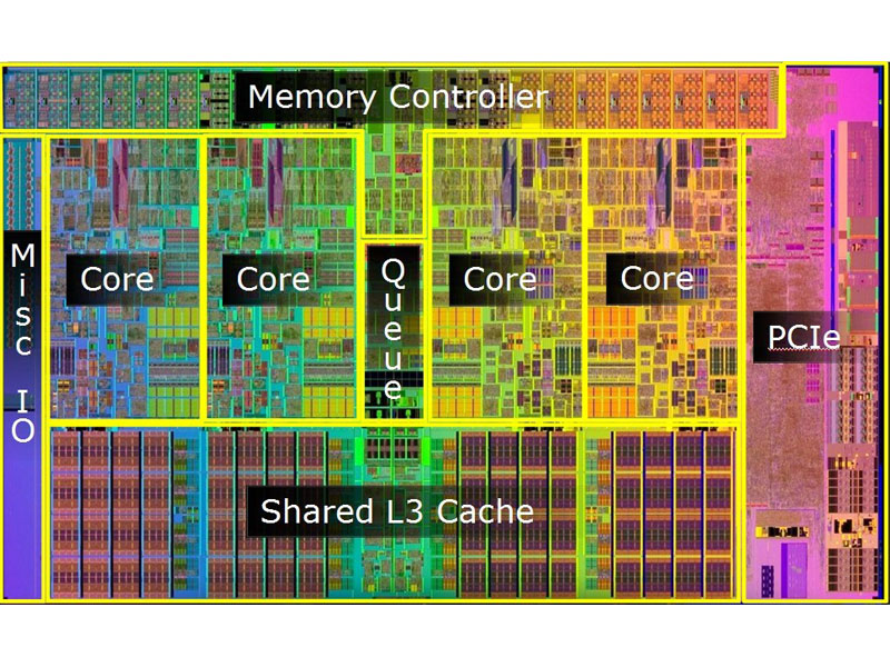

A multi-core processor is almost literally more processors. Here is a die shot of an Intel Core i5 Quad Core:
You get four execution cores instead of one. Four instruction decoders, four banks of L1 and L2 cache, and in this case a thread for each core (as this is a quad core i5).
How does a single thread processor compute multiple tasks at once? It is abstracted in software. The operating system manages what goes on the main thread, when, and with what priority. This is why in an older OS (classic anybody?) when you pulled down a menu, everything just stopped happening... the OS was not capable of managing multiple tasks properly. Everything just had to wait.
Sometimes having multiple threads doesn't get you anything. Many applications do not support multiple threads, therefore the OS can only do so good a job splitting up the workload. Two threads can still be useful with single threaded applications because all of the background tasks can be put on the second thread while the app consumes the entire first thread.
However, sometimes having many threads gets you a lot. My profession involves a lot of 3D rendering, which is highly parallelized. This means that each thread can be given its own full workload, thus allowing the render to be completed many times faster.
If we are talking threads though, a complexity comes up. Something that has actually been around for a long time: Hyperthreading. Basically, what happens if the chip is very fast, and you cannot get enough data to it on one thread to saturate it? You end up wasting processing power. Hyperthreading takes each real physical core, and abstracts it so that the operating system sees two threads. The operating system can then load tasks on to two threads, and so the extra potential of the core is unlocked. In the case of Core/Nehalem, the wide front end of that architecture is better served by multiple threads. They are not a replacement for a real core, and the speed boost is ~25% on a good day. But that is performance that would be lost otherwise.
Why does the i5 quad core only have four threads (no hyperthreading), and the i7 quad core have eight threads (hyperthreading)? Marketing, pure and simple.
