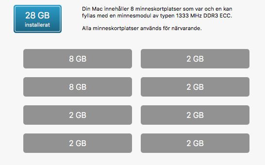

@ActionableMango: Yeah the ram is OK, it is according to Apple.
