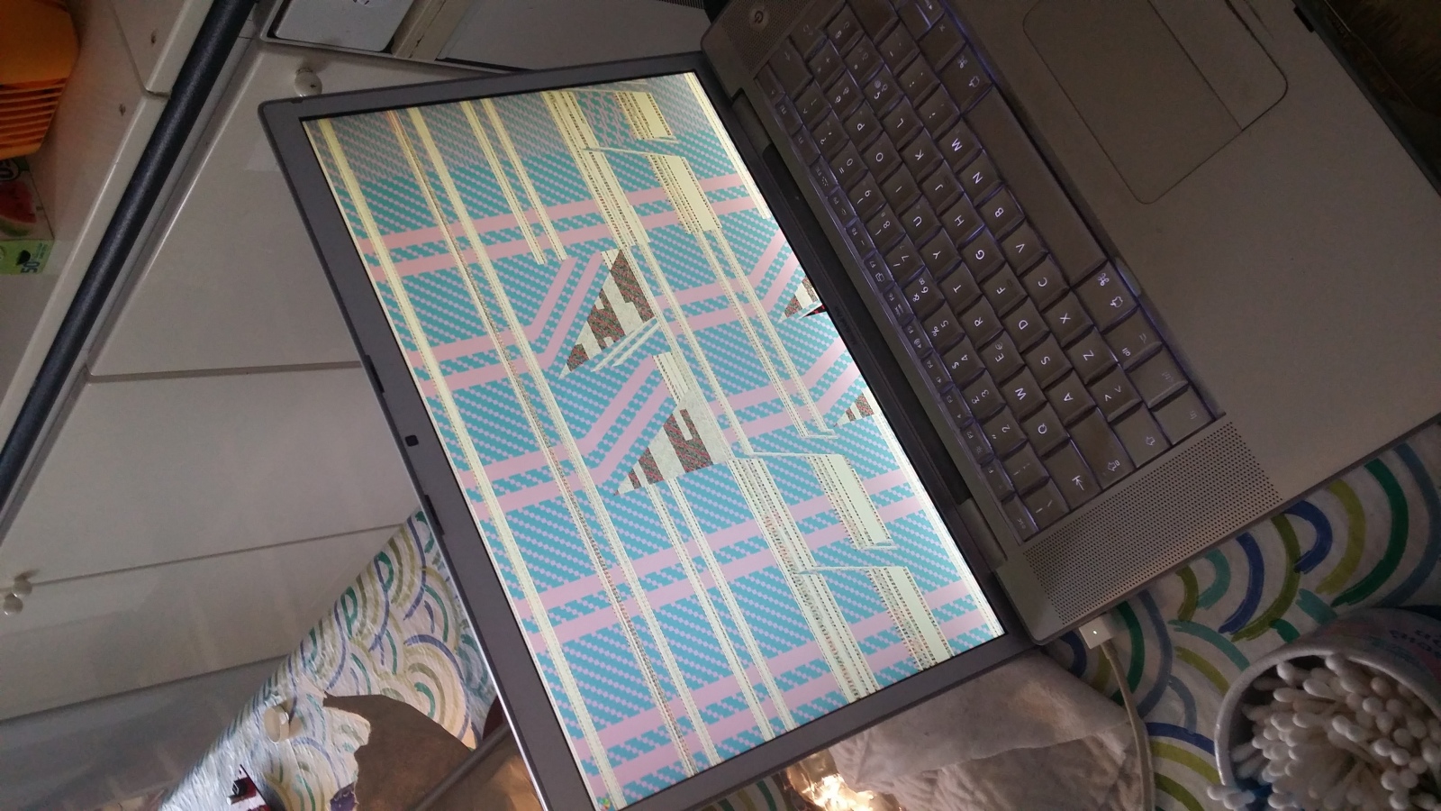

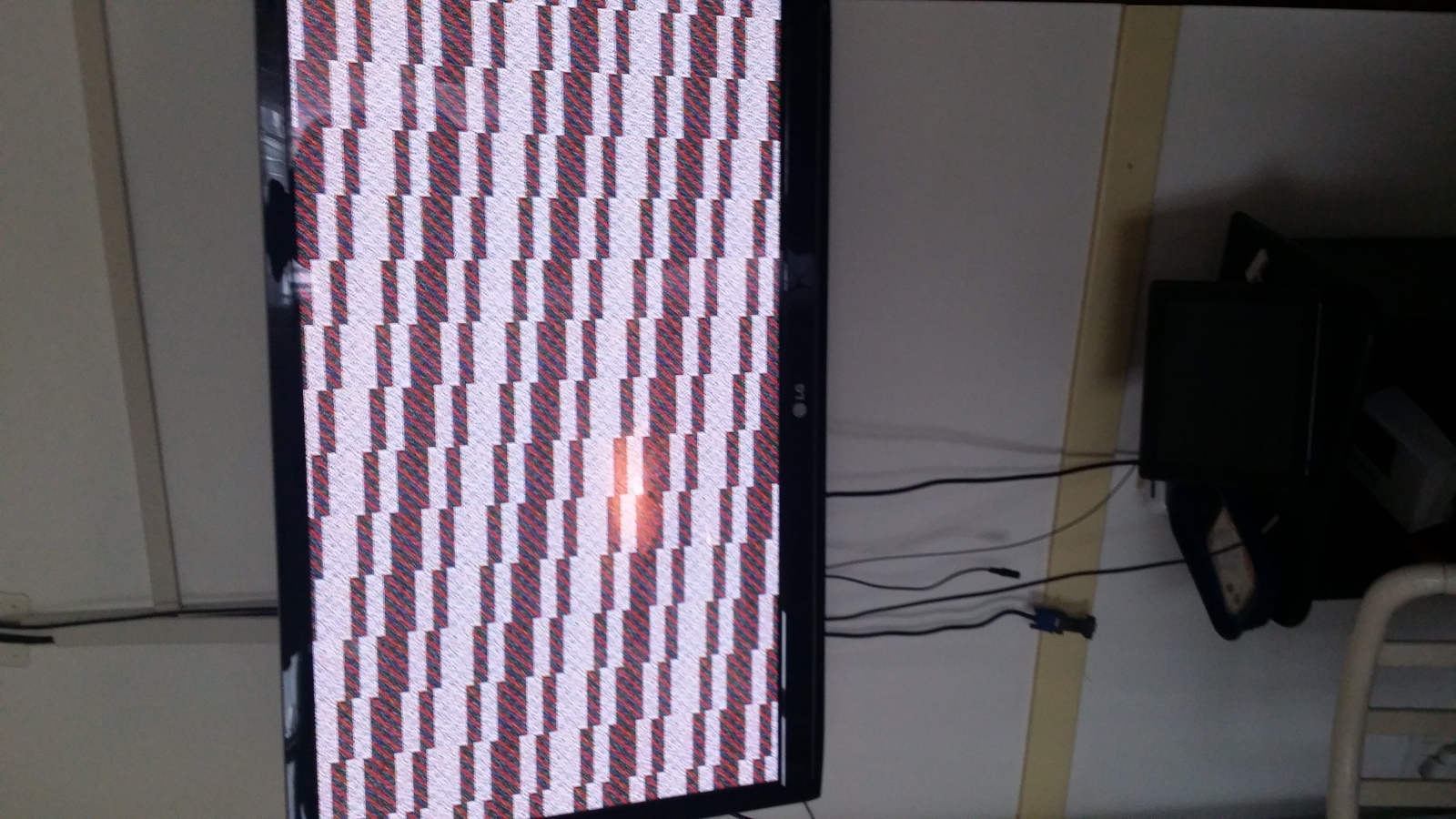

As soon as I replaced mine, I got more or less the same problem...
have a look
(sorry about the pics...)
So what do you think?
I istantely thought it could be my fault because of all the times I removed my logic board... perhaps I damaged something... but after I thought that all the connectors on the logic board have nothing to do with this problem...
fans, thermal sensor cable, iSight, battery connector... the inverter too because it might cause the screen to go dark and not this!
So... do you also think this logic board came already damaged like I do?

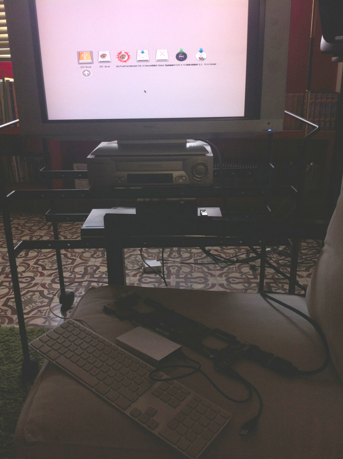

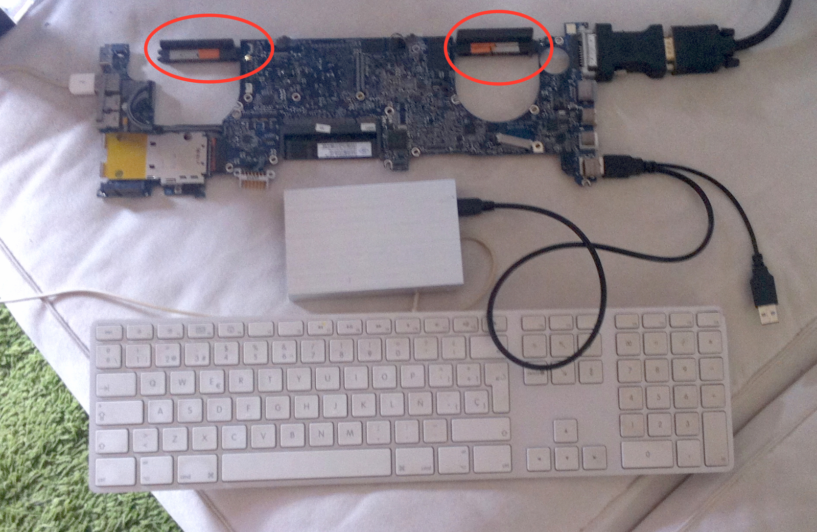

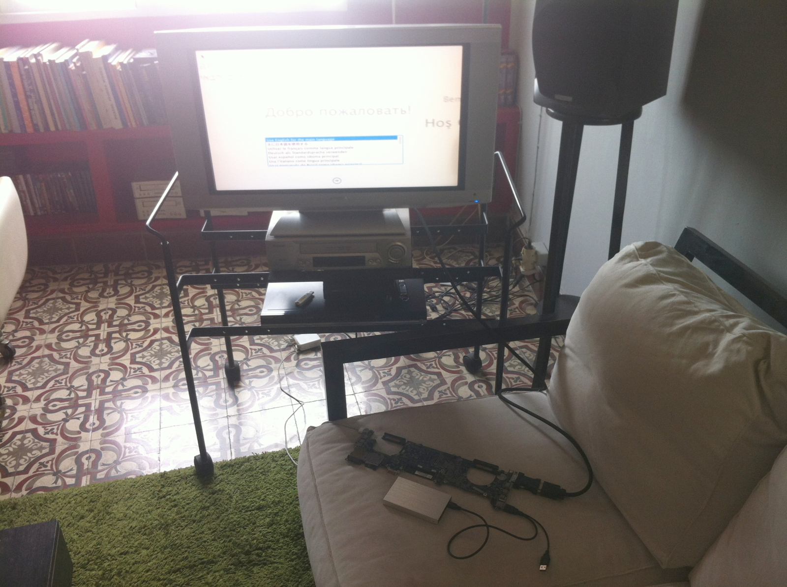

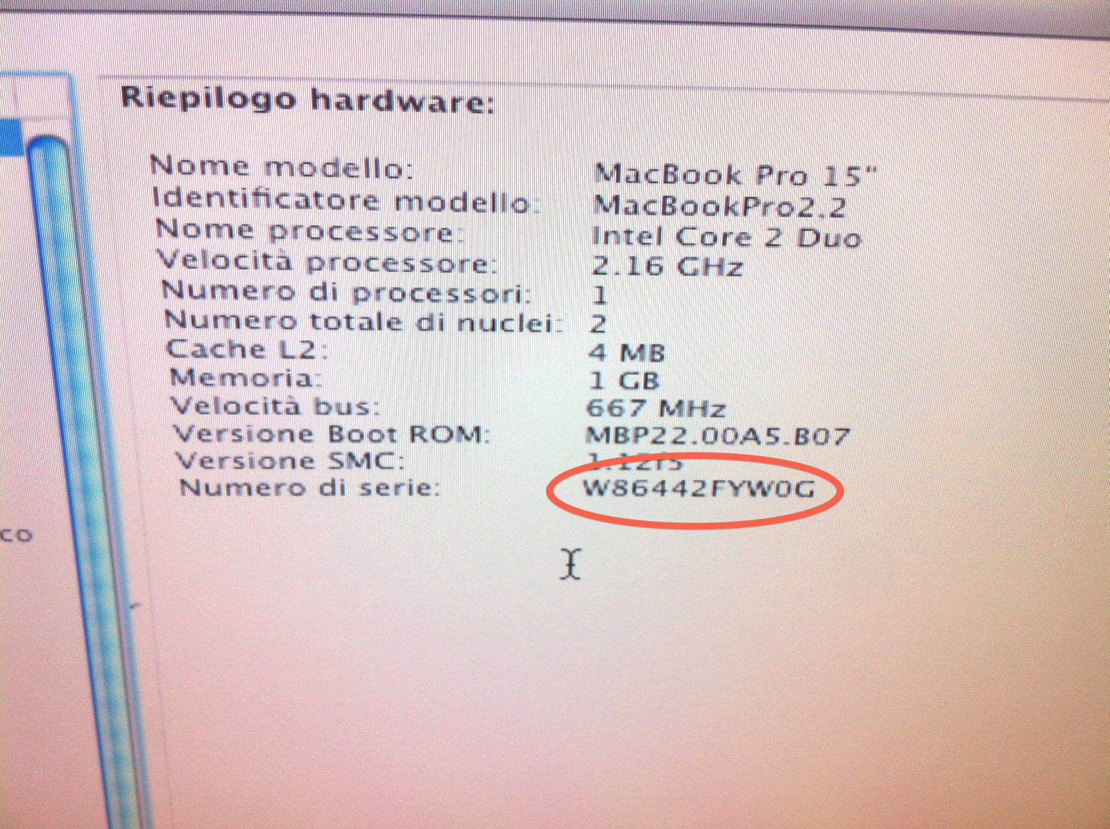

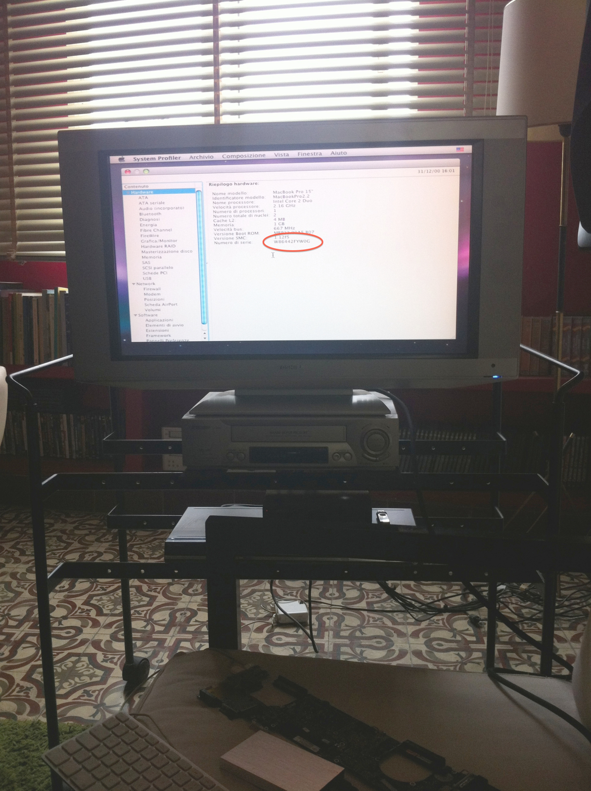

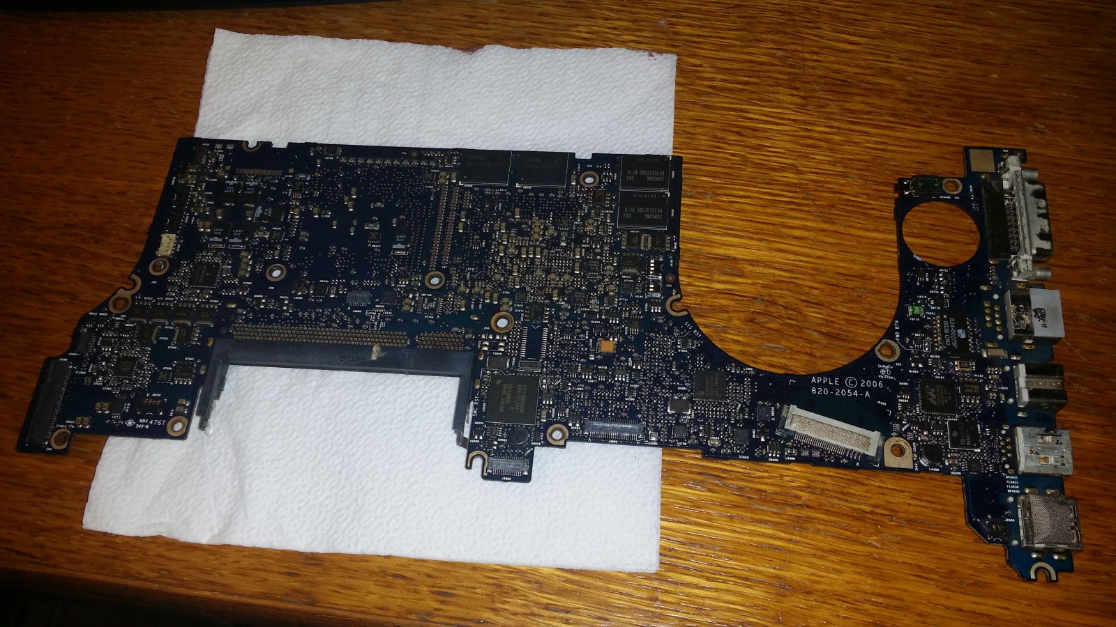

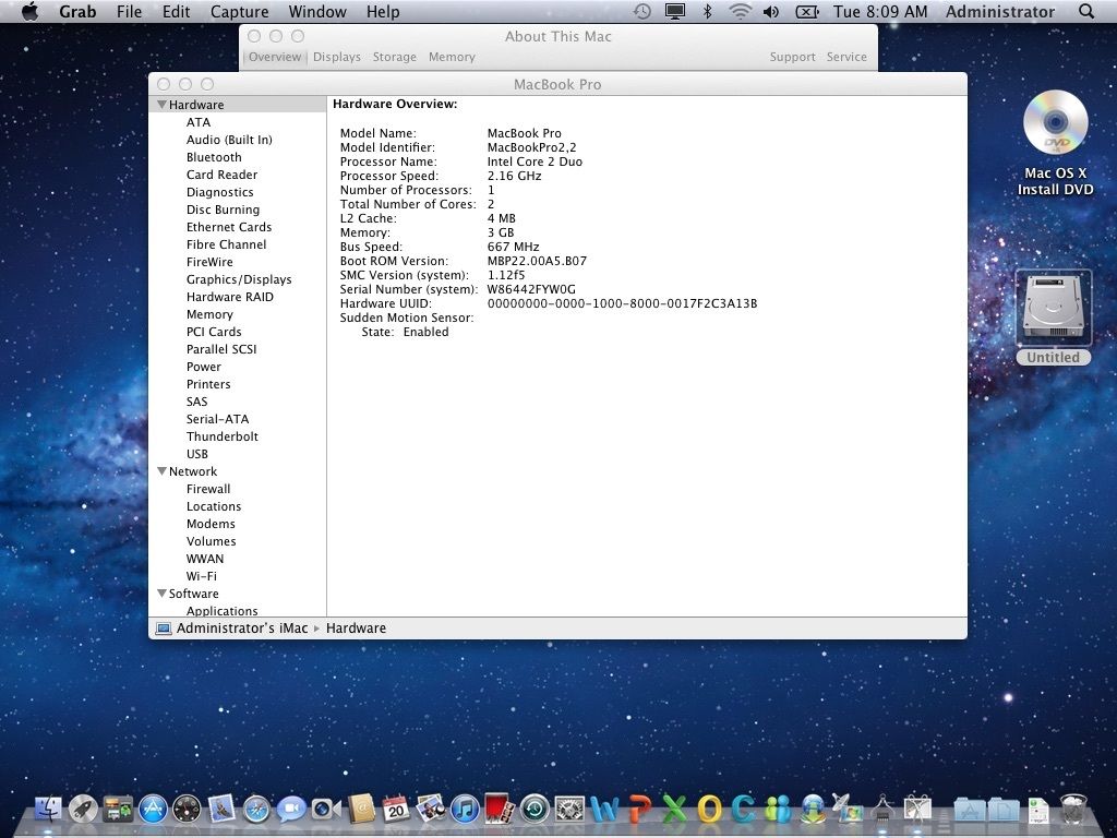

He keeps saying that the motherboard works and sent me these pics
First af all: did he really connect the motherboard without cooling it? (risking more damages too!)
How in the world might my computer cause my problem to happen if the motherboard really works?

No I didn't.
I connected it to the lcd panel of my MBP and to my TV.
I never connected it to my TV only. Neither I thought it was possible to do that BTW!
Are you thinking that my panel has some problem and it was mirrored though? Is there even possible?
But you have seen my previous pictures!
Those are the tipical pictures of that famous GPU problem as also iMacC2D said!
How in the world could it happen?
And did he really connect it without cooling it?
Is there really a very little tiny possibility that something in my connectors or in my lcd panel might have caused that problem?
Is there a technical explanation in order to explain that?
Also 0,1%?
It's really unbelievable... I don't know what to think...

None of those boards on the market are actually "known good" from a diagnostics point of view, who knows what temp or slight physical change (twist etc), the board undergoes when fitted compared to just open as he shows it.
The point is that your machine has the same symptoms, a logic board is still indicated, you are E40 poorer but still have the same decision to make.
Given the symptom, no I don't think that is a connector issue and no, I don't think it is a more complicated screen-mirroring issue....that looks exactly like the known graphics problem.
Its a lottery on getting another board that is good.

The pictures the seller sent you showing the board on the couch are fake. The biggest hint being that the board on the couch doesn't have any visible method of power being provided to it. No AC adapter plugged into MagSafe port, and no battery connected anywhere. Probably other bits that could also point to it being a scam if picked apart further, but those were enough to convince me that the seller is scamming you.
Netsurfer
macrumors member
Oct 13, 2009
50
10
my god you're right I didn't see it was the keyboard
but please have a look better, in some photos it appears to be the MagSafe, doesn't it?
the light is on too, isn't it?
duervo
macrumors 68020
Feb 5, 2011
2,307
1,032
Never mind I see the plug in the other pics now. Missed it before ... Lighting was poor in the pictures.
That's still not enough to convince me that the seller isn't trying to scam you though.
They could easily have another MBP of same model sitting out of frame that's in working order.

When he sold it to me, he said the logic board came with a MBP that had the screen broken.
Now I asked him to connect it again to the panel and put it into the original case.
It doesn't matter the screen is broken... at least we see what happens with the logic board inside the case and with the video cable connected...
I hope he can do that...

He just answered he did use the heatsink with thermal paste and sent me this pic
This is my "nude" logic board guys, I have made this photo right now.
That one that is broken and because of which I looked for another one.
What do you think?

Guys, I noticed another thing...
In the original auction, why is it called iMac (down, on the left)?
Does it depend on what he used to connect it?
simonsi
macrumors 601
Jan 3, 2014
4,849
716
Auckland
Likely just the machine name derived from the installation on the external disk he booted from.
