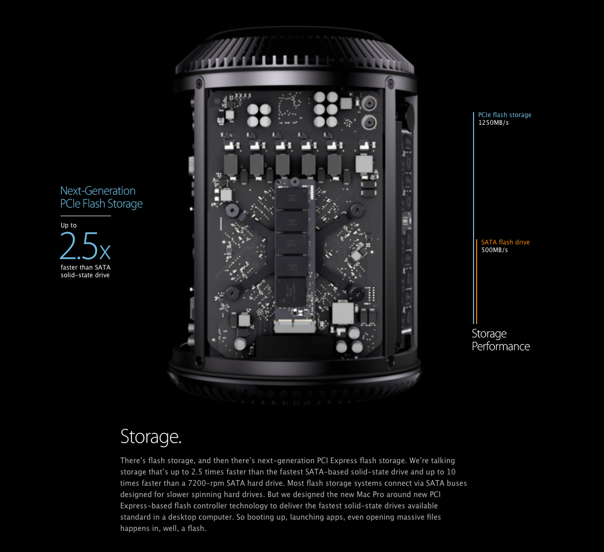

Apparently it will be in the new Mac Pro. Think it will it be replaceable?
Does anyone have a comparison with SSDs? SSDs have a life expectancy because after a while you can only read, but no longer write on them, what about this new PCI Express flash storage, does it also have this crucial flaw?
Thanks!

From the picture, it looks like it should be replaceable. All disks will wear out from use over time. Under normal use an SSD should last several years.

What they showed in their images is either an mSATA or an NGFF drive. I think they're about the same. One is a little wider and used card edge while NGFF is pretty new using a BGA instead. NGFF is also known as embedded micro SSD, µSSD, or uSSD.

What they showed in their images is an mSATA drive AFAIK.
It's a PCI-Express Flash controller based Flash storage.

OK, I see. Yeah, from Wiki:
mSATA
Mini-SATA, which is distinct from the micro connector, was announced by the Serial ATA International Organization on September 21, 2009. Applications include netbooks and other devices that require a smaller solid-state drive. The connector is similar in appearance to a PCI Express Mini Card interface, and is electrically compatible; however, the data signals (TX±/RX± SATA, PETn0 PETp0 PERn0 PERp0 PCI-express) need connection to the SATA host controller instead of the PCI-express host controller.

On the storage front, Apple officially leads the charge with the move to PCIe based SSDs.
The upcoming Mac Pro, as well as the new MacBook Airs both use PCIe based SSDs instead of SATA drives. A quick look at OS X's system profiler reveals a PCIe 2.0 x2 interface, capable of 1GB/s in each direction.
Regarding M.2
I'm still awaiting official confirmation as to whether or not this is an M.2 based solution or a proprietary connector. Since there's no PCIe routed off of the CPU in Haswell ULT, these 2 lanes come from the on-package PCH
