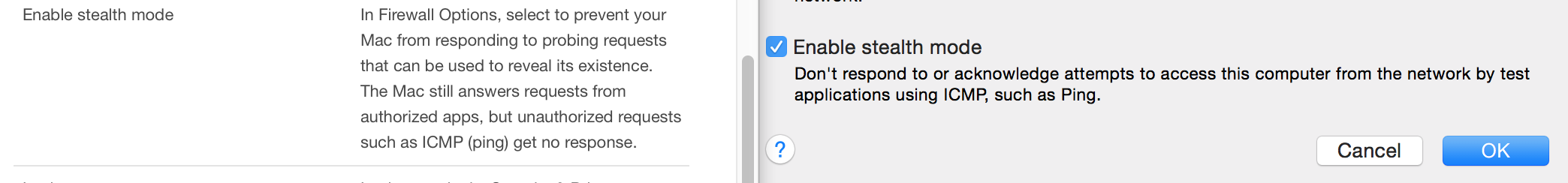

Hi, what does the stealth mode in firewall settings do? Should it be turned on? I tried doing a ping test from another computer to test and my mac did not respond to ping request even when the firewall is turned off. Same results when firewall is turned on but stealth settings are turned off. Does the stealth settings do anything other than that?
In stealth mode, your mac will not respond to ICMP (ping) requests. If your mac is not responding to ping requests when stealth is turned off, there is something external to your mac blocking the requests.

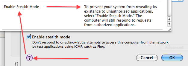

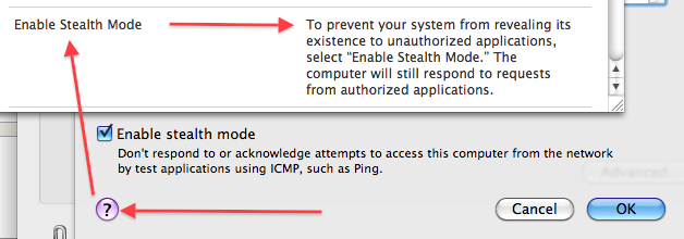

Did you try this?

That one is not checked. But still I do not get response to ping request on my mac's external ip address.

I was referring to clicking the ? icon to get a description of the stealth mode, in answer to your question. As for the ping response, have you checked your router's settings?
