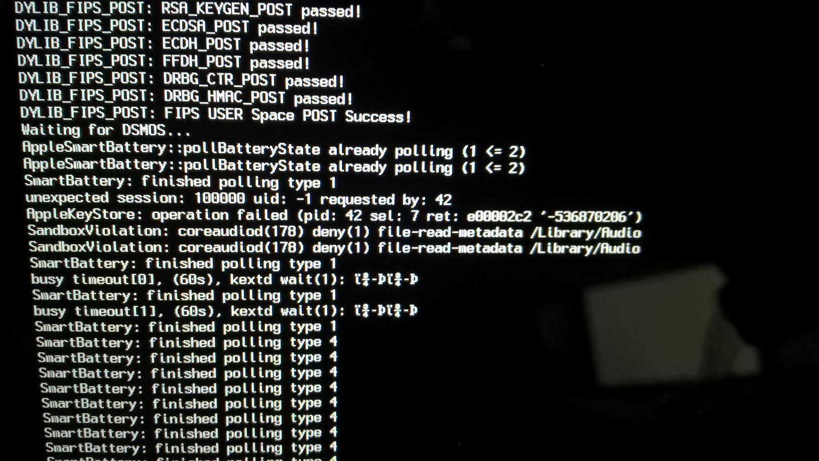

I am troubleshooting a non-booting OS X (Sierra) here and put it into Safe / verbose mode.
There is a lot of output from verbose mode but what should I be looking for in terms of finding
the problem file which is causing the boot problem?
There is a lot of output from verbose mode - what should I be looking for?

File uploaded now.
Hoping someone can shed some light on this.

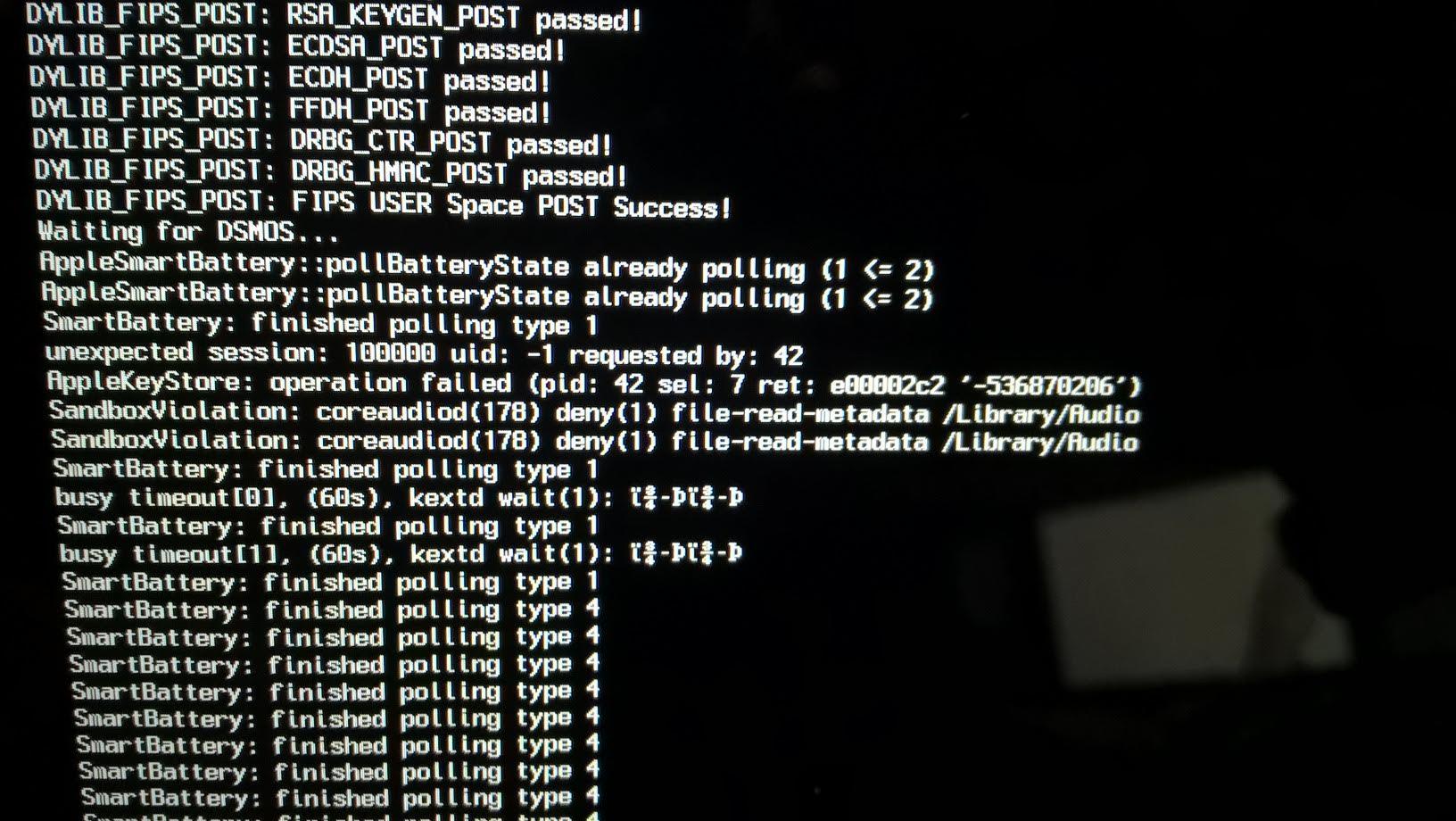

BTW, this is the screen where bootup halts.

File uploaded now.
Is that battery polling thing the last line it displays or is there anything after that?
A failing or failed battery will not cause any problems with the startup process.
More likely to be the 'kextd wait' line that's causing it.
Have you installed or updated any software recently? Does it start up or at least go further in safe mode? (Hold down shift when powering on)
no new software installed recently.
That is as far as system goes.
It is my suspicious also that the 'kextd wait' is the cause. Anybody know what this could be?
