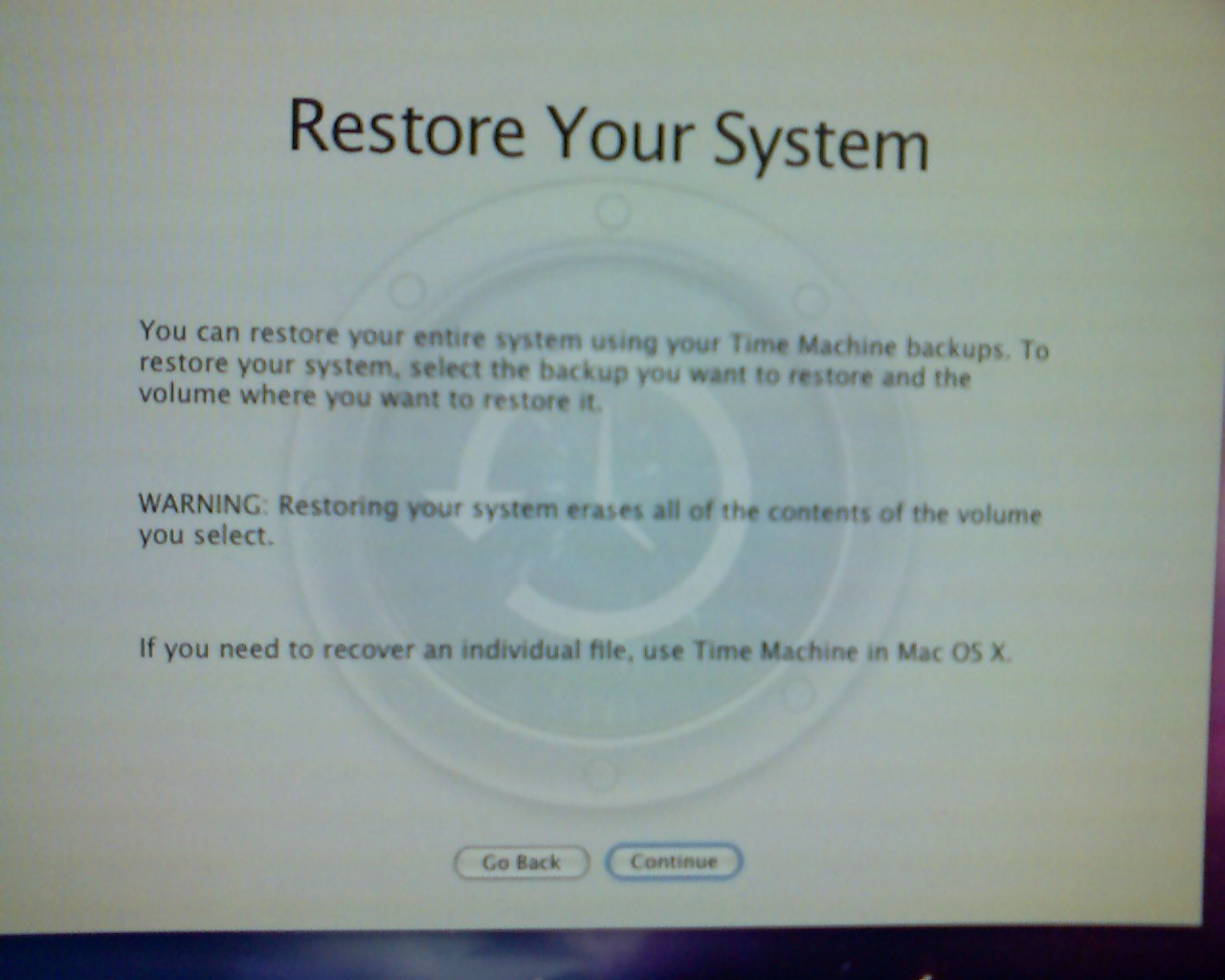

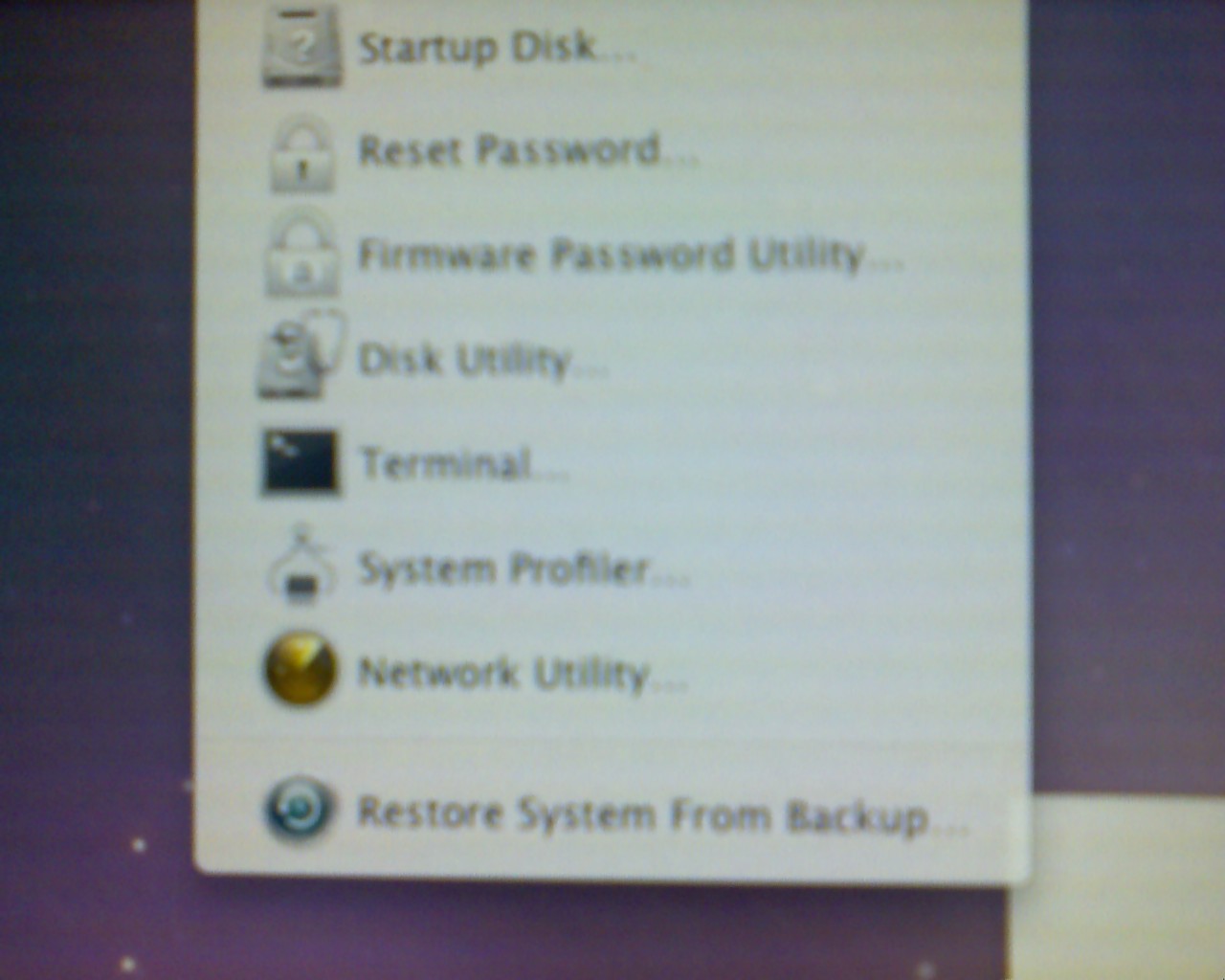

I think you can do a complete restore boot off your leopard CD i am pretty sure its in the menus i will double check this right now though.....😀
Just to follow up i just took pictures with my camera phone because i am too lazy to pull out my SLR.

Yes you could do that. Just have both externals plugged in. Boot off the OS X install do a bootcamp restore to the other external drive. 🙂
