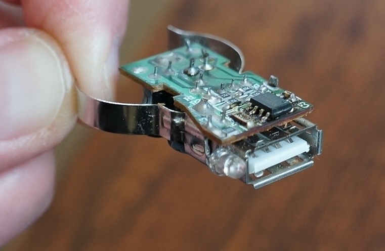

I have an iPhone 6. Bought in 2017, so only 1 year old or so.
Battery was working perfectly fine. I would get 2 days out of a charge with my level of normal use.
Then I charged it using the cigarette lighter USB charger, and it hasn't worked right since.
Now, instead of 2 days use, I only get 1/2 day. The battery drains four times faster than it did just the day before charging it in cigarette lighter. It's almost unusable now, because it drains so fast.
DETAILS:

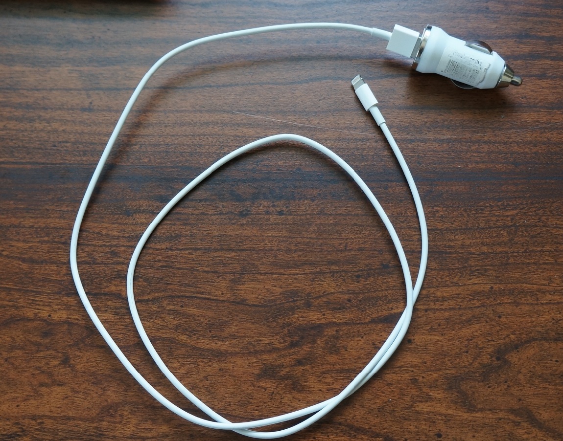

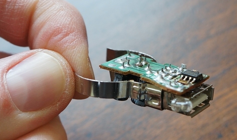

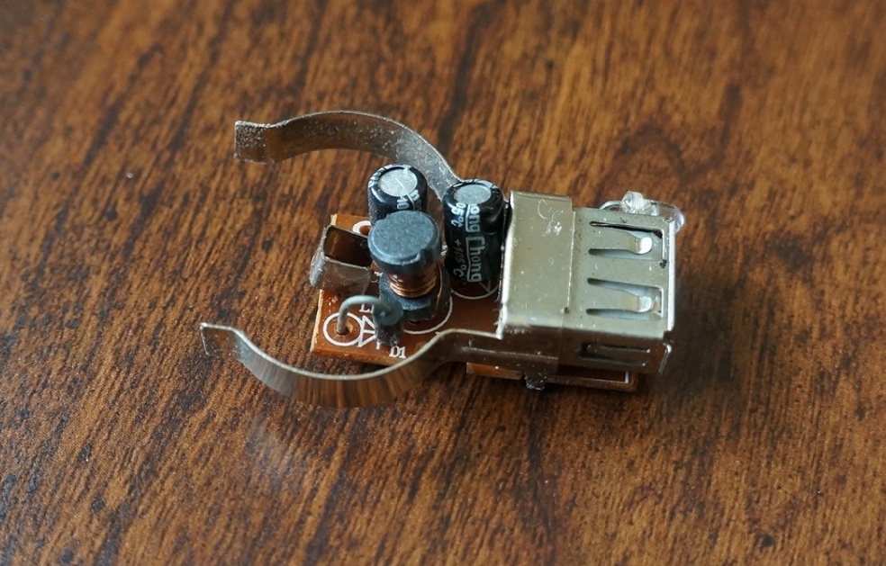

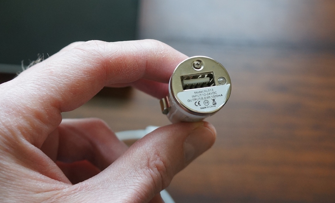

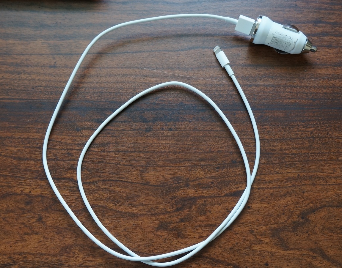

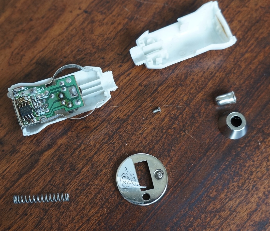

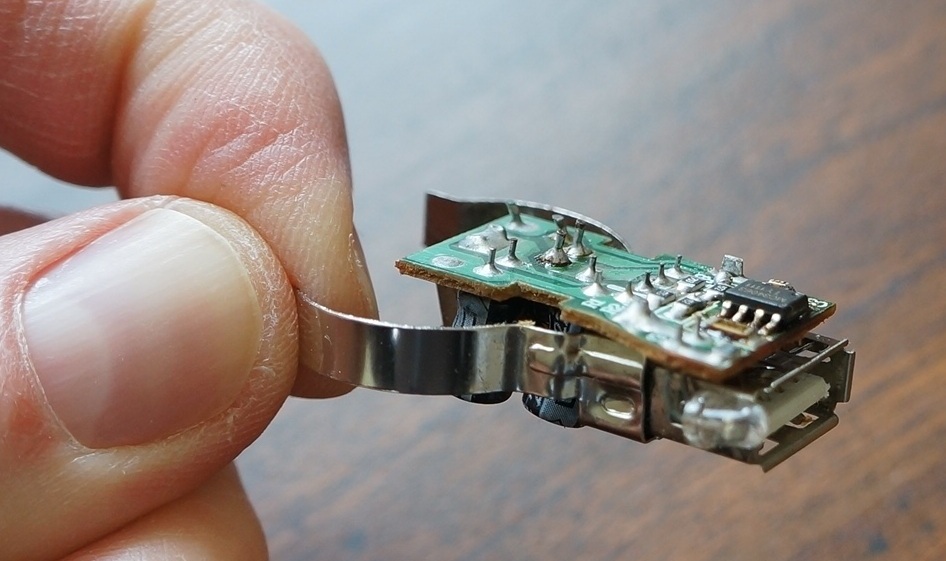

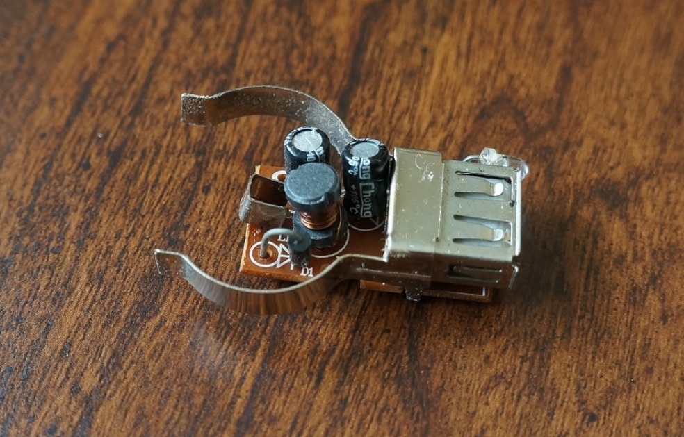

I ran out of battery on the road, and needed to take photos and use GPS. I was at 0% battery.

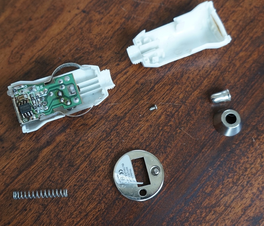

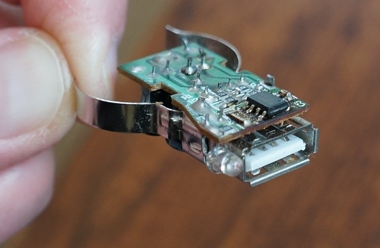

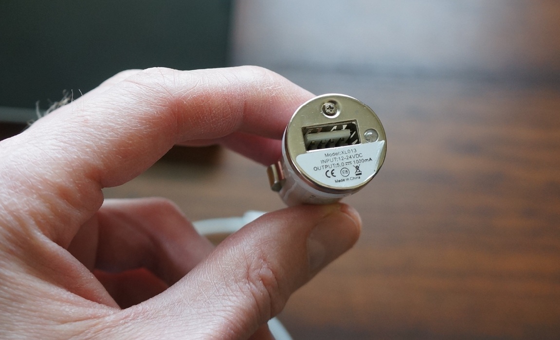

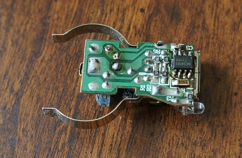

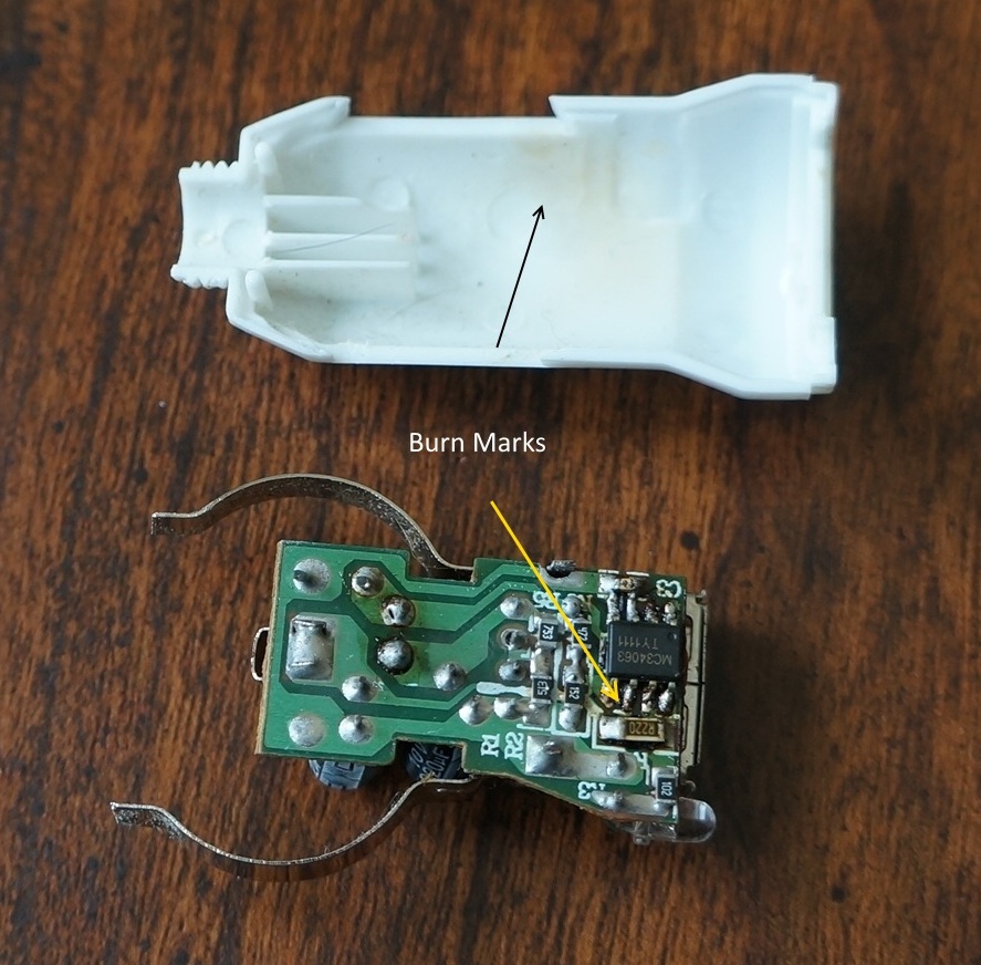

I charged it using the device in the pictures attached.
(takes a long time to charge it, I don't think it gets enough voltage or something this way).
It got up to about 5% battery.
Then I stopped to take photos. Battery ran out again.
Charged it to about 3% again as I drove.
Got out, took more photos. Battery died again.
Same thing. Charged to about 5%, then drained it again taking video.
Then plugged it in, used the GPS as I drove home.
Ever since, the battery's been dying 4x faster than normal.

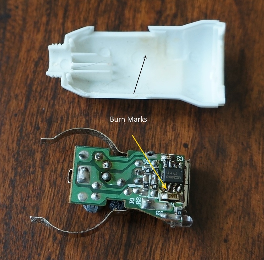

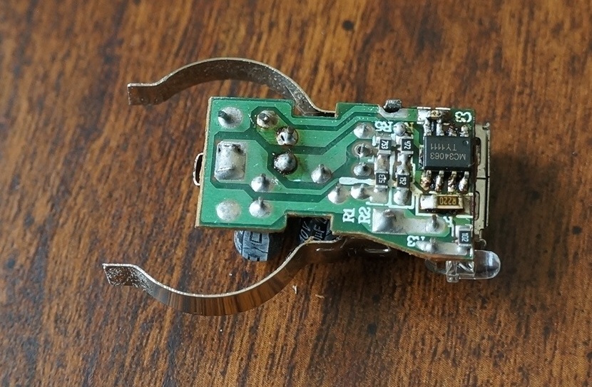

You burned the Tristar (U2) chip on your iPhone. This is a common problem using inexpensive cigarette lighter chargers because the voltage from the car is unregulated.
Don't use cigarette lighter chargers.
The chip (NXP1610) costs only $2-3 but the labor to replace it is about $100.

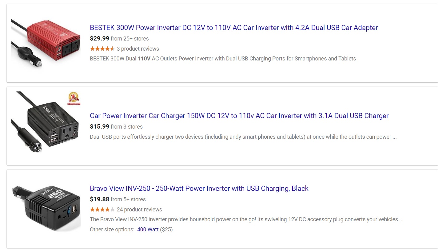

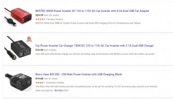

Lesson learned. I won't anymore. But if we do need charging in the car, would plugging the normal wall charger into a 110v inverter like one of these be safe?
EDIT: I see they all have USB slots in that picture, but I'm talking about using the normal three-prong outlet with the normal wall adapter on these.

Inverters
Using a cheap inverter produces a fake sine-wave. This risks damaging your Apple wall charger. A pure sine-wave inverter costs over $100.

If the charger let unregulated voltage into the iPhone, any of the power management chips can be damaged.
It's not a virus. You plugged your phone in a $0.50 charger and there's clear evidence the regulator was burned in the process. A virus these days will likely steal banking information while you use your phone. Not discourage you from using the phone so it can't collect data and send it back.
