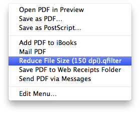

It seems that you are right. Putting a .qfilter file into /Library/PDF Services will add an entry to the Quartz filter menu when saving a PDF. However, it will also add an entry to the PDF options of the print panel which doesn't do anything (see picture). The better way would be to use the Filters folder instead, because then the filter will only appear in the Quartz filter menu.

For those interested, I've attached a .qfilter file that reduces the file size of PDFs when saved with a Quartz filter. You should put it into /Library/Filters or ~/Library/Filters (just create the folder if it isn't there).
