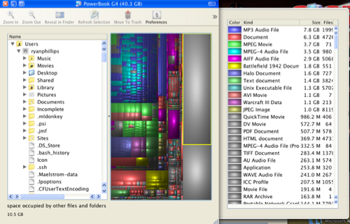

hey, ok i don't know how many of you have used or even heard of this program. its called Disk Inventory X. it catalogues ur hard drive.
anyways theres a big chunk of my hard drive that it says is being occupied by "other files and folders" (see the pic) its the big grey chunk. anyways i'm just wondering what is taking up that space.
i've tried other disk inventory programs such as "whatsize" and they won't tell me either.
i really would like the space.

ok, so i checked everything and added it up. here's what i got
Users: 25.5 GB
Applications: 5.2 GB
Library: 4.4 GB
System: 1.2 GB
Developer: 804 MB
usr: 684.3 MB
private: 671.6
as well as some other things i added up but too lazy to type in, they were all below 200 mb
anyways it added up to 38.9985 GB, but my hard drive is 60!!!!!!
i guess this means that there is something wrong....
any ideas on how to solve this?
haha yea sorry, plus the free disk space (6.6 GB) it comes to a grand total of only 45 GB. that leaves at least 10 GB unanswered for assuming that tiger is taking up about 3 GB

there. thats just for the user though i think. cause i don't have 0B in applications, but all my apps are stored for all users instead of just mine

ok, i think this is what u wanted
why does it say it totals like 87 G???? that doesn't seem right.

Well, ./Volumes just shows the total size of (other?) mounted volumes, so you can pretty much ignore that number. It's pretty clear comparing the list you just gave and your numbers from the Finder earlier that your unaccounted for 10GB is in your /Users -- you said the Finder reported a total of 25.5GB but I see 35GB below.
Since you already did a detailed check on your user folder and came up with about the same 25GB, that would appear to indicate that the unaccounted for space is in another user. This would make sense, as I don't believe doing a "get info" on /Users will include files you don't own, since the Finder doesn't have permissions for the files, but the sudo'd command above will.
Try logging in as any other users on your machine and see what they've got in their Home folders. Don't forget to have a look at the Shared folder and see if something exists in there that you don't have any permissions for.
If you didn't create any files under other users, it's even possible (though unlikely) that somebody gained access to an account remotely and put stuff there.
You can try doing:
cd /Users
sudo du -h -d 1
...which, I believe, should give you the total size of each user's home folder. But perhaps I should defer to yellow on this, as he clearly knows more than I do about the relevant commands.
Did you try running the command that yellow quoted above? That'll tell you exactly how much storage each user has, and should help narrow things down.
crap sorry here it is, it only totals 48 GB

wait....then that means that everything is fine..... + 7 GB free space....crap...rele wish i had a bigger drive then
Yes, as I pointed out before, everything is accounted for by the check you ran there (and before), but you seem to have 10GB of data somewhere in your /Users folder that the Finder isn't reporting; the list below shows 35GB in /Users, where before you said the Finder only reports 25.5GB. I thought that 10GB is what you were trying to identify.
In which case, you actually didn't do quite the right thing here; instead of typing "cd /Users", you either put a space after the slash or forgot to type/copy in "Users", so you just re-did the check on the top level of your hard drive.

Code:
7.7M    ./owner
2.6G    ./Ryan
4.3G    ./Ryan Phillips
2.1G    ./ryan_phillips
 25G    ./ryanphillips
223M    ./Shared
 35G    .
ok, now this is REALLY weird. i only have 2 functional accounts on my computer, one entitled Ryanphillips, and the other is Owner. but in the users folder i found that there were these: Ryan Phillips; ryan_phillips; ryanphillips....why are these here. these are obviously the source of the missing GB. i used to have users named this, but i thought i deleted them. since it looks as though i didn't delete them properly, how can i see what is in them. it says i don't have sufficient privilages. i want to make it an account again just to see if there is anything important in them. is there any way to do this?
