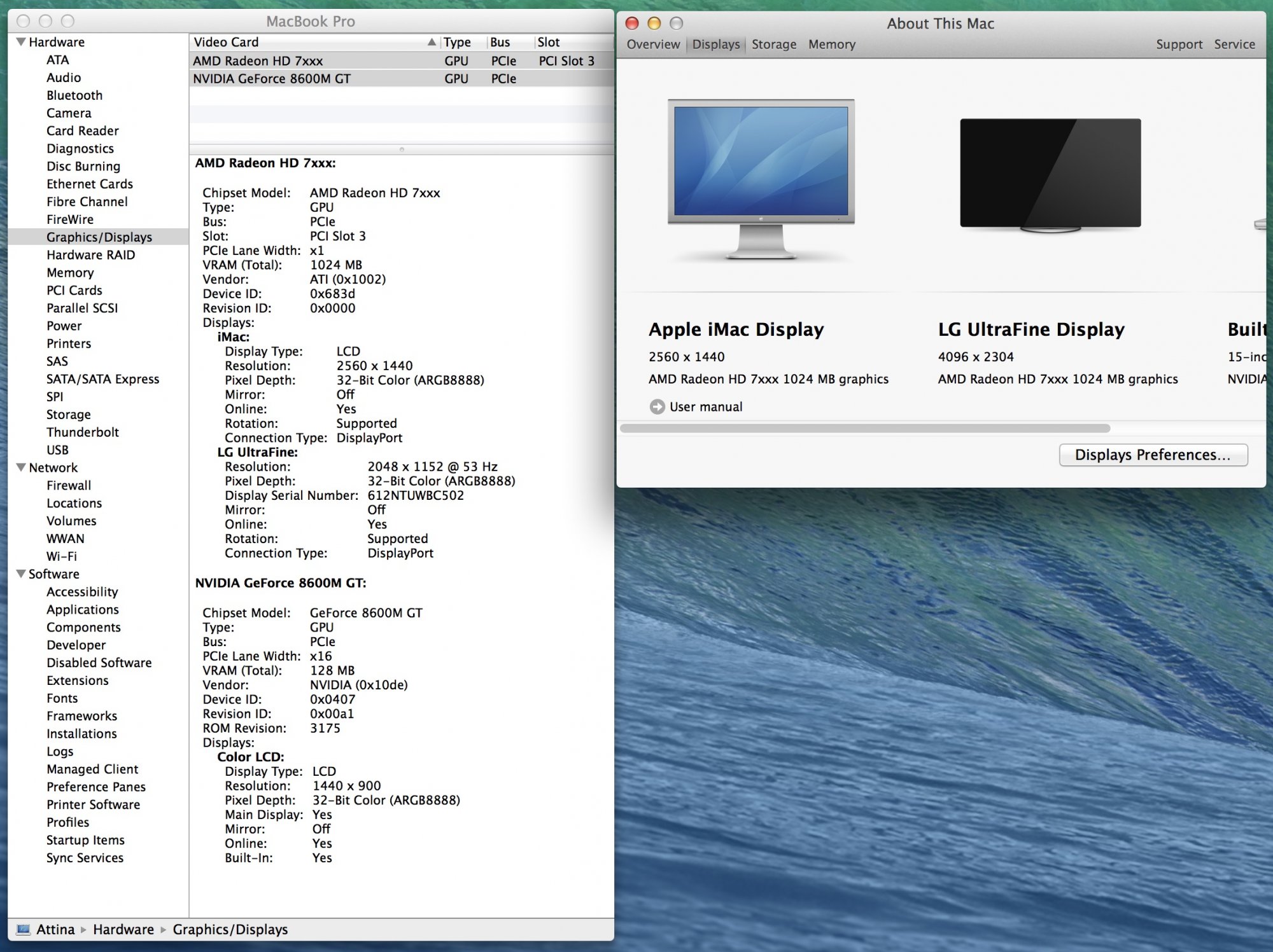

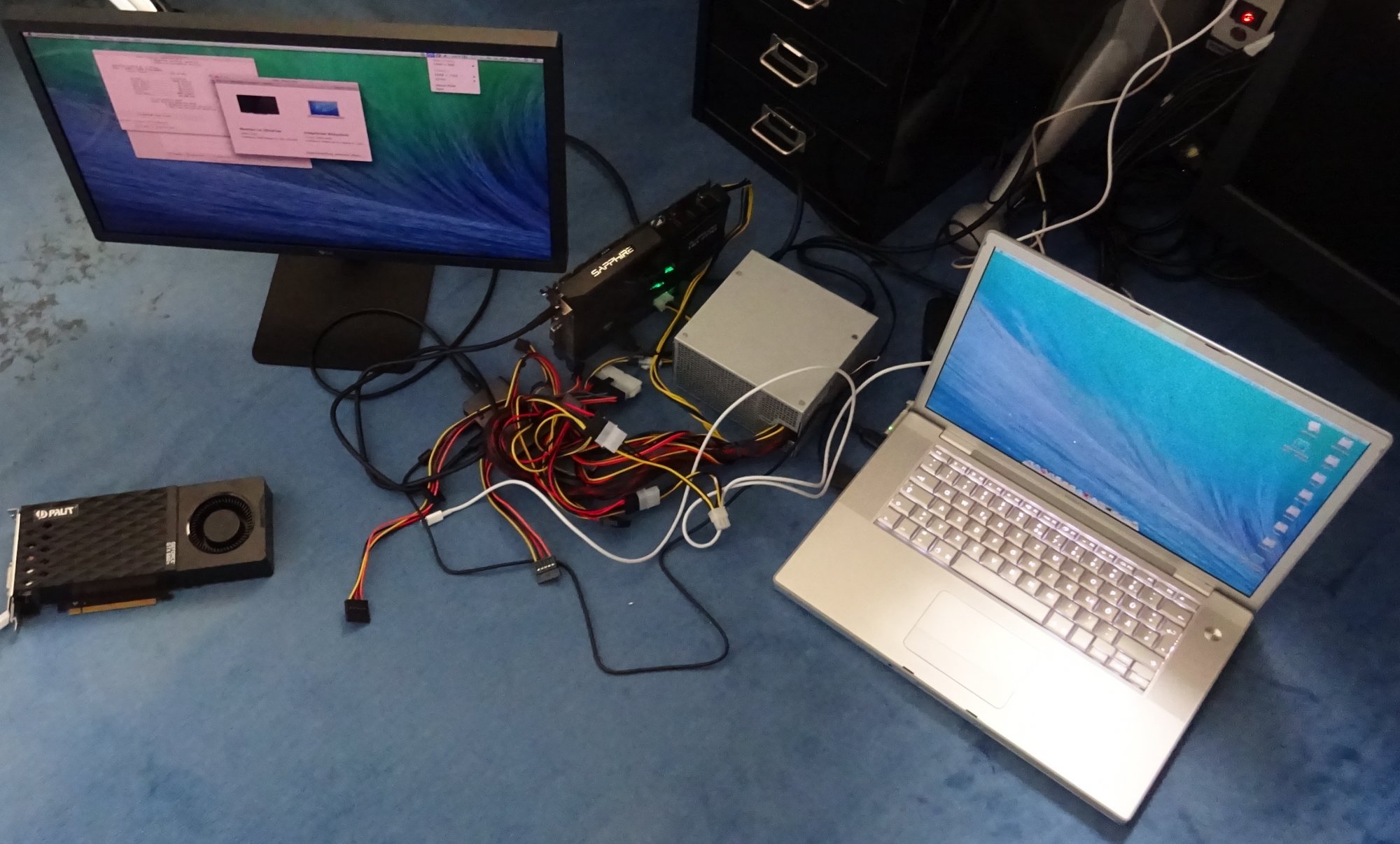

I haven't tried the UltraFine with the 7770 yet
Now I have. 🙂
I had to add the 4096×2304 modes manually since the 7770 isn't fully reading the UltraFine's EDID, missing all the native modes and running the monitor at 3840×2160 instead. I can run 4096×2304 at 53 Hz refresh (higher isn't possible due to the 540 MHz pixel clock limit), which pretty much feels as good as 60 Hz. Annoyingly, the 7770 is said to do 4096×2160 at 60 Hz (by AMD) which requires 567.25 MHz - and Apple confirm this was enabled in 10.10.3 for the trash can Mac Pro sporting same-gen AMD GPUs, suggesting the 540 MHz limit in Mavericks is an artificial one.

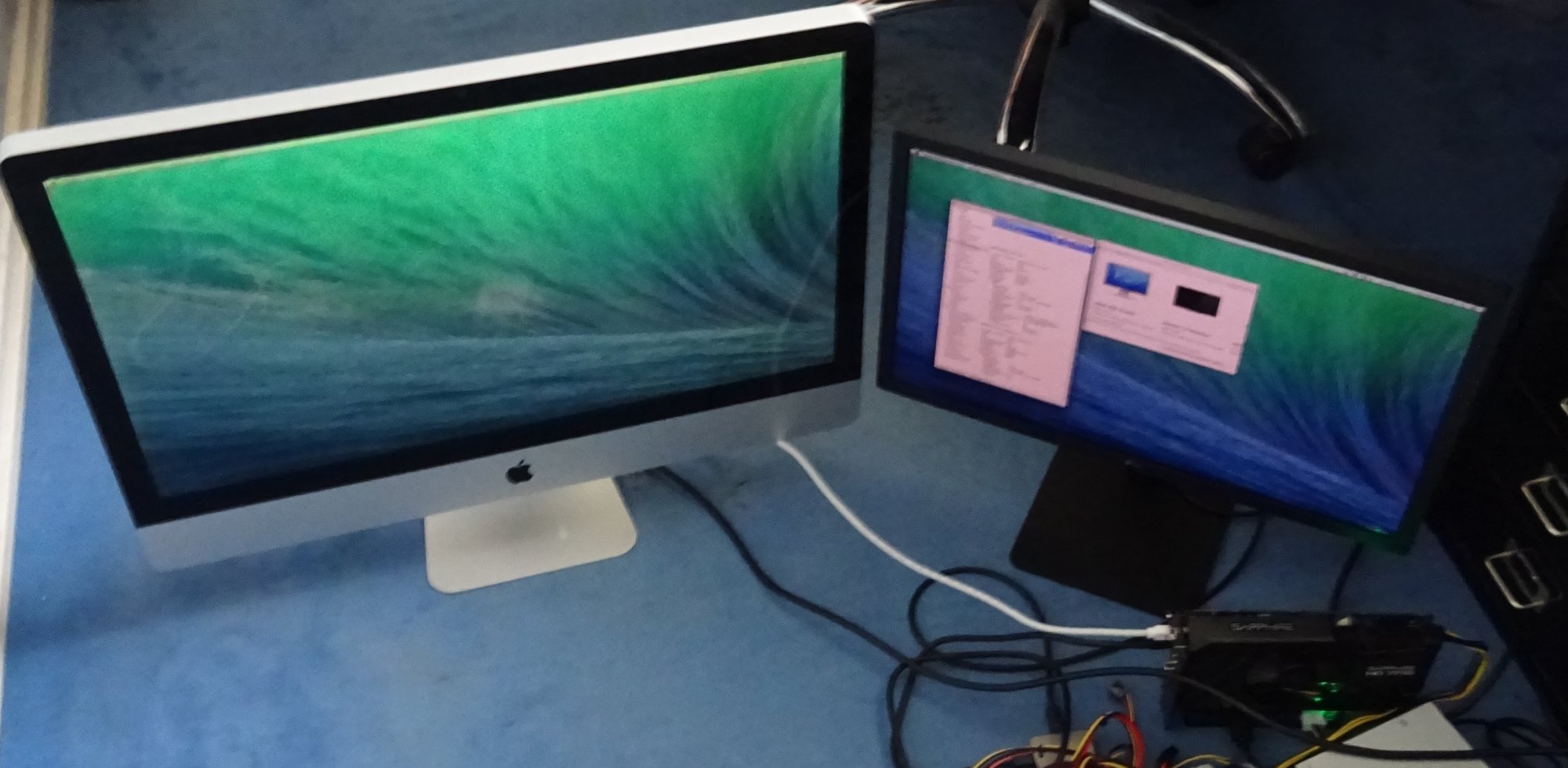

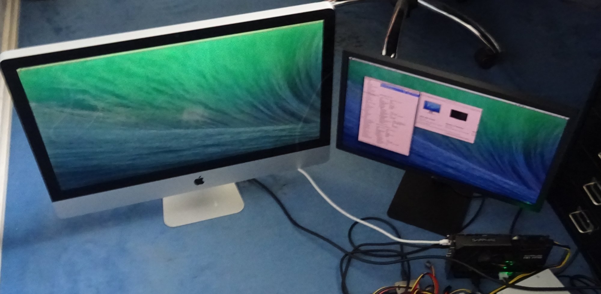

Upped the ante since the 7770 has two Mini-DisplayPorts.
Yep, that's a 2010 27" iMac in Target Display Mode running as a second external display. I gotta say, having a display called "iMac" hooked up to a MBP is rad! 😀

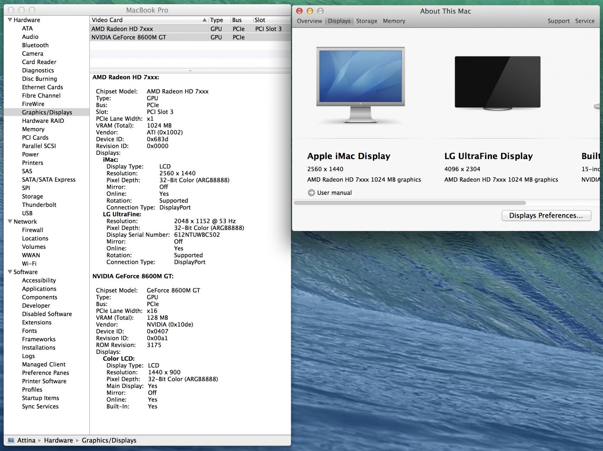

(The UltraFine was running in the 2048×1152 HiDPI mode - that's what's reported by System Information.)
Now I have. 🙂

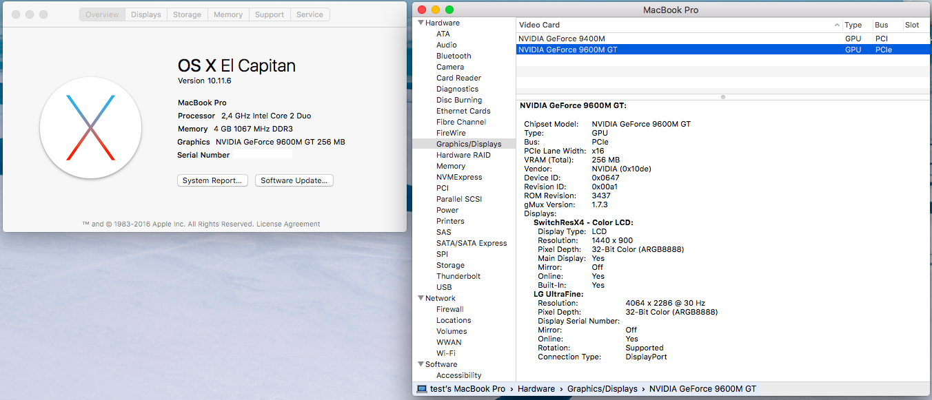

I got my hands on a Late 2008 15" MBP with a wonky display (wrong colours, flashing pixels, weird backlight) for a song. This machine has GeForce 9x00 graphics and a MiniDisplayPort, so I wasted no time and got to work... 🙂
Full 4096×2304 is a no-go, as is 4080×2295 (black screen), so 4064×2286 or 2032×1143 HiDPI is as good as it gets using the discrete GeForce 9600M GT. When I switch to the on-board GeForce 9400M (System Preferences > Energy Saver > Graphics: Better battery life), I'm limited to 3840×2160.

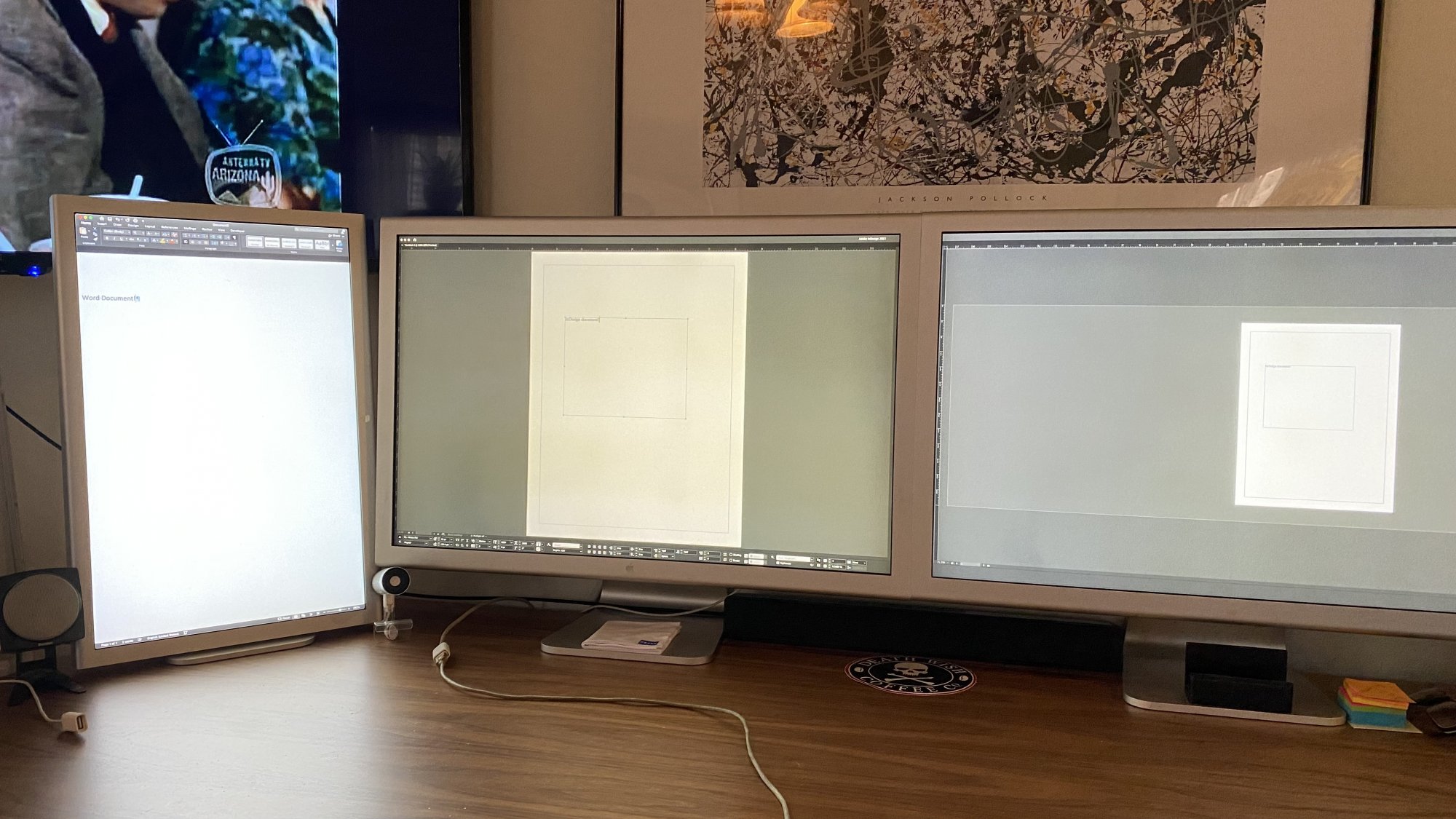

Figured out yesterday that when I span InDesign documents across two screens and THEN go into Split View, the document splits EVENLY, one view to each display!
No more having to open a second view!
Also, it occurred to me today that I can have my Word docs on my 'wing' monitors and because they are more vertical than they are wide it works!

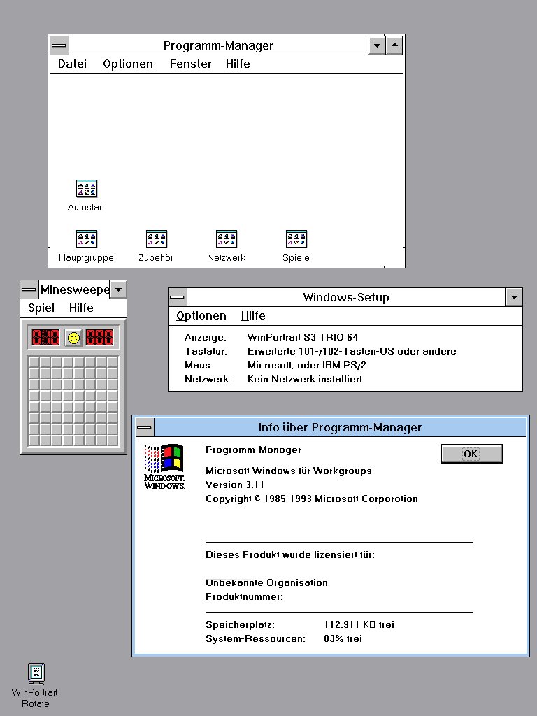

Vertical CRTs are the bomb anyway, they're just so... weird. 😀 Apparently there were some that supported rotation.
(I found a Windows 3.1x video driver that allows rotation on S3 GPUs - and it works in Virtual PC - that was fun LOL)

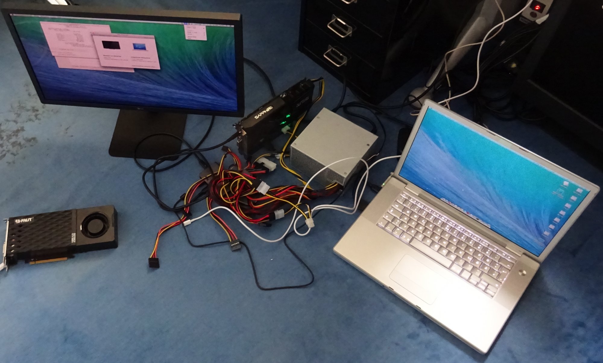

And tested the scaled resolution (framebuffer) limits on a Kepler card (GTX 660 Ti)... Voila, Mavericks at 8192×4096.
An update to that: with a Dell P2415Q hooked up to an NVIDIA NVS 510 (GK107) in Mojave, rotating the display makes all scaled HiDPI resolutions higher than 1080×1920 disappear into thin air. Guess I do need an AMD GPU after all.

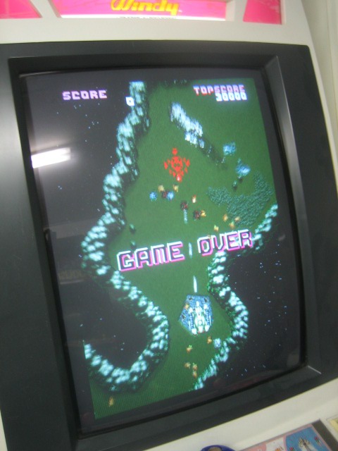

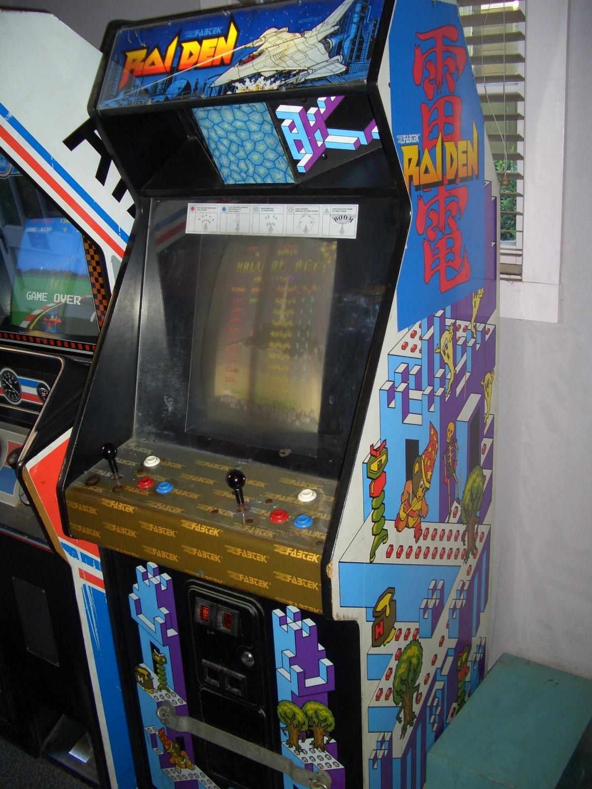

When I started using MAME to enjoy arcade games at home, I remember being confused that a number of titles presented themselves in a strange aspect ratio that didn't fit my 4:3 monitor correctly. I later understood about the usage of vertical monitors, especially after watching the documentary The King of Kong, during which game footage is watched at a venue using a CRT TV turned on its side.
Nowadays, instead of requiring a vertical CRT, you could simply rotate a 16:9 flat panel monitor/TV if you want to enjoy the likes of Donkey Kong or Raiden as they were meant to be played and I have a 22" LED that I might use for that purpose once I've badgered a friend into building a custom swivel stand for me . 🙂

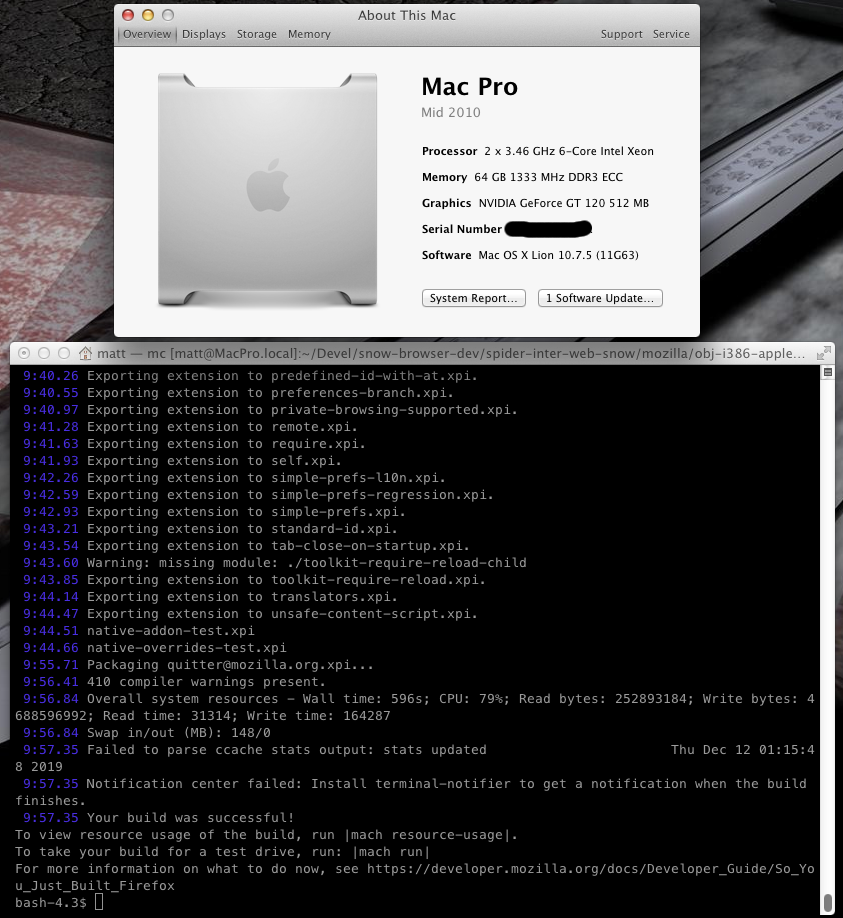

So... It may or may fit this thread, but a very gracious Discord member sent me a 2010 macpro for the cost of shipping (which wasn't cheap, and i added an extra $70 to that because it's a nice machine). Well holy hell is this thing fast. My core 2 duos i was using to build interweb/spiderweb/arcticfox etc usually took 1.5 to 2.5 hours per browser build. This machine just built InterWeb in less than 10 minutes!!!! This will make trouble shooting failed backports much quicker to track down and rebuild. I'm stoked.
Oh, and here's an updated InterWeb (60.9.4) and SpiderWeb (2.2.3) made possible by this machine. 😀
