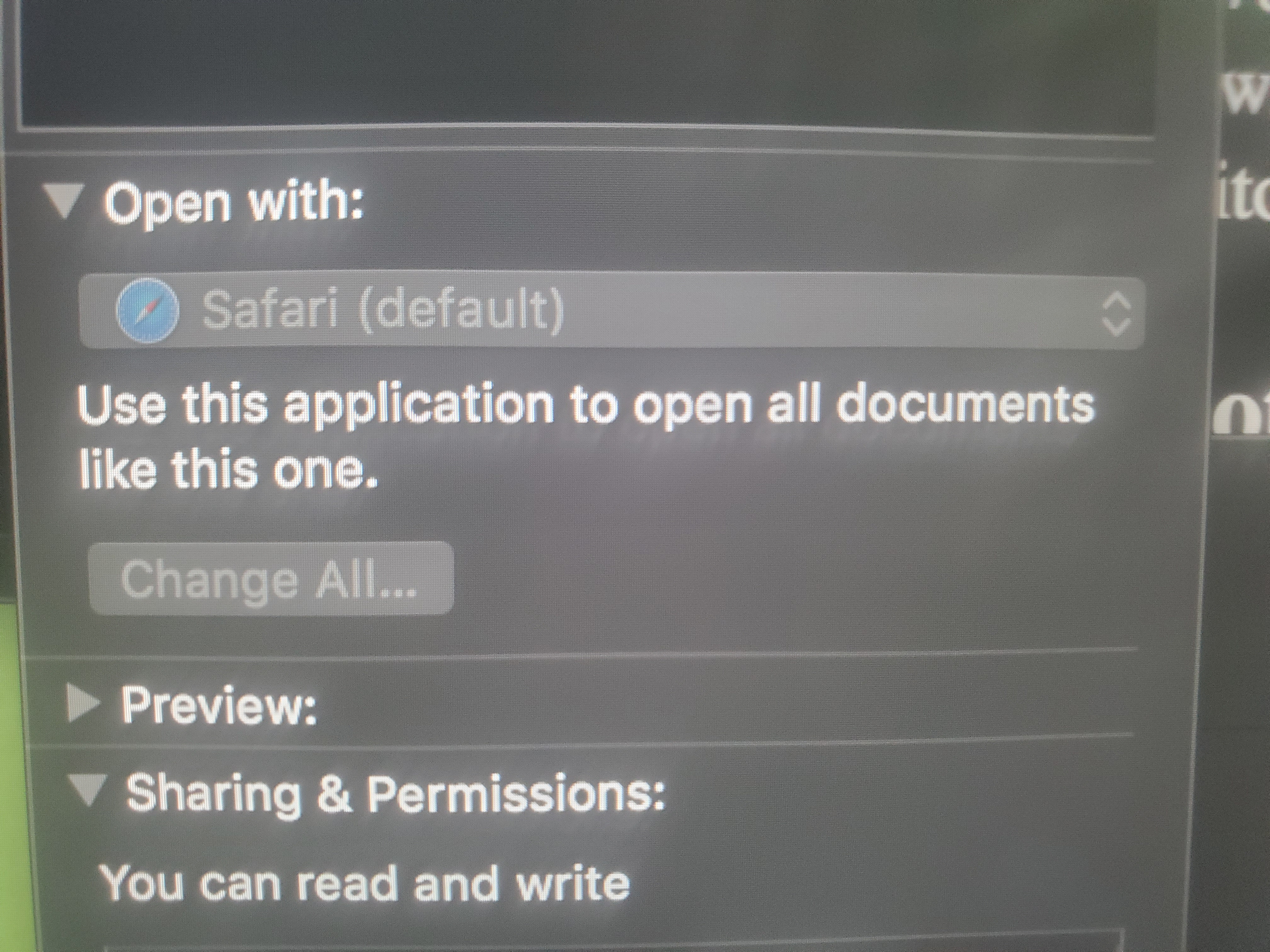

Here's something maybe you can help with:
I don't know long this has been going on, but Apple has hard-locked Safari* to be the default for opening webfiles, and grayed-out the relevant setting.
I'd like to assume this is something that can be disabled in Terminal.
(*How awful is Safari? Go trying installing uBlockOrigin in it. You'll be shunted to the weak-sauce 'Lite' version, via the AppStore, then told you can only apply it to Ventura and above.)

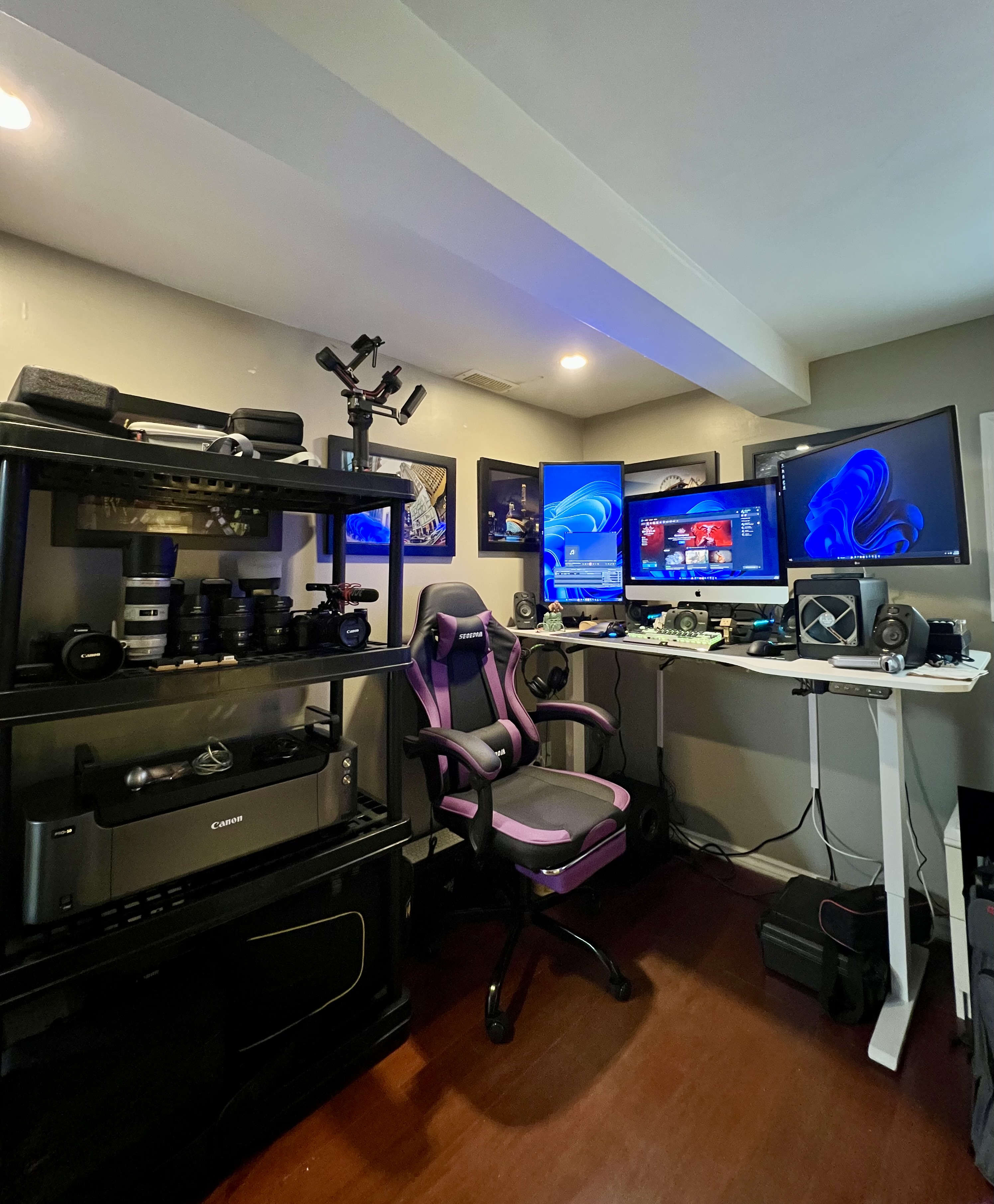

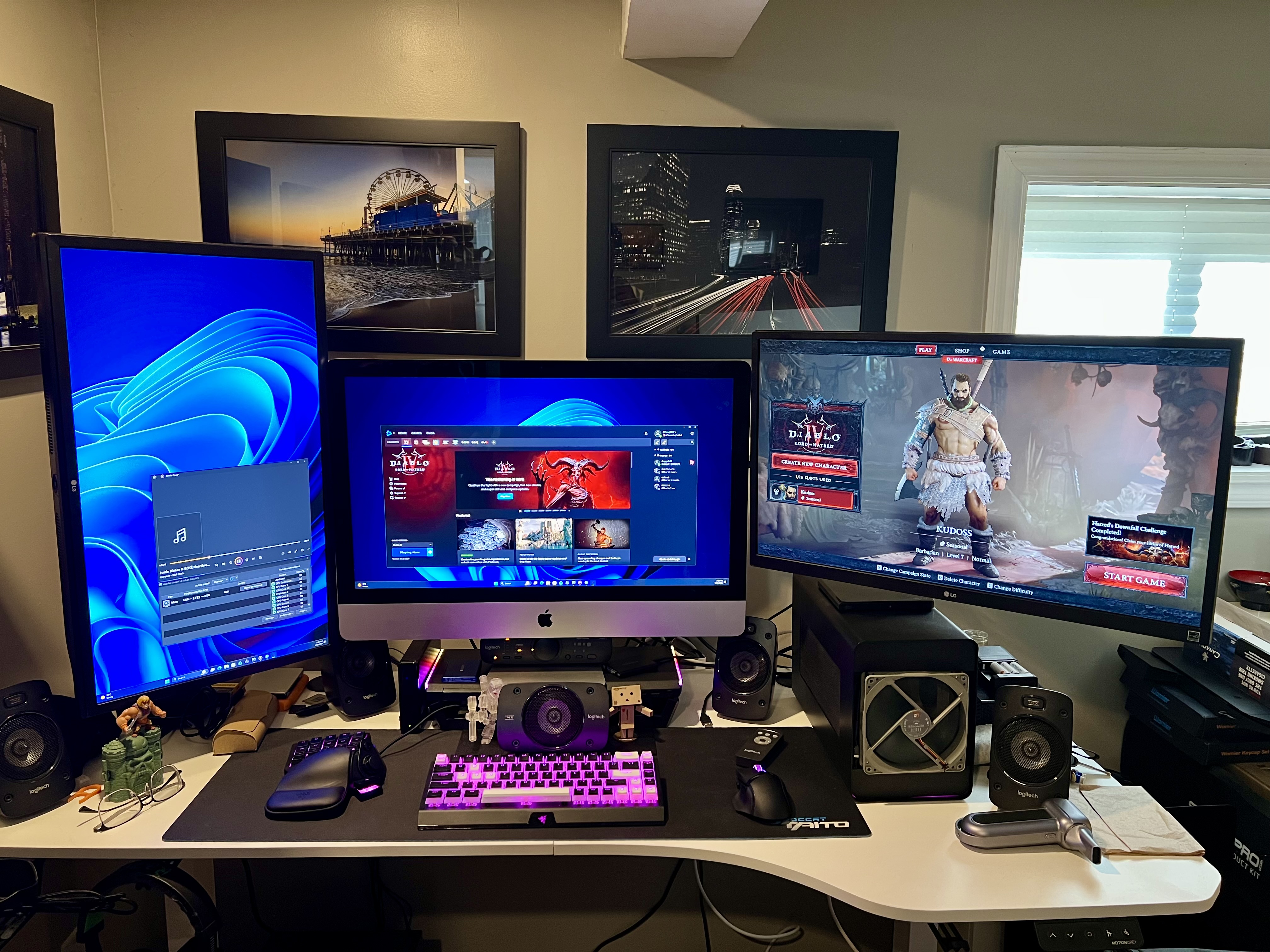

I added a Razer Core X Chroma RX 6900XT reference card to my top spec 2020 5k iMac. I modified the eGPU with two Noctua premium fans for better cooling and use it for Video editing in Mac OS and bootcamp Windows gaming. In Mac OS gaming the EGPU gets loud playing long sessions in 4k. However in Windows gaming it stays silent in 4k with significantly better FPS.
As cool as that is, I doubt it qualifies as “Early Intel”. 😂
No worries and thanks for sharing - it's a fantastic iMac setup, that's for sure. My Late-2013 27" recently bit the dust - the power supply failed and I very nearly replaced it with a 2019 iMac 27" I saw a deal on. I sprung for the higher end 24" M4 in the end. The smaller screen is taking some adjustment to get used to, but the Retina is gorgeous. I still have my 2011 17" MBP and 2015 13" MBA for Intel stuff too. 😀
Reactions: Andy5Kimac

Sorry, I actually have no idea! I either never saw or noticed this back when I used Mojave (I never used Catalina, that was when I nope'd out).
I don't remember this being in Mojave before, but it's possible one of the last "updates" smuggled it in, and it cheeses me off to no end. (I like to leave helpful vid links on the desktop of refurb computers I'm passing along, and want them to bring up a browser with proper adblocking already installed.)
