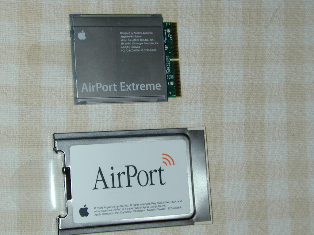

I found out my PowerBook G4 has a Airport Extreme card, what can I use this for?
Im new to macs , sorry for my lack of knowledge.🙁
AirPort Extreme is the name of the Apple wifi cards from Wireless G and up. In PowerPC macs they are a customized version of the PCI interface. All macs that use DDR RAM have AirPort Extreme cards. original AP cards are just called AirPort. They are Wireless B and are a modified version of a PCMCIA/CardBus card.
Atatched is photo of Airport and Airport Extreme card from mac forums.

That's because you have a FW800 MDD.
The original MDD and MDD2003 use Airport cards-I have a closet full of these computers, and can say with 100% confidence that they require an Airport card.
