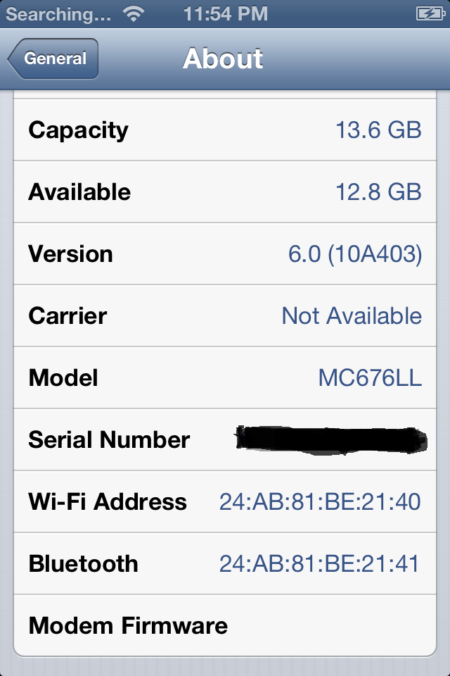

Screen Shot

that works but still doesn't fix my situation. a few ppl said the antenna cable could have come unplugged that's whats giving me these problems and it could probably explain why it always says searching.
