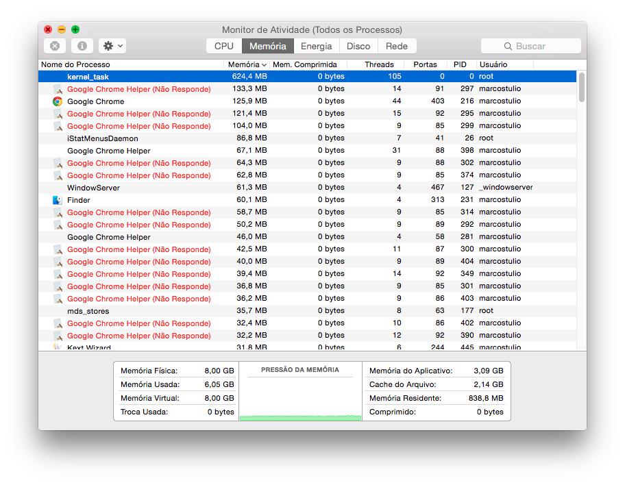

I do not know if it's because I installed Yosemite (Beta 6) but I have noticed that such a kernel_task appeared in Activity Monitor and memory intensive. Has come up to 4GB.
I found several tutorials on how to finish him Internet. One of them is to find the model of the Macbook Pro in IOPlataformPluginFamily.kext, but have not found my model in the list.
Does anyone know what could it be? 🙁
:apple: Bonus: If anyone knows why Google Chrome Helper does not respond, I also thank you 😀
kernel_task is the main process of your computer. Think of it as the president of your computer's thoughts. It can't be killed without crashing your computer. It uses memory because that is where Mac OS X stores its disk cache. It is nothing to worry about and as long as the memory pressure is not red, you're good.

kernel task is part of OS X. It is normal for it to use system resources, and many of its functions are directly related to apps you have running. Your issue is with Google Chrome. Either you have a corrupt installation or perhaps a plug-in or extension is not working properly.
I think my solution is to install more memory on my Macbook.
I have 8GB installed. Perhaps he will be happy to 16GB and I also 😀
More memory isn't the solution and won't do anything. Your memory pressure is still in the green. You'd only need more memory if it goes red often. 8GB is very adequate for general computing and most other semi-heavy tasks.

You are only using 6GB, you don't need further RAM.
Buy some by all means but you don't need any more.
Mavericks (and probably Yosemite), have good RAM compression so you can have up to 14GB or so in 8GB physical (from my experience anyway).
The solution isn't more memory, it's to completely delete Chrome and reinstall it.
