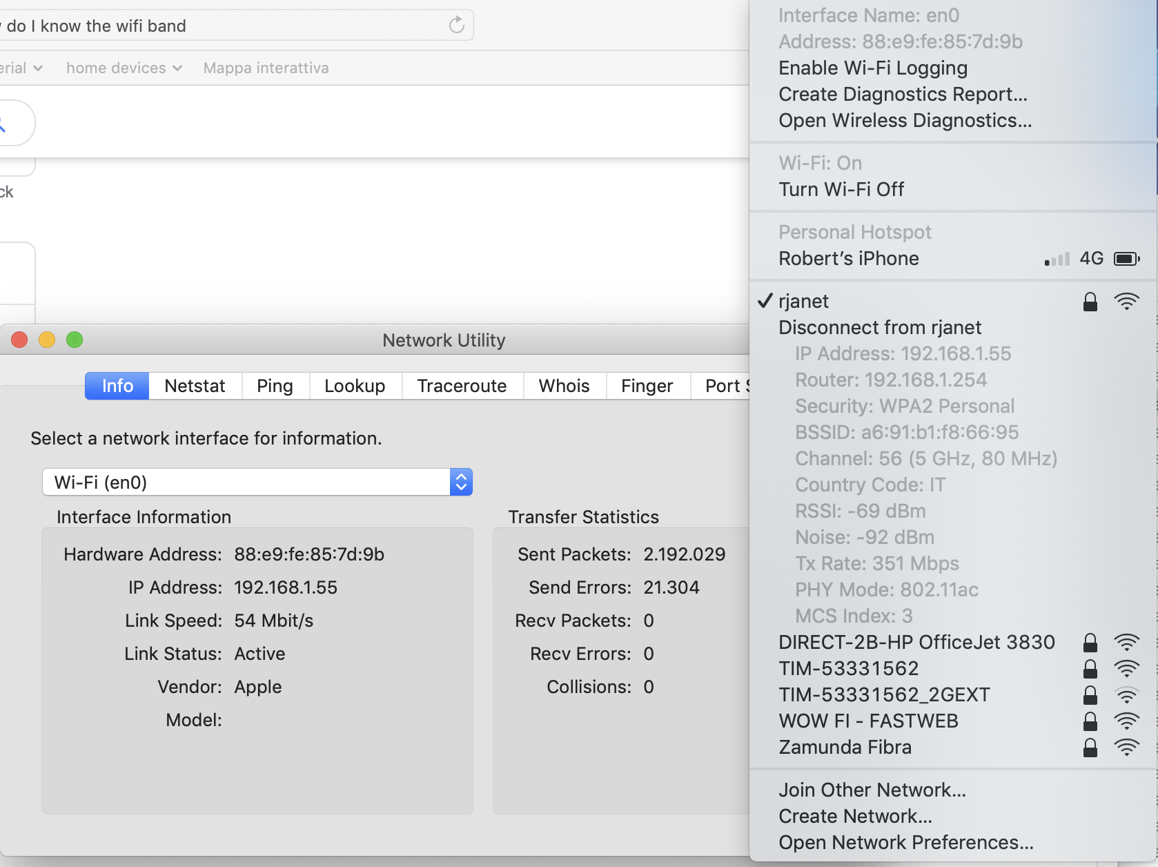

Dear friends,
I am posting the screenshot of two conflicting measure of the WiFi speed from my MacBook Pro (15" 2018 10.14.6) and my home WiFi router.
As you can see the Network Utility gives 54 Mbits/s while by Opt-Clicking the WiFi icon on the taskbar I read the speed as 351 Mbps (same unit as before I guess).
Why the difference?
Which is a better approximation of the real speed? Thank you very much.

I’d check if your router is supporting ac. 54Mbps looks to be the 802.11g rate.
If either the wireless router or the wireless client can support only 11a or 11g, the link rate would be a maximum of 54 Mbps, and the actual data transfer speed would be about 22 Mbps.​
I’m not an expert, but I think this can also happen if you have an older device on a newer network because the network can‘t use all of the capabilities of the newer standard while staying backwards compatible. I think this is why you sometimes find routers with two radios at the same frequency— more advanced routers will try to cluster faster devices to one radio and slower ones to the other.
But as you can see from the screenshot in the OP the link is 802.11ac (which seems supported by my router specs and also by my Mac Pro 2018 chipset). Is there something I'm misunderstanding?

I don't believe that is what is going on if you look at his screenshots. Mine is similar. He is connected on 5GHz 802.11ac.
If you read the article I linked, what OP is seeing is normal.
I did read (and quote from) your article. The article compares the reported PHY speed with the measured file transfer rate as reported by the file transfer dialog. That isn’t what OP is doing. OP is looking at two different system reports on the network configuration.
Network Utility doesn’t make an effort to measure throughput. And being exactly 54Mbps, which corresponds to the theoretical performance of one particular standard, seems too unlikely to be a coincidence.
Looking at this again, I think Option-clicking the WiFi menu bar item reports the capability of the network you are attached to (it is the specs for rjanet) and Network Utility reports the capability for your local interface (the en0 interface).
When I look at the Network Utility report for my 2013 MBP, the Ethernet adapter interface reports 1Gbit/s, which is almost certainly not what I’m getting through the link, it’s the PHY rate. When I look at my WiFi adapter, it shows 217Mbit/s— but more interestingly both interfaces report a value for “Model:”.
I don’t see a Model reported for the OP‘s interface. I wonder if that can be a sign of a problem with the hardware— or maybe it’s connected through a different adapter?
Also note: OP‘s Network Utility report shows many send errors and no received packets. Something here ain’t right... @rjalex, if you’re getting packets you must be getting them through a different interface?
You don’t know the quick way of holding the Option Key While mouse clicking the WI-Fi Finder Menu icon and it will show you your connection type, channel and speed!
There's something wrong with the network utility.
Both should be showing my connection speed (shown correctly on the right at 878Mb/s).
Throughput is totally different but both of these metrics are showing connection speed, neither show throughput.

So let me wrap up the data (the router has both 2,4 and 5 GHz network with same SSID):
HWWiFi system reportMacOS levelAltWifi Link Tx rateNew.Util link speedWiFi conn
MacBook Pro 2018802.11 a/b/g/n/ac10.14.61053 Mbps54 Mbit/sCh 56 ac
MacBook Air early 2015802.11 a/b/g/n/ac10.14867 Mbps144 Mbit/sCh 56 ac
iMac 27 late 2009802.11 a/b/g/n10.12.6300 Mbps300 Mbit/sCh 56 n

I'm kinda stumped. Like @Howard2k, my MP 2013 is showing 11Mbps (which I think is 802.11b speeds) even though my router says I'm attached to the 5GHz network. I could accept it if they gave different results, but on the face of it, the 11Mbps looks wrong. I'm kind of out of my depth at this point.
Again... you are comparing the physical link rate to the transmission rate, and that is not the same thing. My 2018 MBP shows the same thing. If you search the forums you will see new iMac Pro owners reporting the same thing. There is nothing wrong with your MBP.
No that's not correct. Both of these are supposed to be showing the connection speed, not the throughput.
You're correct that throughput and link rate are not the same, but the Network Utility isn't showing the throughput (nor is it supposed to).
Here's a post from two years ago showing the same issue. It's been around for years but somehow hasn't been fixed.
You can get a feel for the throughput using Activity Monitor Data sent/sec and Data received/sec counters, but that's also not very accurate either. In fact it's really very poor. It's at least indicative though, it's based on reality. The Link Speed in Network Utility is not.

On this we agree. My point is there is nothing wrong with OP's MBP.
Agreed. Apart from software bugs in Network Utility. 😛 🙂
The OPs question wasn't asking if there was a problem with their MBP. The question was "which of these measurements is a better approximation of the real speed?". I don't think we've had an answer for that other than "neither". The numbers quoted are theoretical, and one of them appears flat out wrong, but the actual throughput depends on many things.
As far as whether anything is wrong with OPs MBP, I'm not sure we have an answer for that either. Network Utility seems to have a history of reporting incorrect link speeds, but I'm not seeing anything that says it has a history of not recognizing the model, incorrectly reporting send errors, or reporting zero receive packets when the network appears to be working otherwise. Could be a harmless bug, could be a problem-- not sure how to judge that based on the information we have.
I'm not sure I'd use the term "theoretical". They're supposed to be measurements of bandwidth. Optional clicking the wifi icon is correct, using Network Utility is not correct. That's a real thing all the same (bandwidth). It's further protocol complications that ensure that bandwidth and throughput are materially different (in this case (with wifi) especially). Both are real, both are different measurements.
I'm with you though - as you suggested earlier, if there are packets going one way but not the other we may have asymmetrical routing. That's not what I'm seeing at all, even though I do see the link speed silliness. If someone who had the same model as the OP could comment with relevant screen shots that would be a good guide.
